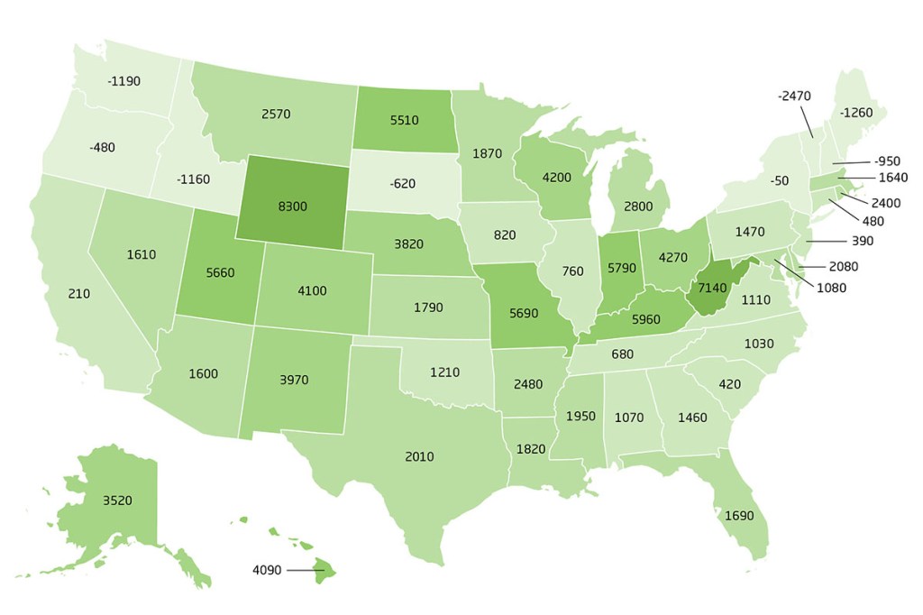

A builder in Connecticut who installs a condensing propane tankless water heater instead of an electric storage tank unit can save the equivalent of 480 pounds of carbon dioxide (CO2) per year. That’s the same as taking about 540 miles from an average gasoline-powered car off the road.
A builder in Missouri who makes the same switch, however, has an impact nearly 12 times greater, saving 5,690 pounds of CO2 or 6,408 miles on the road.
The two scenarios illustrate the impact of the local electrical grid on efforts to reduce the CO2 emissions of our homes. Although more renewables are brought online each year, most of our electricity is still generated by power plants burning natural gas or coal. And when you factor in efficiency losses at the power plant or during transmission, an on-site fuel source like propane can have a significant positive impact on a home’s carbon footprint.
In the map below, we’ve calculated the impact on CO2e (the amount of greenhouse gases that have an impact equivalent to CO2) of switching from an electric storage tank water heater to a propane condensing tankless water heater in each state.
Check out the interactive tool on propane.com
CO2e savings (in pounds) with propane tankless water heating
How it’s calculated
The carbon emissions savings for each state are calculated using the Energy Planning Analysis Tool (EPAT), an online calculator developed by the Gas Technology Institute (GTI). The tool allows builders and analysts to customize a range of variables about their project to understand the cost and emissions impact of different choices for energy source, mechanical equipment, and appliances. Learn more about the tool’s background in “Calculate your gas vs. electric savings.”
