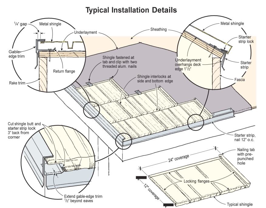

Fastening methods vary from manufacturer to manufacturer, as well as among different product lines from the same manufacturer.
Starter strips and nailing clips. In the case of Classic's rustic shingles, for example, the hooked butt of the first course of shingles engages a slot in a combination of starter strip and drip-edge at the eaves.
The first course of shingles is hooked against a combination of starter strip and drip-edge nailed to the deck.
The shingle is pulled upward into position and secured with two threaded aluminum nails. Neither penetrates the roofing itself: One passes through a prepunched hole at the top right-hand corner, and the second is driven through a prepunched hole in a metal nailing clip that engages a flange at the shingle's upper edge.
The butt of each shingle above the eaves is hooked over the top flange of the shingle below; a similar side flange engages the previous shingle in the same course. Shingles are ordinarily laid from the lower left of the roof to the upper right.
Classic's lower-profile Oxford shingles are hooked to the starter strip in about the same way but have no integral nailing tab at the top edge. They're secured to the deck with five nailing clips per shingle.
With both styles, additional locking flanges secure the edges of the shingles where they meet. Above the eaves starter strip, the butt of each shingle engages the upper edge of the course below. There are no exposed fasteners, and thanks to the mechanically interlocking shingle edges, the resulting roof is capable of withstanding 110-mph winds.
