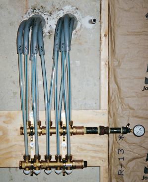

Since snowmelt applications typically require long runs, 3/4-inch or 1-inch pipe is often used (compared with the 1/2- or 5/8-inch sizes used most frequently for interior jobs). The ends of the piping are connected to a supply and return manifold, which connects to a boiler inside the home. Usually, the snowmelt system requires a separate, dedicated boiler to meet the large load required for snowmelting. Depending on size, a typical driveway may require 120,000 Btu/hr. or more — as large or larger than the home's heating load in some cases. To try to satisfy this heating load with the home's boiler would mean the boiler would be oversized most of the time, since snowmelt loads are of short duration.
Other system components may include mixing valves, heat exchangers, tempering tanks, circulating pumps, and controls.

Preparatory garage plumbing. The snowmelt piping hooks up to a manifold, which is usually located in the garage. Typically, the PEX piping is routed through a protective sleeve of 2- or 3-inch PVC conduit, which is embedded in the garage floor slab just like electrical conduit would be. We run this sleeve before the paving contractor puts the crushed stone base in for the slab. The garage slab can then be poured and finished normally.

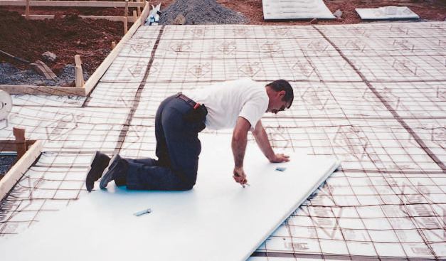

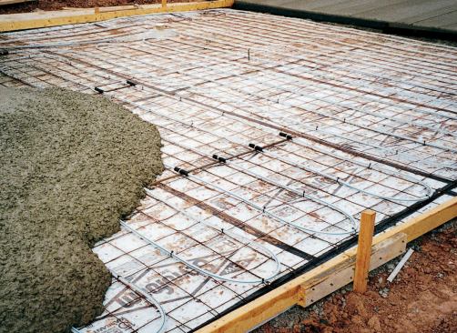

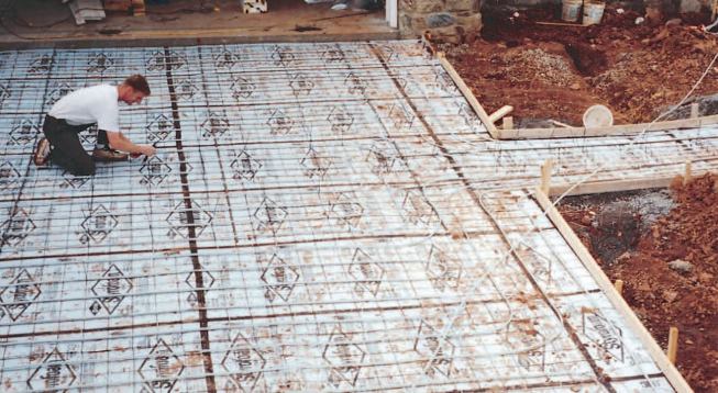

Day 1, Afternoon. Laborers lay down high-compression-strength extruded polystyrene (XPS) insulation over the stone base. On top of that, they lay flat sheets of 10-gauge welded wire mesh, which creates a 6-inch grid for strapping the tubing in place.

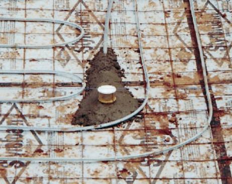

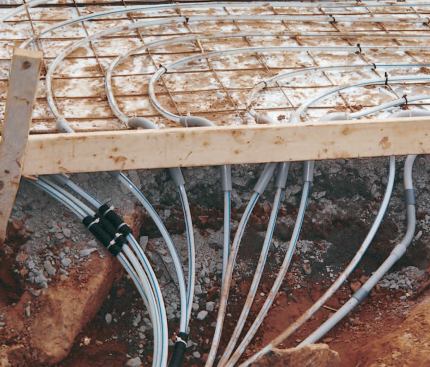

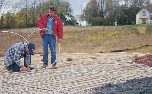

Day 2, Morning. Heating crew uncoils the PEX tubing and attaches it to the wire mesh grid, using plastic cable ties. It's important to be on the lookout for sharp points and rough edges in the wire: These should be avoided or knocked flat.
At this point, the GC and heating contractor should plan for embedded slab control joints: To avoid damage to the tubing, no control joints should be cut into the slab. The heating contractor will run a plastic sleeve around the piping at the control joint (we use closedcell- foam pipe insulation) to allow for slab expansion and contraction without stressing the piping.
After the tubing is installed, the pipe should be air-pressure-tested to 30 psi to ensure there are no leaks. Since the piping is exposed at this point, take care to avoid any driving, staking, shoveling, or raking in the area. Also, keep cigarette butts and matches away — though it's unlikely, they could melt a pinhole in the PEX.

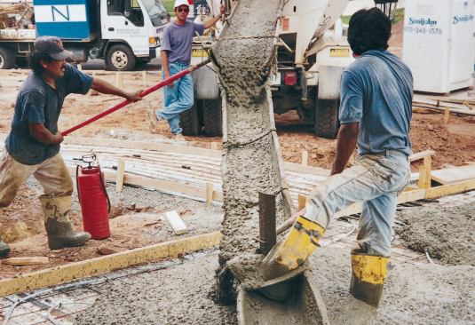

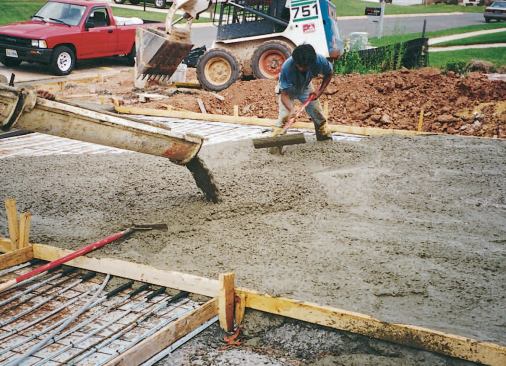

Day 2, Afternoon. The paving contractor pours the concrete, usually 4 to 5 inches thick, measured from the wire mesh. The heating contractor should be on hand to provide technical help during this crucial phase.
The wire mesh should not be hooked and pulled up into the concrete — though this is sometimes recommended in interior radiant slab installations. The mesh is there simply to hold the tubing in place; it provides no structural support. If wire mesh reinforcement is required for the structural strength of the concrete, then a second layer of wire mesh can be laid on top of the installed heating pipe.
To protect the tubing, the workers should avoid using rakes, shovels, or hoes to move the concrete. Instead, tampers should be used. Throughout the process, the heating contractor should stand by to monitor the workers and make sure the air pressure in the tubing is constant. In the rare event of a leak, the heating contractor can halt the pour and splice in a repair coupling or replacement pipe.

After grading the driveway and covering it with crushed stone, the workers lay down a layer of 1/2-inch high-compression XPS insulation and the 10- gauge wire mesh. (While 1-inch insulation works fine with concrete, asphalt is a softer, more flexible surface. It's typical for asphalt to form "valleys," or tire depressions, over time. By using 1/2-inch XPS, you limit the depth of these valleys in case the insulation compresses.)
After the insulation is laid, the heating crew lays out the tubing, attaching it to the wire mesh.

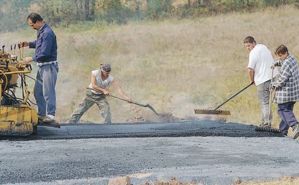

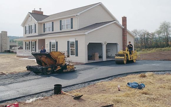

Next, the paving contractor applies finely crushed stone dust on top of the piping. The best method is to dump the stone dust in piles, then use a small skid steer with a flat bucket angle to push the dust ahead and work it down around the piping. Spraying the dust with water helps with compaction.
The paving contractor then applies a 3-inch topcoat of asphalt using the normal application equipment. The 3-inch base of stone dust surrounds and protects the tubing, so shovels and even a full-sized roller can be used without fear of dings or compression. Throughout the process, the heating contractor should be present to watch the workers and monitor the pressure in the tubing.
The stone dust also protects the tubing against the heat of the asphalt. PEX can withstand hot water temperatures up to 200°F, which is higher than the temperature of the asphalt as it's actually applied. However, it never hurts to play it safe by choosing a cool day for installation. On a recent installation, fellow contractor Jeri Donadee even ran cold water through the tubing while the asphalt was going down. He reports that the temperature of the water rose only 1°F, which he credits mainly to the insulating value of the stone dust.
