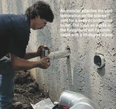

Try breathing through a soda straw. It takes effort, and you'll probably get dizzy soon. A fuel-burning boiler, furnace, or water heater can also end up gasping for air when installed in a very tight house or a confined space. The appliance won't get dizzy, but it can't burn its fuel properly -- resulting in reduced efficiency, and possibly exposing occupants to harmful gases such as carbon monoxide. A fuel-burning appliance needs a lot of air to burn properly. For example, a 100,000 Btu/h boiler or furnace needs 1,250 cubic feet of air per hour for proper combustion. With the exception of vent-free gas fireplaces and kitchen ranges, all gas- and oil-fired appliances are vented, using either fan-assisted venting or traditional atmospheric venting via a chimney.
Thanks to the natural buoyancy of hot flue gas -- which rises rapidly up the vent pipe, just as a hot air balloon rises in the open air -- vent pipes and chimneys suck flue gas out of appliances and suck in additional air to replace it. Here's the rub: You must replace the same amount of air that rises up the vent, and the makeup air must flow to the burner as easily as the flue gas was vented.

Lack of makeup air.
If the house is extremely tight, the heating appliance may be unable to suck in enough makeup air to allow complete combustion.
Figure 1.Avoid long horizontal runs of vent pipe, which can cool the flue gas and reduce the draft. This gas-fired water heater should have been located closer to the chimney.
