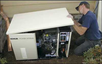

A professional contractor who specializes in generators must be part motorhead, part sparky, in order to best install and maintain the equipment. Here, contractor Jay Hart of Hart Power Solutions (www.hpsobx.com) in Kill Devil Hills, N.C., performs routine motor maintenance on a generator set at a new home built by Kitty Hawk, N.C. builder Stormont & Co. (www.stormontandcompany.com).
