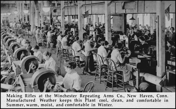

While the business took off, the Buffalo Forge Co. backed off from it when the country entered World War I. As labor and material grew scarce, the company scaled back to its original lines. Carrier and Lyle weren’t ready to abandon the project, and with five other engineers, founded the Carrier Engineering Corp. in 1915. Two years later, the nascent company’s biggest customers were munitions makers who clambered for technology to control indoor humidity, which helped reduce static charges that could touch off explosions around flash powder. Fuses and some explosive compounds in bomb manufacturing could not be produced in unstable indoor environments. As the war progressed, air conditioning in textile plants and candy factories also proved lucrative. After the war, food processing plants became the next big market for “manufactured weather.”
Mech “authored” his own book (“The Story of Manufactured Weather”) in 1919, featuring testimonials from satisfied customers (photo excerpt depicting “comfortable” workers manufacturing firearms during World War I).

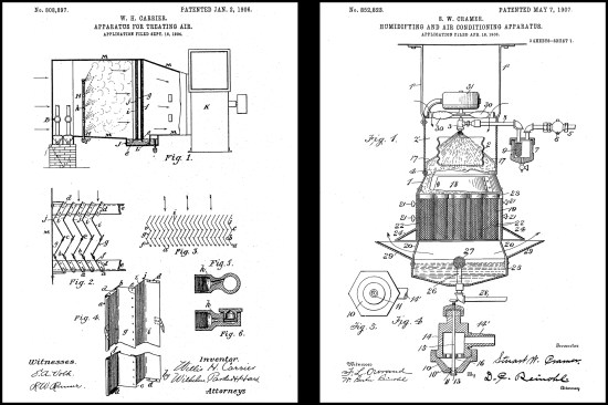

Curiously, the term “air conditioning” was not Carrier’s. Carrier filed his first patent as “An Apparatus for Treating Air.” “Air conditioning” was a phrase used on a different 1906 patent, filed by Stuart Cramer, a textile engineer, for a device specifically designed to condition yarn.
Click for larger version
Carrier’s “Apparatus for Treating Air” patent submission for his industrial “air washer” (photo left). Cramer’s “Humidifying and Air Conditioning Apparatus” was a major contribution to the textile industry (photo right). Spinning efficiency of cotton was greatly improved via his invention’s use of a water-spray humidifier to control relative humidity levels, reducing yarn breakage and improving worker comfort levels.
