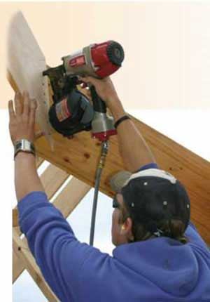

Empty, a coil gun weighs about the same as a stick gun. But load them both with 10d fasteners, and the coil gun is suddenly 2 1/2 pounds heavier. For some carpenters, this will be a problem. I understand, because in general I too prefer lighter tools. But when it comes to framing guns, I'm willing to carry more weight if it means being able to work longer without having to reload.
A coil gun is more comfortable to use if it's balanced front to back. Some of the coil guns are very well-balanced, but others feel nose-heavy. This was not an issue when we nailed subfloor, but it was when we held the guns in other framing positions. If we had had only a single coil nailer, we might not have noticed, but with seven models to choose from, it became obvious which were the most comfortable to use.
Although balance isn't much of an issue when you're nailing straight down, it's an important consideration in all other framing positions. Max's gun is comfortable to use at any angle, but some of the guns are nose-heavy.
The Hitachi is better-balanced than the other tools, and so it feels lighter than the specs say it is. The Makita, Max, and Senco are also well-balanced and comfortable to handle — especially the Makita. The Bostitch, Paslode, and Porter-Cable all feel nose-heavy; using a nose-heavy gun gives you a sore wrist.

All of these tools have the power to put 10d nails into the hardest material we ever use — LVL beams. The catch is in how fast they can do it. When I say a gun is fast, I mean it can drive fasteners in rapid succession without leaving any heads standing proud. Manufacturers sometimes include a spec for how fast their guns can cycle. For example, Paslode says its gun will cycle 10 times per second — which is faster than any carpenter could or would want to drive fasteners.
I can't vouch for the specs, but in use the Hitachi and Paslode cycle faster than other models. The Max feels a little slower than the rest. The only time we noticed this was when we nailed LVLs or fastened top plates, a task that involves driving a lot of framing nails in rapid succession. If we slowed down just a little, the problem went away.
As for power, the Makita and Bostitch feel more powerful than other models, but not to the extent that our purchase decision would be strongly affected. All of these guns have enough power to do the job.
