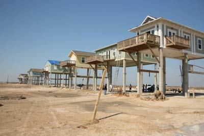

Six homes built to IBHS “Fortified” specificationssurvived Ike’s storm surge. About halfway up the pilings are the remains of utility decks set slightly above the Base Flood Elevation (BFE). Though not intentionally installed as “breakaway” elements, these lower decks were torn off by waves. (Photo by Richard Reynolds)
When dawn broke after the midnight landfall of Hurricane Ike a year ago, virtually every residence on the Bolivar Peninsula had been swept away by the hurricane’s overwhelming storm surge. Standing as lonely exceptions on the scoured beach, however, were 10 out of 13 homes built to the above-code standards of the Institute for Building and Home Safety’s “Fortified… for safer living” program. (The other 3 homes, experts believe, were probably taken out when their pilings were struck by floating debris from other nearby houses.) A year of study later, IBHS has released a full report on Hurricane Ike. The report, “Hurricane Ike: Nature’s Force Versus Structural Strength,” draws on the lessons of the of the 10 surviving Fortified homes. But it goes beyond those examples to examine a range of issues in storm-resistant construction, making observations and recommendations relating to key topics, including elevation, wind-driven rain intrusion, roof attachment, and roof deck waterproofing. Also included is a guide for retrofitting existing homes to boost their resistance to wind, rain, and flood. The key difference between the 10 surviving Fortified houses and their vanished neighbors was the height of the buildings’ first framed floor. The builder installed open utility decks for the homes at an elevation slightly above the area’s 19-foot Base Flood Elevation (BFE), then framed the floor systems for the first occupied stories 8 feet higher than that. In the storm, the utility decks were lost to storm surge wave action — but the foundation pilings, and the homes’ occupied space, survived.
