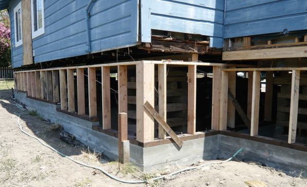

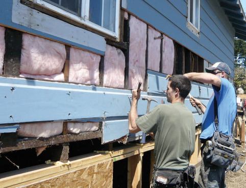

The 80-year-old two-bedroom house didn’t look too bad from the outside, but when I inspected the interior I found all kinds of problems. The ceiling was insulated with R-13 fiberglass batts, and several batts installed between the floor joists hung down into the crawlspace. Some portions of the exterior walls had been insulated during an earlier remodel, but others contained no insulation at all.

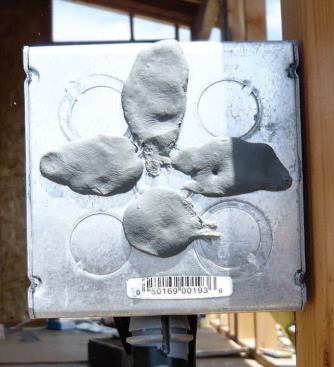

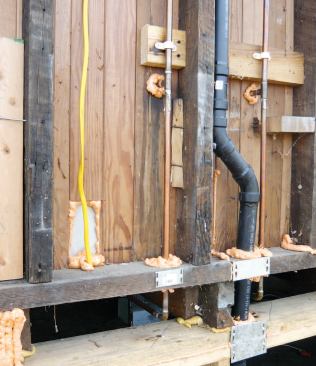

There was also clearly a lot of air leakage. Fifty years of electrical and plumbing additions had left the house riddled with holes, and the siding was nailed directly to the studs with no sheathing or air barrier behind it. I told the owners that unless we air-sealed the building, adding insulation would do little to lower the heating bills.

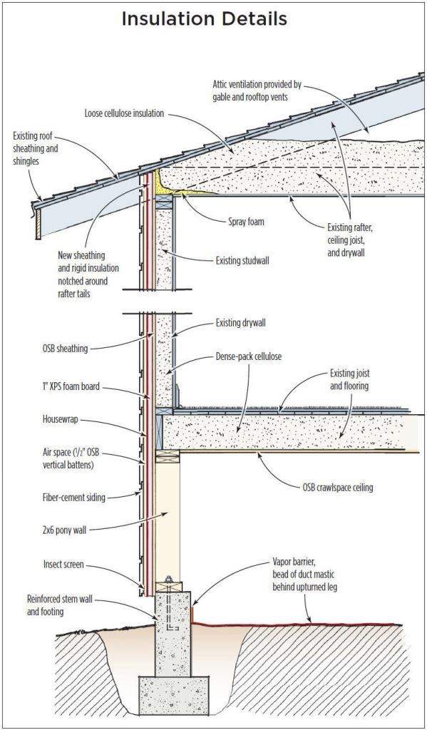

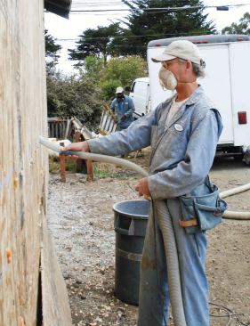

The good news was that the house had a floor area of less than 850 square feet and 8-foot ceilings, so the amount of air-sealing needed was relatively small. We decided to try to make the house as tight as possible within the budget we had to work with, which wouldn’t allow us to replace doors and windows. We also needed to preserve the interior finishes, so the stud bays would have to be accessed from the exterior.

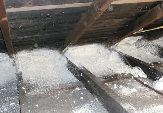

The primary insulation in the walls and floor would be dense-pack cellulose, with blown loose-fill in the attic. A new layer of OSB sheathing would be followed by an inch of rigid foam and housewrap, with an exterior finish of fiber-cement siding applied over a vented air space (see illustration).
