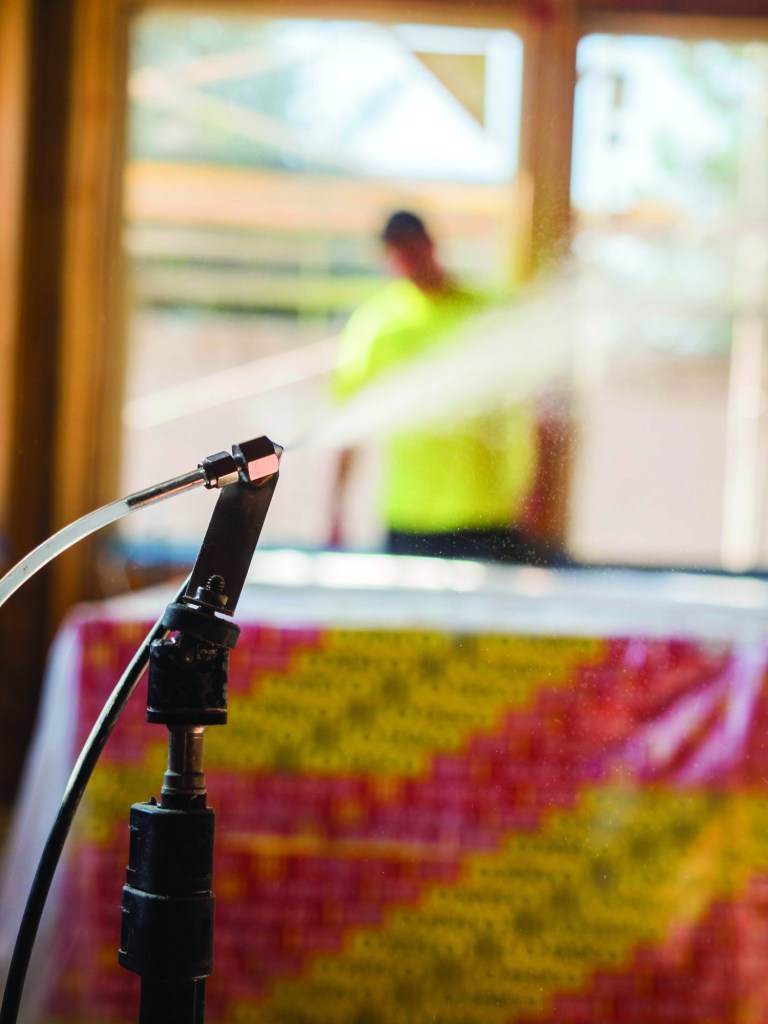

Nozzles inject AeroBarrier adhesive sealant into the air  of a building under 100 pascals of pressure, along with  humidity and heat. The caulking builds up and coagulates  at air-leakage points, sealing small holes in minutes.

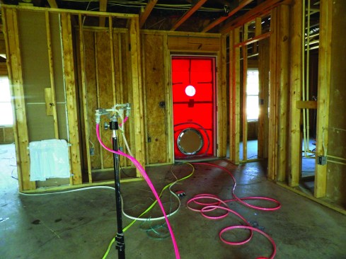

A fog of warm clog. “The beauty of AeroBarrier is how simple it is,” said Ferrell. “Basically, it consists of three things. There’s a blower door to pressurize the house; there’s a computer-controlled pumping system that pumps the product into the home; and then there is a series of nozzles—typically between six and eight, depending on the size of the house—that aerosolize the product in the home. All of that is driven from a support trailer that has a generator for power, and a compressor for compressed air.”
“When you pressurize the house to 100 pascals with the blower door, the house leaks,” Ferrell explained. “Everywhere it’s leaking, air is escaping. And once you aerosolize the AeroBarrier product into that shell, that product is leaking along with the air. The rig keeps the inside of the house warmer and more humid than it is outside, and when the fog hits that temperature and humidity differential, the product starts to gel, and it slowly builds up on itself.
“So if you have a crack between two 2x4s, or in a corner, you’ll see the product build up on itself until it seals that leak, and it stops leaking—completely. At all those little spots you don’t even know are leaking, that product is collecting and sealing it off.” According to AeroBarrier, the process works on holes and gaps as wide as a half inch.

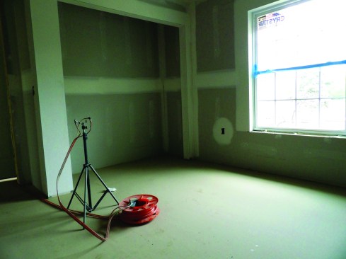

While a blower door pressurizes the house, emitter nozzles pump a fog of acrylic sealant into the building air. Walls can be exposed sheathing or finished with drywall.
Either way, the aerosolized sealant flows out through any air leaks and coagulates on small openings as it encounters a reduction in temperature and humidity.

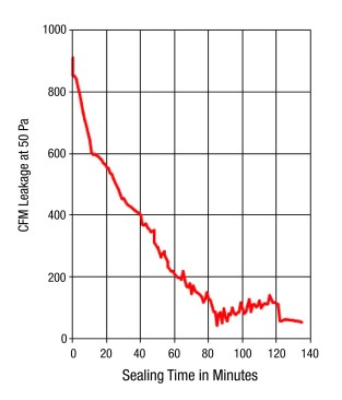

Calibrated control. Applicators monitor the process using a laptop, said Ferrell. “You watch the blower door,” he explained. “So you start at 4 or 5 ACH50, or whatever it is. And as the house leaks less and less, that blower door scales back the airflow to maintain 100 pascals of pressure. You see it on a graphic display in real time—the leakage rate going from 4 or 5 ACH50 down to two, down to one, down to a half, down to 0.3 or whatever—wherever we decide enough is enough [see chart, below]. And as you get lower and lower on that scale, your sealing slows down, because the air is leaking less. So it takes more time to seal up those last few tiny cracks.”
Mandalay was building tight homes before the company began to spray AeroBarrier, said Ferrell. “We use open-cell spray foam for walls as well as for our sealed cathedralized attics,” he explained. “Our company average for the previous two years, prior to AeroBarrier, was about 1.45 ACH50. And we were happy with that; but the problem was consistency. We would accidentally hit 0.8 ACH50 on some homes, but then we would accidentally have 2.0-plus ACH50 on some homes. AeroBarrier has helped us go from 1.5 ACH50 down to finish numbers of 0.5 or 0.6 ACH50 on our final test. That’s almost 300% tighter. But it has also given us consistency. And we know as soon we are done applying AeroBarrier how tight that home is, because the computer has been graphing it the whole time.”
Testing in, testing out. From experience, Ferrell said, his team knows what to expect as a pre-AeroBarrier blower-door test value. They use that knowledge as a pre-treatment screen for problems, he explained: “When we first turn the blower door on and get our initial leakage level, if it’s a unexpectedly high number, we go in the house before we start spraying the product and look for obvious holes. So if somebody poked a hole for a wire, or we missed something on an outside wall around an outlet, you can hear the air whistling through it when you’re at 100 pascals. So we plug those big leaks with some canned foam before we start the AeroBarrier process.”

AeroBarrier’s operating software lets technicians follow progress in real time as the home gets tighter, and also lets them stop the job as soon  as the home reaches the builder’s airtightness target. A printout documents the results.
