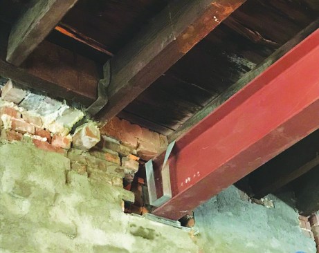

Before the masonry parge and air-sealing fluid membrane can be applied, masonry needs to be repaired as necessary.

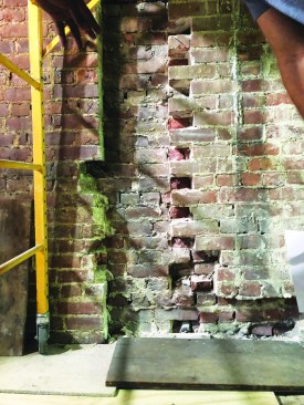

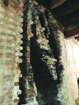

A chimney flue and other irregular surfaces will have to be filled before the wall can be coated.

Penetrations from new and existing structural carrying members also need to be filled and smoothed prior to air-sealing.

At this point, we need to repair any missing or damaged masonry as directed by an experienced structural engineer. These are pretty old walls that we’re working on, and most of them have seen better days. At the very least, you’re going to need to repoint certain portions of the wall. Some of the masonry may have water or fire damage. Earlier renovations may have been done in a way that requires repair now.

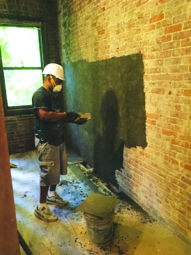

Then, once the masonry itself is in good shape, we recommend a full parge coat using a lime mortar, to create a flat and level surface for later air-sealing work. This allows the masons to even out any irregular surfaces from the masonry and fill small voids or gaps where necessary.

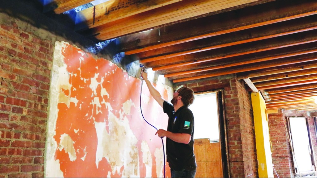

Once the wall field is prepared and any joist replacement has been completed, a liquid-applied airtightness material is installed over the parge. This material can be any of a number of products, but we typically recommend Sto Gold Coat or Sto EmeraldCoat. These water-based acrylic coatings, typically used for exterior waterproofing under EIFS applications, are vapor permeable but airtight, and can be rolled on or spray applied. This material is installed over the field of the wall and is applied roughly around the timber joists.
We apply a minimum of two coats at 12-mil wet thickness, and sometimes as many as three coats if the substrate is very irregular. Some installers have taken to adding a small amount of different colored pigments to the material before application in order to clearly show where the various coats have been, and have not been, applied, as an aid in inspection.
A lime mortar parge is the first layer to be applied to the brick masonry after rough repair is completed.

Next, the parge is coated with up to three coats of fluid-applied, vapor-open airtight sealing membrane.

Sometimes we have clients who push back on the masonry parge step, and want to apply the fluid-applied membrane to the bare brick and mortar without parging first. Occasionally, we’ve let that happen, but recently, I’ve become more of a stickler for the parge coat. It’s vitally important in order to get that nice, flat masonry surface. Without the parge coat, there are significant voids and gaps, and the Sto fluid is hard to apply on a rough, variable surface like that. It’s just like painting: Surface preparation is key. It’s boring, nobody likes to do it, and it’s invisible in the end, so nobody likes to spend money on it. But it’s important to prepare the surface properly to receive these additional coats.
While it is possible to air-seal around the joist-to-masonry-wall connection with tapes, sealants, or other products, the new generation of spray-applied flexible airtightness materials seem to provide a more cost-effective and thorough seal at this joint. Products such as Partel’s Blowerproof or Pro-Clima’s Visconn (see photo, page 43) are an ideal solution to this joint, because they can span over small gaps and maintain elasticity and integrity at this connection over the long term. The spray application also helps to speed up the installation of the product on these irregular and oddly shaped connections.

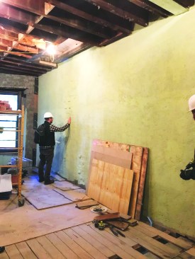

The final result is a fully membranecoated wall, ready for blower-door testing to verify airtightness levels.

Finally, we try to test our airtightness application with an interim blower-door test while we can still get to and fix the airtightness layers. Even the most careful air-sealing can still miss gaps in unexpected locations, and the blower-door test is the only good way to verify that everything has been installed correctly and is working as expected, and to point to any areas that need further attention.
