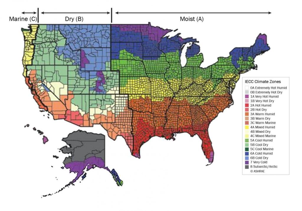

About 10% of U.S. counties have shifted to a new climate zone, most to a warmer zone. For more about this, see "Understanding the IECC’s New Climate Zone Map" by J.R. Babineau, a building scientist with Johns Manville’s corporate research and development arm.

Reflecting a warming world climate, the climate zone map has changed. Approximately 10% of U.S. counties have shifted to a warmer climate zone. The map also adds a new zone, climate zone 0, representing the hottest climates worldwide (although no U.S. cities are included in this zone). These changes now align with ASHRAE 169-2013, providing continuity in building standards that engineers have been requesting.

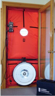

The 2021 IECC still requires blower door testing, but when a builder follows a performance option, the building can be leakier in climates zones 3–8.
Air-Sealing Limits
This exploration began while I was participating in an UnBuildIt podcast with Jake Bruton, owner of Aarow Building in Columbia, Mo., and architect Steve Baczek, who is based in the Boston area. Bruton had learned about the pending regulations from a summary of the code changes sent to him by HERS-rater Blake McClallen of Econsultants, based in Columbia, Mo. What caught Bruton’s eye was the air-sealing limits, which are no longer labeled “mandatory” and, most surprisingly, seem to have been downgraded. Previous limits set in the 2012 version of the IECC and continued in the 2015 and 2018 editions required 3 ACH in climate zones 3 through 8, and 5 ACH in climate zones 1 and 2. The 2021 energy code now states, “The maximum air leakage rate for any building or dwelling unit under any compliance path shall not exceed 5.0 air changes per hour … .” It was “under any compliance path” that tripped us up on a first reading. It’s not clear why that is included, as further on, the code clarifies that when complying with Section N1101.13.1 (the prescriptive option), the previous limits of 3 ACH for climate zones 3 to 8 still apply. But even with the prescriptive requirements remaining, a significant number of homes will be built leakier.
According to McClallen, in central Missouri and throughout the entire Midwestern region where Econsultants does business, fewer and fewer builders are following a prescriptive path. The majority are following the total building performance path, and a few others the Energy Rating Index (ERI) performance option, because these give them the most freedom in how they build. This is especially true with lumber prices exceedingly high and many builders seeking to show compliance with 2×4 walls.
Econsultants certifies compliance with property standards set by a number of state and local affordable housing or low-income tax credit programs, as well as certification for Energy Star, National Green Building Standards, and building code compliance. The majority of builders it is working with are not selling high-performance buildings. Instead, many are seeking to shave costs wherever they can to keep the building as affordable as possible. The performance path allows them to make trade-offs, usually identifying these by modeling home performance in a program like the Department of Energy’s REM/Rate that has the IECC provisions programmed in. So, for example, as you reduce wall thickness (and with it, insulation values), you need to increase other measures, like duct sealing (one of the easiest measures because it involves a limited area and it’s straightforward and inexpensive to apply mastic), or increase HVAC or water-heating efficiencies or lighting controls, or decrease window U-factors. None of these last measures, however, involves products that are much cheaper or easier to source right now.

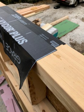

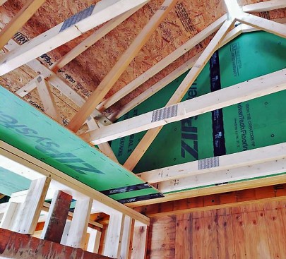

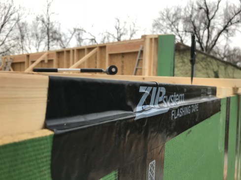

In the end, McClallen says, it’s often easier to stick with a 2×6 wall or switch to a taped sheathing product like Zip System, which he argues is one of the easiest ways to improve airtightness. By using that approach, a builder is often able to use 2×4 walls and less-expensive windows. “We’ll see how things go,” says McClallen, who has not yet been able to play with options in the 2021 REM/Rate, though he’s expecting it to be available any day now.

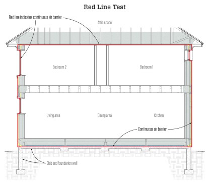

If the lower airtightness limits are a small step backward, the IECC takes two steps forward with improvements to Table R402.4.1.1 (Table N1102.4.1.1 in the IRC). In particular, added to the general requirements is the statement: “Breaks or joints in the air barrier shall be sealed.” This is key, notes Steve Baczek, because it nods to the fact that the air barrier isn’t one material—a point that trips up many in the trades. Steve always urges builders to do a “red line test” by drawing a continuous red line on building sections in the plans to define the air barrier (see “Red Line Test,” below ). This immediately shows that the air barrier can cross sheathing, framing, glass, drywall, and concrete and helps builders focus on the transitions between those materials.
Click here to enlarge

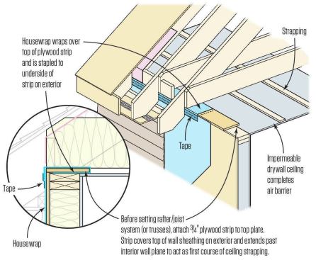

Red Line Test. The key to a successful air barrier is continuity. On any section drawn through a building, it should be possible to follow the air barrier around the entire perimeter of the building envelope with a red pen without lifting the pen from the page. In this building envelope, the air-barrier line passes from an insulated slab, through the walls and attic, and back down to the slab.
The new code improves the description of the air barrier, recognizing that it is not one thing, but composed of many materials—a point architect Steve Baczek makes when urging builders to define the air barrier on plans with a “red line test” to establish continuity and show where the transition points are that will need the most attention.

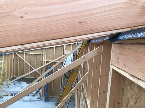

Rim joists. The air-barrier installation requirements now specifically address sealing “the junctions of the rim board to the sill plate and the rim board to the subfloor.” This language ropes in the rim joists for first-floor wood framing over the foundation, where you would have both a sill plate and subflooring.
Rim joists between floors is covered by the language in this section, which specifies “Rim joists shall include an exterior air barrier.” Here, sheathing spanning the rim joists typically serves this purpose, though joints between panels will leak air unless taped.

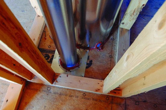

Utilities in chases. The 2021 IECC includes new language for sealing utility penetrations that run through a shaft or chase. The new code specifies that these now need to be “caulked, gasketed or otherwise sealed” to allow for “expansion and contraction of materials and mechanical vibration.” This new language seems to favor flexible boots (made of fire-rated silicone if it’s a flue), though it does also allow caulk or foam. It clearly disallows unsealed metal escutcheons.
Sheet metal and fire-rated caulk will work for air-sealing vents for combustion appliances.

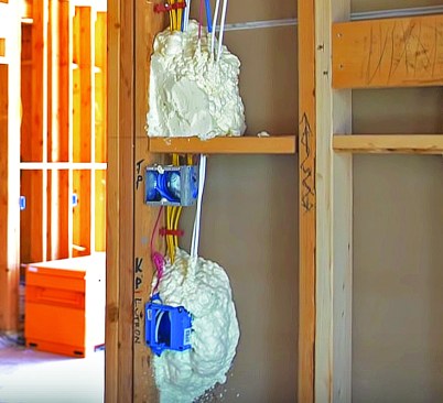

Plumbing and electrical penetrations. Previous versions of Table R402.4.1.1 had a blank cell in the air-barrier column for plumbing and electrical. The new code specifies that all holes created by “plumbing, wiring or other obstructions through the air barrier shall be air sealed.” (The use of the word “obstructions” instead of “penetrations” here is confusing. You want the air barrier to be an obstruction to airflow. What is a plumbing pipe or wire obstructing? )
In addition to the updates to Table R402.4.1.1, the 2021 IECC adds a new section titled “Air-Sealed Electrical Boxes,” which requires sealing electrical and communication boxes in walls “between conditioned and unconditioned spaces.” This section specifies the air leakage limit for these boxes and names NEMA OS 4-rated (gasketed and grommeted) boxes as an alternative.
Here there remains some gray area: If an official takes a strict interpretation of “unconditioned space,” that can draw a sharp focus on separation walls between attached garages, sheds, and other areas of a building that are not heated or cooled. The garage separation wall is especially important, as it not only limits the flow of unconditioned air into the living space, but can also keep out deadly car exhaust. (For more, see “How Not to Kill Your Client” by Matt Risinger.)
However, the code inspector could take a broad interpretation that includes the outside as the “unconditioned space,” and require you to air-seal every box in all exterior walls. If so, there could be friction if your exterior-wall air barrier is at the sheathing, and you don’t want to spend the money on OS-4 boxes or the painstaking work of caulking around every box. You may need to convince the building inspector there is already an air barrier behind the electrical box.
