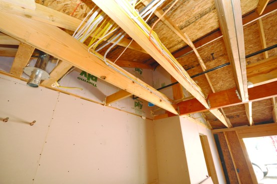

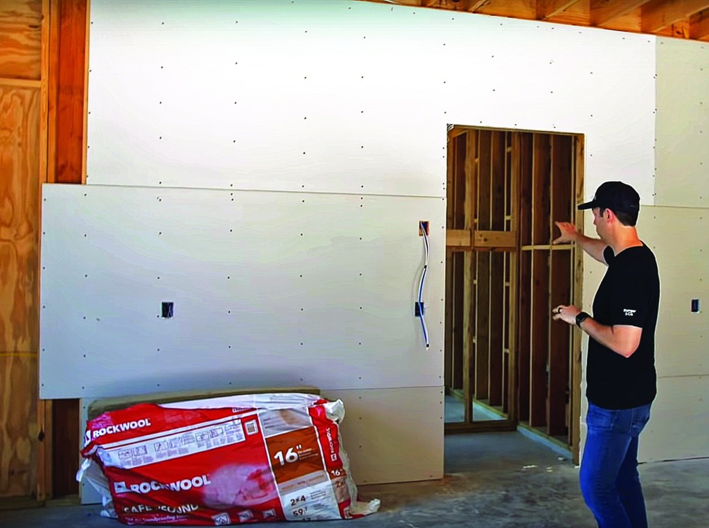

In the photos in this article, we show a typical one-story garage attached to a two-story house. To create a tight, thermal barrier, my crew starts by hanging drywall on this wall after framing. This happens before the drywall subs come and hang all the drywall in the rest of the house. Most of the time, our exterior wall framing is 2×6. (Yes, the garage wall is an exterior wall; it’s the thermal boundary between inside and outside the home.)
Installing this drywall ahead of time allows us to take care of two critical details: penetrations and the roof bypass.

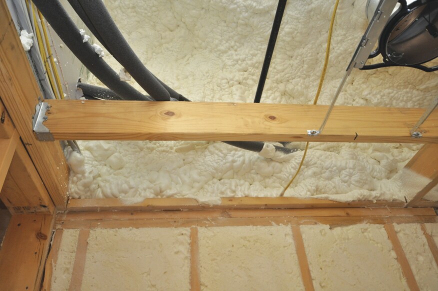

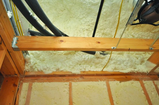

The rim-joist area and the wall above the rim joist are insulated to the roofline of the attached garage with 6 inches of closed-cell foam. This not only insulates the wall but also seals all penetrations.

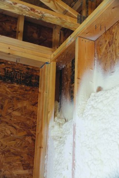

The garage-wall cavities are insulated with an open-cell spray foam. If installed to a depth of at least 4 inches, an open-cell foam provides a decent air seal to close off small cracks and gaps in the stud bays. Notice that the author frames with a California corner, so wall corners can be filled with insulation.
Penetrations. We install a two-part, closed-cell spray foam around any electrical boxes or other wall penetrations to create a tight air seal. In most residential garages, it is not practical to avoid outlets or lights on the garage wall; they serve a practical purpose for homeowners, and eliminating them is really not an option. But because we need to have these penetrations, we need to be certain they don’t leak.

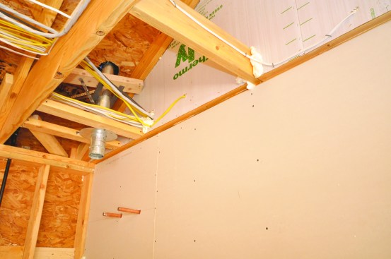

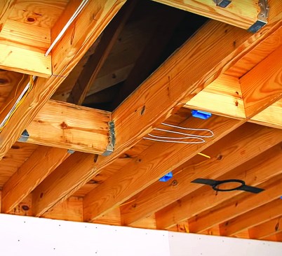

Roof bypass. This detail is perhaps more important because it represents such a big air bypass. We seal the garage wall all the way up to the roofline. This means we extend the drywall to the rim joist, and, above the ceiling line in the garage, we sheathe to the roofline with 1/2-inch plywood or another sheet good. (This is one good place for Thermoply, which I would not ordinarily use as an exterior sheathing, but in this case is used solely as a backer for the insulation; the smooth surface adheres well to tape at the seams for a good air seal.) Without this added sheathing, the wall above the ceiling is completely connected to the second story of the home. It’s best to do this at the framing stage, before the mechanicals are installed. But we’ve also followed on the mechanical installations by sealing any wiring and other penetrations that run inside the garage wall.
On the house shown in these photos, we insulated the walls with Rockwool and with open-cell foam. While we need closed-cell foam to air-seal large and direct penetrations, we get a pretty good seal with open-cell foam in the wall cavities, as long as we apply it at least 4 inches thick. On the wall above the rim joist to the garage roofline, the insulation contractor will spray the sheathing with 6 inches of closed-cell foam so we get a good air seal and thermal barrier.
Thermoply is not a sheathing the author ordinarily uses for structural framing.
However, it proves to be an excellent backer for airsealing above the rim joist to the roofline. The reverse side of this sheathing was later insulated with 6 inches of closedcell foam.

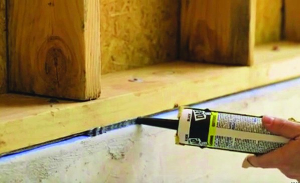

With a new home, we like to have the garage slab poured integrally with the rest of a structural slab for the house. But in existing homes we are renovating, it’s not uncommon to have the garage slab butting the main house foundation, whether that foundation is a structural slab, a stem-wall foundation, or a full basement. And whether there is a step up to the house from the garage slab or not, in all cases, we have a critical air seal to make between the concrete and the bottom sill of the garage wall.

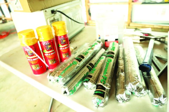

For sealing the slab-to-wall transition, the easiest method is to simply lay a fat bead of caulk in the gap created by the foam sill seal between the foundation and the framing. A top choice is a single-component, nonhardening synthetic rubber, such as Tremco’s Acoustical Curtainwall Sealant (what has been commonly dubbed “black death” in the field). This material stays flexible for an incredibly long time. But an exterior silicone formulation for concrete or a high-quality polyurethane sealant can also work for this application. In any case, I prefer sealants that come in sausage packs and that can be applied with a professional-grade gun. A sausage gun is so much easier to control and much less tiring to use than a skeleton gun.
Seal along the base of the wall between the concrete and the bottom plate with more than the standard foam sill seal.
A siliconized acrylic caulk formulated for concrete or a good-quality polyurethane sealant works as a sealant here.
