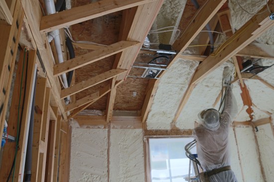

Spray polyurethane foam insulation works well to resist heat flow but it is not a whole-house air sealing solution.

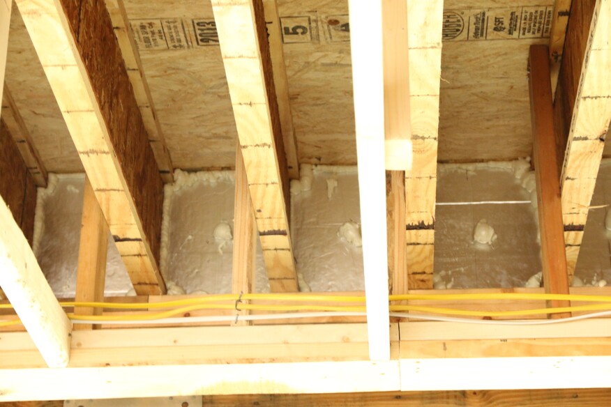

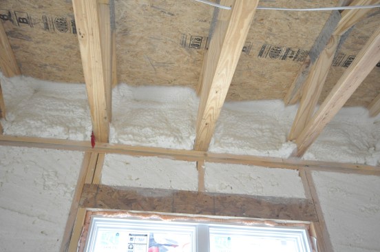

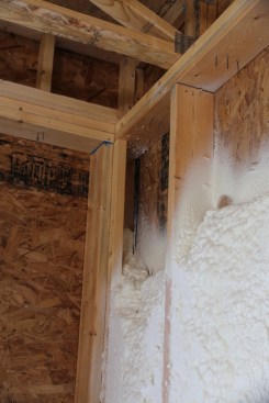

The first all-foam house I blower-door tested had 2×4 walls with 3 1/2 inches of open-cell foam, and 2×6 rafters with 5 1/2 inches of foam. That met code for climate zone 2 (Austin, Texas) at that time, and I expected a very low blower-door score. So I was surprised when the house scored a 4 ACH50. That was acceptable and below what was needed at that time for code, but the house was still not as tight as I had hoped.
Closed-cell foam will block air pretty well in wall and ceiling cavities, and is one of the best ways to seal band joist areas. But foam insulation will not seal all the penetrations in a house.
Cracks at plate lines are one obvious example of areas that will need extra attention. The author has also noticed that cracks can develop at the edges of framing cavities and the insulation over time. When he does use foam, his crew pre-foams the gaps and cracks in framing cavities before the bays are filled.

Meeting the prevailing energy-code requirements is the starting point for “good” air-sealing options. I am a fan of using spray polyurethane foam (open-cell above grade; closed-cell below grade or wherever you can afford it). It’s a good choice because it can air-seal some potentially difficult areas, like band joists and rim joists, and it’s great for creating conditioned attics—which we do often in the South because we don’t have basements for mechanical rooms.

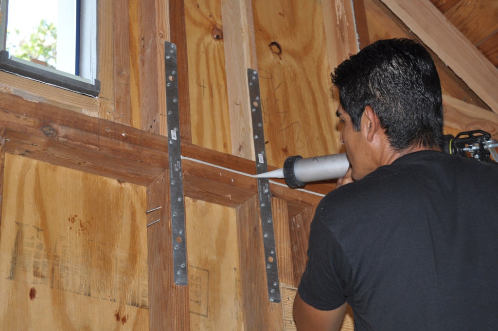

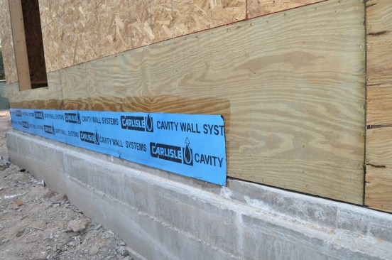

To meet minimum air sealing requirements (3 ACH50 for most of the U.S.) the author air seals between the foundation and the wall framing with peel-and-stick flashing.

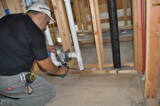

Before drywall, all plumbing and electrical pentrations in walls are sealed with expanding foam to stop air flowing between the lower floors and the attic.

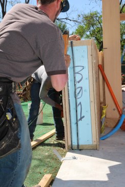

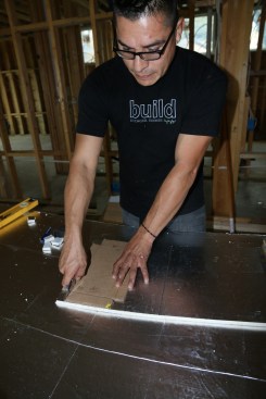

To seal rim joists, a carpenter cuts blocks from rigid foam using a template that has notches for the top and bottom flanges of I-joists.
Rigid foam blocks sealed in place with expanding foam sealant effectively air seal the rim joist.

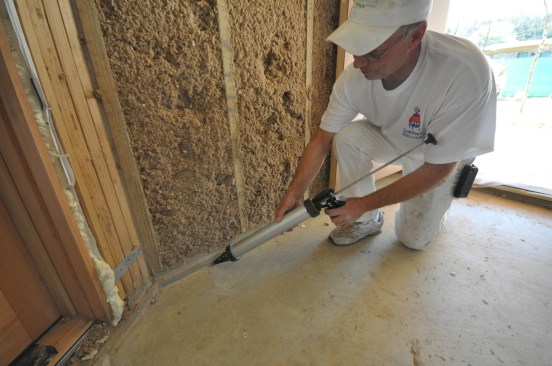

You’ll also want your drywall contractor to caulk drywall to HVAC vents, use low-expansion foam around windows and doors, and caulk bottom wall plates. If you follow these general guidelines, you’ll more than likely achieve blower-door scores of 3 ACH50 or less.

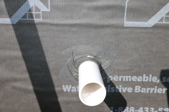

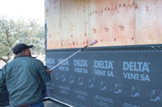

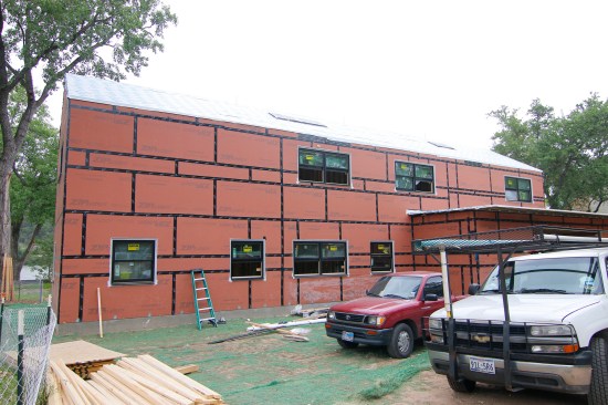

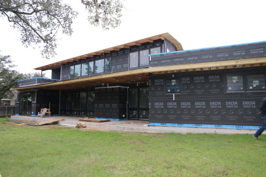

To reach a “better” level of airtightness, you need to use a peel-and-stick or a fluid-applied weather-resistive barrier (WRB). Zip System sheathing that’s fully taped will also work.
In the South, I often use Poly Wall Aluma Flash Plus, which is a foil-faced WRB. But foil is a zero-perm product, which is not a good option in a colder climate. You’ll want to avoid this unless you work in the hot-humid regions of the southern U.S. I also like Cosella Dorkin’s Delta Vent SA, which is a peel-and-stick WRB that has a perm rating of 50 and works in all climate zones.
Just like with the “good” air-sealing methods, I “prefoam” framing cavities and take care sealing details and penetrations with foam, caulk, and tape. This is time well spent. Once the drywall is hung, these areas will be inaccessible.

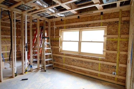

At the “better” level, we are doing everything we can to stop air flow at the outside wall. This includes taping framing to the foundation on the outside, as well as caulking or taping the inside.

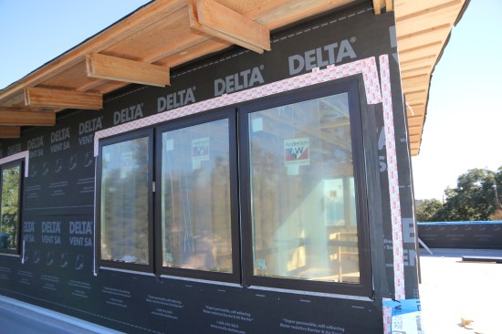

Better windows and doors. At this level, I also upgrade from standard lumberyard exterior and garage doors, and I want the architect to steer clear of pivoting or sliding doors, unless they are PG50 rated.
A PG50 rating takes design pressure, or DP, into account. A DP50 rating means the window or door can withstand an equivalent wind pressure of 50 pounds per square foot (as measured by an independent company in a lab). There actually are three DP tests, however—one for air, one for water, and one for “structure.” A window with a DP50-Air rating has withstood the equivalent pressure of a 142-mph wind, without leaking air. DP50-Water involves an 8-inch-per-hour rain with the equivalent wind acting on the window, without water leaks. DP50-Structure means the window or door can withstand the same levels of wind and water without deformation or failure.
A PG50 rating (PG stands for “Performance Grade”) refers to a window or door that has passed all three DP tests—for air, water, and structure. If you are looking to ratchet down your airtightness to near 1 ACH50, it’s helpful if PG50 windows and doors have been specified. Some manufacturers disclose this on their bids, but for others, you’ll have to dig this rating up. The Marvin windows and doors I often use are all PG50 rated.
Doors that are made by some of the other window manufacturers and that come with multipoint lock mechanisms often have a PG50 rating. They are certainly much tighter than the standard lumberyard models.

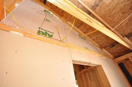

Next, the house must be designed from the start with airtightness in mind. I have two suggestions for framing.

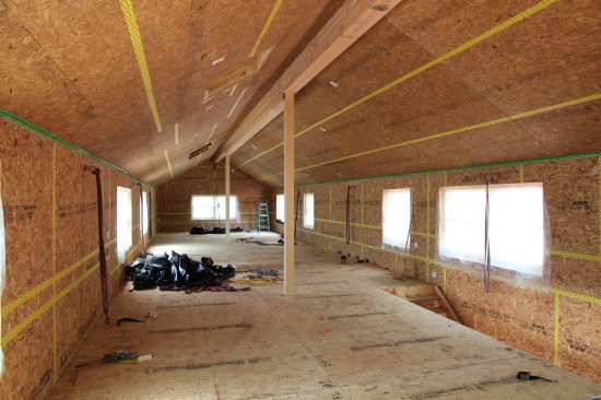

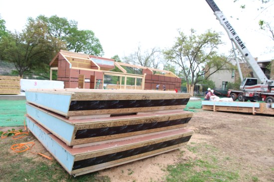

Modified SIP house. I recently had the opportunity to build one of the homes developed by the legendary timber-frame company Bensonwood, here in Austin. The walls and ceiling panels are factory-framed and result in a super-tight and extremely well-insulated shell. The panels have Zip System sheathing, I-joist studs, and an interior layer of OSB. Everything gets taped inside and outside. Wall panels are joined with double bulb gaskets, including where walls intersect with the slab foundation and where roof panels join at the ridge. The house had no overhangs when it was first framed so that the air barrier (Zip System with a peel-and-stick roofing membrane) could run continuously up the walls and up and over the ridge.
Most SIP homes are similar and are also a “best” option.

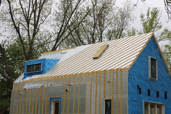

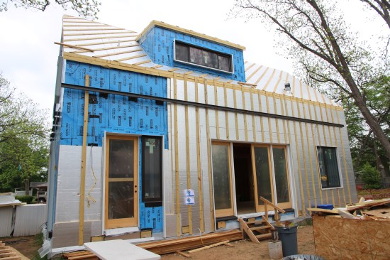

Perfect Wall. One option for super-tight construction without factory framing is a “Perfect Wall” house. We recently completed one that used standard wall framing with conventional lumber; again, the design had no overhangs so the WRB could run continuously from the foundation, up and over the ridge, and back down again. This makes for a super-tight house from an air-sealing perspective.
The author of this method, Joe Lstiburek, of Building Science Corporation, calls this a 500-year house. It can be built in any climate zone in the U.S. just by varying the thickness of the exterior insulation to provide condensation control. In our case, we used 4 inches of polyisocyanurate foam board on the exterior walls and 8 inches of polyiso on the roof. No cavity-fill insulation on the inside of the home was needed.
