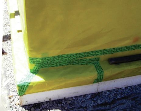

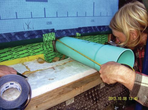

The air barrier begins under the house. Surprisingly, there is some air movement below grade. The air barrier under the footing and slab is also a vapor retarder and radon retarder. For this, we used 10-mil Stego Wrap. We weren’t satisfied with the adhesion from the tape that is sold with the Stego Wrap, so we switched to Siga Rissan tape. Rissan is so sticky that the reinforced tape will pull apart before the bond with the plastic gives out. As you can imagine, this created a number of interesting folds at the four corners of the house, similar to wrapping a present.

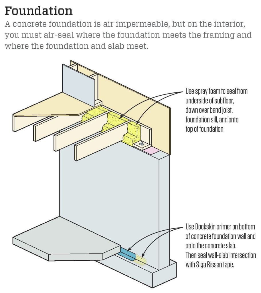

If you aren’t aiming for Passive House airtightness, but still want to do a good job in a conventional building, pay attention to the junction between the foundation wall and slab, which is a potential air leak when there isn’t a continuous plastic layer below. This seam can be sealed with Siga’s Rissan tape after you’ve primed the concrete with Siga’s Dockskin liquid sealer (see Foundation). The tape, available in 2.5-, 4-, and 6-inch rolls, has a divided peel-away strip, so it’s easy to fold into corners.
If the foundation wall is poured concrete, no separate air-barrier layer should be needed, as concrete is fairly airtight. Be sure to seal any service penetrations before they are inaccessible. Make sure to air-seal and insulate behind electric service panels.
If you have a CMU foundation, depending on the type of block, it could be fairly leaky and needs to be sealed with a coat of plaster or a fluid-applied air barrier. By the way, basement windows are notoriously leaky and provide little useful light. If they don’t serve a good purpose, don’t put them in.

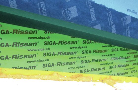

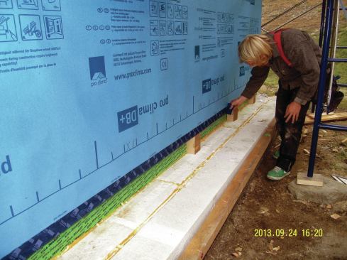

The connection from the foundation air barrier to the wall air barrier is often a difficult junction to seal in a conventional house. Typically, builders install sill seal between the masonry and the framing, which is marginally effective, especially when the foundation’s J-bolts pass through the sill seal. The top of the foundation wall is rarely flat enough for generic sill seal to fill the gap between the concrete and band joist, resulting in serious air leaks as well.
In our Passive House, though, that connection wasn’t an issue. Because the foundation air barrier ran up the outside of the foundation and was more or less in line with the air barrier running up the outside of the structural wall, there would be no J-bolts penetrating the air barrier or gaps between the top of the foundation wall and the mud sill to worry about.
In some buildings, taped housewrap might be your best air barrier. Instead of just stapling it at the bottom of the wall sheathing, tape it to the foundation wall with a 6-inch-wide piece of 3M flashing tape or Siga Rissan tape after priming the concrete with Siga Dockskin.
If the foundation is insulated on the outside, leave a section of insulation off at the top of the concrete wall until the connection between the air barriers is made. If the concrete itself is the finish above grade, hold the apron board trim 2 inches down to hide the taped seam (see Foundation to Framing, above) .
Another way to seal the foundation-wall-to-framed-wall connection is from the inside with spray foam. With a froth pack, foam from the underside of the floor sheathing down the band joist and connect it to the foundation wall. This approach still leaves the subfloor-to-wall-bottom-plate connection as a potential air leak that will need to be sealed with foam or caulk. The Passive House Institute doesn’t recommend relying on spray foam as an air barrier because it can crack over time, but I think it’s a significant improvement over relying on traditional sill seal.

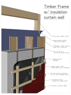

Defining a continuous air barrier on the framed-wall part of the building can be tricky. In a conventional building it could be drywall or vapor retarder on the inside, or housewrap on the exterior. An interior air barrier is preferable from a moisture-control perspective, but every electric outlet and floor seam needs to be sealed, which is time-consuming. An exterior air barrier is less desirable from a building-science perspective, but makes it easier to achieve continuity—by simply taping the seams and holes in the housewrap or by using the Huber Zip System.
In a Passive House or super-insulated wall, the air barrier needs to be on the inside to prevent inside moisture from getting into the wall assembly and condensing. While polyethylene sheeting is a good choice for an air barrier under and around the foundation to keep out as much ground moisture as possible, it isn’t a good choice for a framed wall, except in the coldest climates. Where there is a possibility of vapor drive both from the inside out and from the outside in, a variable-perm vapor-control layer, such as the Pro Clima DB+ that we used on our Passive House, can be a safer option. The vapor-control layer can also serve as the air barrier.

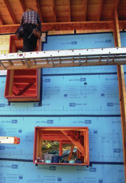

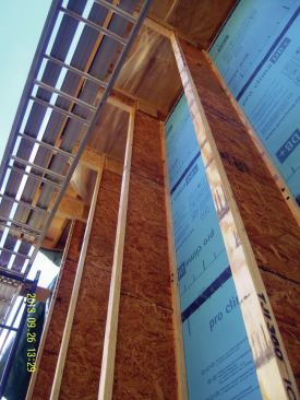

With a complete and permanently sealed air barrier, not destroying it as we built our insulation curtain wall was our only remaining challenge. Our insulation curtain wall consisted of 16-inch vertical wood I-joists spaced 36 inches on-center filled with dense-pack cellulose. Six-inch-long HeadLok screws were used to attach the I-joists. These screws would penetrate the air barrier, so to seal the screw holes, we pre-drilled each joist while it was on the ground, then applied Pro Clima’s permanently flexible caulk, Contega HF (OR-F), to each hole. The screws cinched the joist tight to the DB+ and the caulking was compressed for a good seal.
DB+ is a reinforced paper-based product that requires a certain amount of care during installation. It comes in 4-foot rolls, which are easy to handle. The membrane is stapled to the building only at the seams, where they will be covered with tape (see Framed Wall Air Barrier). We used Tescon Vana from Pro Clima to tape the seams and any rips or tears from the installation.

The most challenging part of the wall air barrier is the airtight connection to the windows and doors. The windows on our Passive House project were going to be “outies,” so a connection needed to be made from the DB+ air barrier on the sheathing to the windows set on the outside of the wall. Our 3/4-inch plywood bucks were set in place before we started wrapping the building with DB+. The DB+ was carefully cut around the window and taped to the buck with Tescon Vana. All the seams in the buck were sealed with Prosoco’s R-GUARD Joint and Seam Filler. The outer half of the window buck was then protected with Prosoco’s R-GUARD fluid-applied WRB. This is a vapor-open, waterproof, weather-resistant barrier that is simply rolled on.
Effectively taping the windows for airtightness on the interior side requires some skill and takes time to master. We still spray-foam windows in place for insulation, but the tape provides the real permanent air barrier.

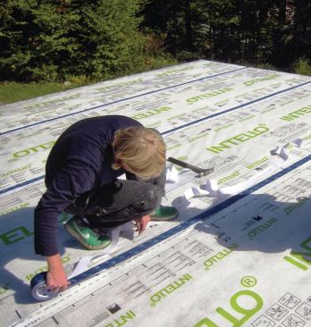

The soffit framing on our Passive House was built on top of the insulation assembly, which was above the air barrier, so there were no framing penetrations to deal with. The air barrier on the ceiling was our most important surface to completely seal. This roof assembly was designed to be both foam-free and unvented, utilizing the advanced moisture-controlling properties of Intello.
To seal the holes for ventilation intake and exhaust and for electric and water service, we used EPDM gaskets taped directly to the air barriers. A section of the conduit or piping must be placed through the gasket before insulating.

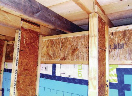

In most conventionally framed buildings, you’ll need to find a way to connect your ceiling plane to the wall air barrier. No matter how bomb-proof your wall and ceiling air barriers are, if they aren’t connected all the way around the building, neither will be effective.
Cap off the top of your wall by attaching a strip of plywood to the top plate before setting your trusses or joists and rafters. Wrap housewrap from the exterior wall sheathing up and over the plywood strip, and then staple it to the underside of the strip. The strip can also serve as the first course of strapping (see Walls to Ceiling).
