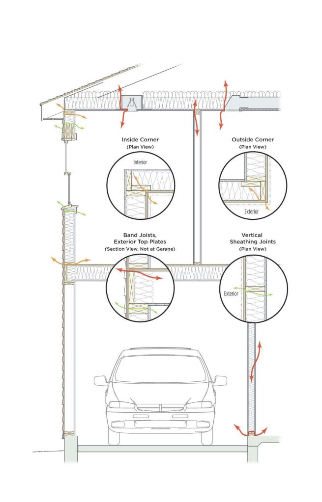

The arrows represent common air leaks in a building, and their colors correspond to data in the chart at far right. Note that the leaks at the window represent those between the sheathing and the framing around windows (and doors). They are not those between the window unit and
the rough opening. (It is assumed these gaps will be air-sealed without question.)

Faced with the question “With nearly a mile of joints on a typical house that connect the inside to the outside, which ones are the most important to air-seal?”, Dave Wolf, senior research and development project leader of Owens-Corning Science and Technology, set out to prioritize the leaks in a house by ranking which ones have the biggest impact on reducing the blower-door number. Acknowledging that many builders who will be trying to meet the new energy code will have a limited budget for air-sealing, Wolf’s goal was to identify the leaks that would give a builder the most “bang for his air-sealing buck.” He approached this on two fronts: in a research lab and in a test house.

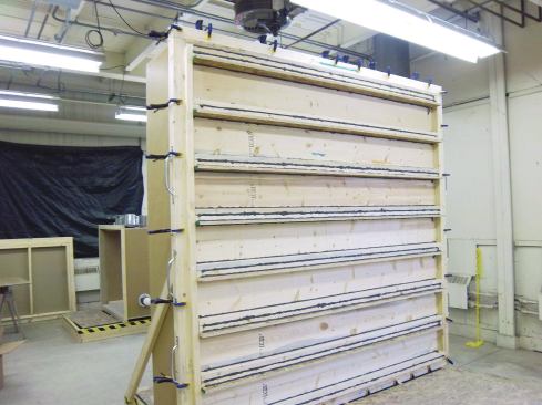

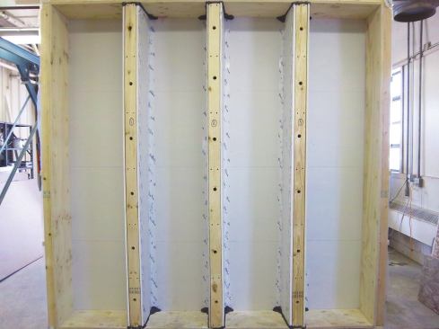

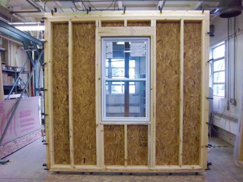

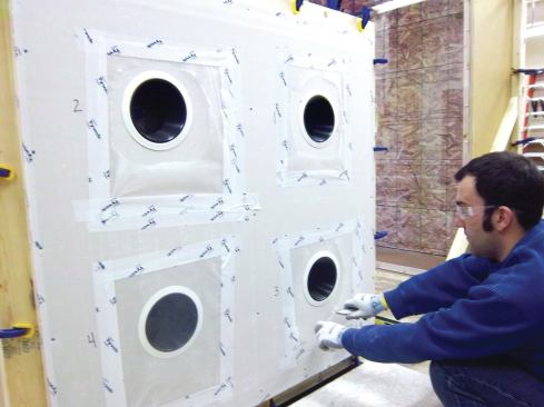

In the research lab at Owens-Corning, Wolf’s team built an 8-foot by 8-foot pressure chamber. It’s essentially a big box, with one 8×8 face open that the researchers filled with an 8×8 “plug” before depressurizing the chamber to 50 pascals. Each plug was composed of a different kind of building assembly. Four of these can be seen in the photos on page 40; 17 different ones were used in all. The idea was to create a lot of variability in each type of leak through a building assembly. Using a soft clay with which the research team could systematically seal and unseal the joints, Wolfe recorded the effect on CFM50, and gradually collected enough data to develop coefficients (in CFM50 per foot of leak or CFM50 per unit for duct boots, recessed light, switch and outlet boxes, and the like) for each type of leak.
Next, Wolf’s team moved to a test house that stood on the grounds of the Owens-Corning research facility. The house was gutted, bringing it to the appropriate phase of construction just before insulation when all the framing joints and penetrations into the attic could be sealed. The work here was a little more painstaking, as it had to be done in concert with continuous blower-door testing, but it followed the same general procedure: Seal and unseal the joints, and record the effect on the blower-door readings. By plotting the reduction in CFM50 against installation cost for each type of leak (with cost inferred from the amount of material needed plus the effort to seal a joint), Wolf’s team ranked air leaks in order of importance. The results are shown in the chart below.
