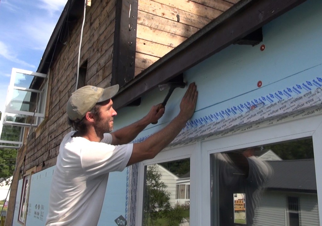

Continuous exterior insulation—commonly provided by wrapping a building with rigid foam—is nothing new to residential construction. But as it has found its way into energy codes in northern communities, it has advanced to become a mainstream wall system, even though a lot of builders are still unfamiliar with it and don’t always understand the role it plays in the thermal and moisture performance of walls.
Continuous insulation (CI) was first introduced to the 2006 International Energy Conservation Code (IECC) as an option in climate zones 5 and 6. (In the code, it is indicated with an equation, such as “13+5,” which stands for R-13 in the wall cavity and R-5 continuous exterior insulation.) With the introduction of the 2012 IECC (and continued under the 2015 edition), continuous insulation became a requirement for climate zones 6, 7, and 8. In these zones, you have two choices and both require continuous insulation: 20+5 (for example, a high-density, R-20 batt in a 2×6 cavity with 1 inch of XPS foam on the exterior) or 13+10 (for example, a 3 5/8-inch fiberglass batt in a 2×4 wall with 2 inches of XPS on the exterior).
Perhaps leery of taking the CI plunge exclusively, some states have amended this requirement. New York is a notable example. By the time the state adopted the 2015 IECC (skipping over 2012), the NYS 2016 energy supplement allowed two options for climate zone 6. “Option 1” is equivalent to the chapter and verse of the current IECC wall insulation requirement. “Option 2” allows R-25 cavity insulation only, without continuous exterior insulation. (Note: if builders follow Option 2, they have to opt in for the full gamut of fenestration and insulation requirements, including slightly more energy-efficient windows and slightly better interior basement insulation). Option 2 is largely seen as a hat-tip to spray-foam insulation, which has gained a strong foothold in the New York market, though you can comply with Option 2 using any wall system that provides R-25; an 8-inch fiberglass batt in a 2×8 wall, for example, would comply. What Option 2 doesn’t provide is relief from thermal bridging or condensation control.

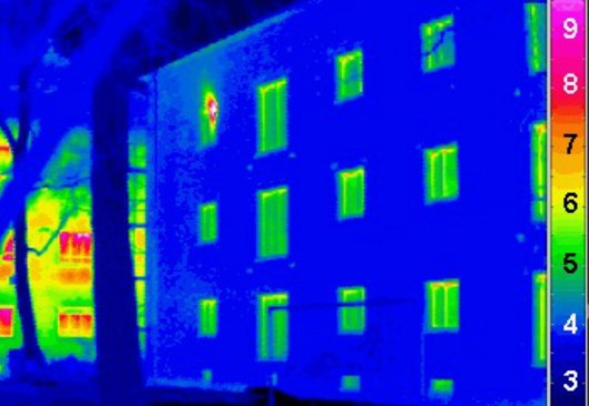

In a wall, cavity insulation only slows down the flow of heat through the stud bays, while every stud, trimmer, header, cripple, and wall plate acts as a thermal bridge, bypassing the cavities and siphoning heat from the building (1). Peter Baker and Joe Lstiburek, in the must-have Building America resource “Measure Guideline: Incorporating Thick Layers of Exterior Rigid Insulation on Walls” (PDF) estimate that thermal bridging reduces a conventionally framed wall’s nominal insulation value by at least 20%. In a typical framed wall without continuous insulation, R-20 batts really perform at about R-16, and R-13 insulation at about R-10.5—well below nominal insulation values. Adding foam to the exterior brings the total wall value near the nominal values for the cavity fill: A “20+5” wall (for example, R-20 batts and 1 inch of XPS rigid foam) has a total wall value of R-19.4; a “13+5” wall (for example, R-13 batts and 1-inch XPS) has a total wall value of about 14.3.
The effect of thermal bridging can be seen immediately in the infrared image. Without continuous exterior insulation, heat conducting through the framing is visible (also visible are air leaks and conductive losses at windows and through spotty patches of insulation).
The thermal envelope on this house has been built specifically to reduce thermal bridging and shows no heat loss through the framing. (There is one obvious air leak around the window on the upper left of the facade, though ... not to be confused with the house across the street.)
The thermal envelope on this house has been built specifically to reduce thermal bridging and shows no heat loss through the framing. (There is one obvious air leak around the window on the upper left of the facade, though … not to be confused with the house across the street.)

Building codes have traditionally addressed condensation by trying to limit the amount of water vapor that gets inside building assemblies. Chapter 7 on Wall Coverings in the IRC is where you need to look to find guidance on reducing the condensation risk with continuous insulation. It’s couched in the vapor-retarder requirement, and is a little veiled. Section R702.7 states that you need a Class I (poly) or a Class II (Kraft-paper) vapor retarder on the interior face of walls in climate zones 5, 6, 7, 8, and Marine 4. You can use a Class III retarder (latex paint on the drywall), but only when you either install a vented cladding on the outside of those walls or install enough continuous exterior insulation to keep the sheathing warm.
How much is enough? The minimum R-values for continuous insulation are provided in Table 702.7.1 (see excerpt, above). Note that when continuous insulation is installed over a 2×6 wall in climate zones 6, 7, and 8, the amount of continuous insulation needed to control condensation is more than the amount of insulation required to meet the building thermal envelope requirements (Table R402.1.2; see excerpt at top of page). In other words, if you follow only the insulation requirements in Chapter 4 of the IECC (which are the same as Chapter 11 of the IRC), you may be building a risky assembly (see “Condensation Potential in Exterior Walls”). If you are only seeking code compliance, the safe bet for any wall regardless of the type of vapor retarder you install is to follow the recommendations for continuous insulation provided in Table R702.7.1.
The risk of not adding enough continuous insulation is critical to understand if you want to go beyond code, as well. For example, what if you want to add an inch of rigid foam to the exterior of an R-20 wall in climate zone 5 or Marine 4? If R-5 is allowed for the 2×4 wall, wouldn’t adding R-5 to a 2×6 wall be even better? No. Compared with the 2×4 (13+5) wall allowed in these climate zones, the interior of the sheathing will be cooler in the 2×6 wall because there is more cavity insulation. And compared to the R-20 wall allowed, you haven’t gone far enough; the sheathing is still likely to reach dew point during winter conditions.
The simplest way to build better walls is to use Table R702.7.1 as a baseline and add more continuous insulation outboard of the wall cavity. But if you are serious about going beyond code and avoiding wet walls, calculate the thickness for the given climate conditions and cavity insulation using the method described in John Straube’s seminal article “Controlling Cold-Weather Condensation Using Insulation” (BSD-163; buildingscience.com). Ted Cushman’s article “Robust Walls” (Nov/06) explains the calculation using specific examples for Boston conditions (climate zone 5).
