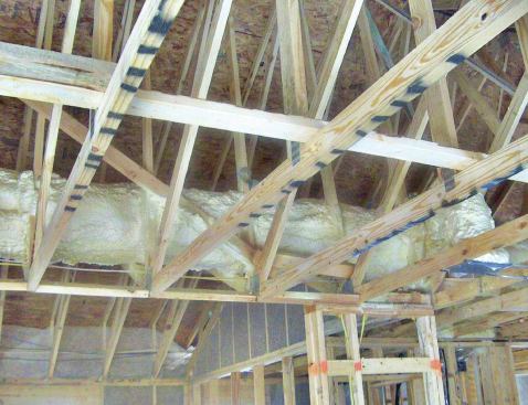

CARB’s work on ducts started when one big builder it was working with pushed back on recommendations to drop the ceiling so that ductwork could be run inside the insulation and air barrier. The builder wasn’t willing to sacrifice ceiling space, Zoeller says, but was willing to run the ducts close to the ceiling plane in the attic and pile more insulation over them. Doing just this improved HVAC performance enough that the DOE asked the CARB team to run some metrics to quantify the improvement in energy savings in all climate zones.

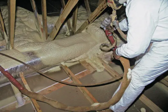

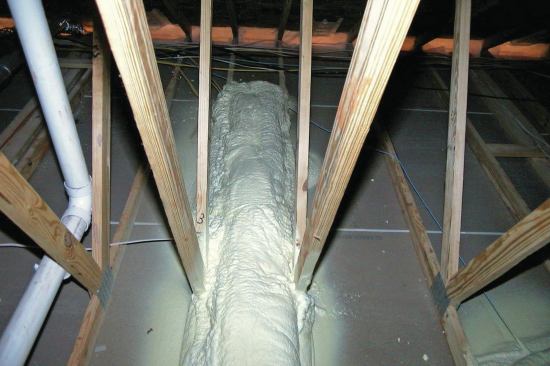

Work in hot, humid climates revealed a problem. While the added insulation provided lots of thermal resistance to prevent the hot attic air from warming the air in the ducts, it lowered the temperature of the duct jacket, allowing it to fall below the dew-point temperature. This allowed condensation to form on the outside of the ducts when attic humidity was high. The solution: Spray at least 1 ½ inches of closed-cell foam on the outside of the duct. (Note: At least 1 ½ inches of mineral fiber insulation is required as an ignition barrier over spray foam, unless the foam is approved for use without an ignition barrier. See “Making Sense of Spray Foam and Ignition Barriers,” Nov/12.)
In CARB’s field studies, during which the team monitored temperature levels, the combination of burying ducts in loose-fill insulation and encapsulating them in closed-cell spray foam showed no potential for condensation. The tests demonstrated that encapsulating the ducts brought the existing R-4.2 flexible ductwork to values between R-9 and R-13, depending on duct size. Burying and encapsulating ducts increased R-value to levels between R-16 and R-31. In addition, the spray foam substantially reduced duct leaks, bringing the leak rate to a level comparable to that in houses with air-handling units in the living space. Zoeller recommends that ductwork be sealed with mastic prior to insulating, even when encapsulating. It’s the sort of belt-and-suspenders approach that makes most energy measures work.
