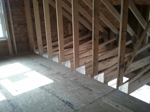

To construct a typical bonus room, the builder first installs OSB subflooring on the truss chord.

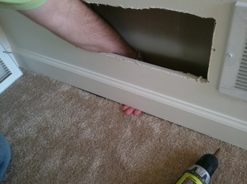

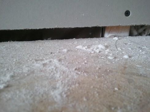

The photos above show a typical bonus room at various stages of construction. Because the framing is basically a set of trusses, there is no wall plate at the bottom of the wall. As a result, there’s a gap—typically a big gap—at the bottom of the wall. This allows air to leak freely into the room from the space behind the wall, which is connected to the outdoors via the roof eave soffit vents.
Bonus rooms have big leaks. In pressure diagnostics, if I close the door to a bonus room and isolate it, I often measure a 20- to 25-pascal difference between the bonus room and the main house—and you can feel the air pouring in under the door.

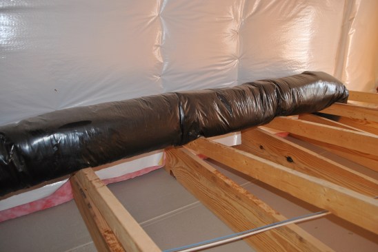

To make matters worse, the typical forced-air heat for a room like this tends to underperform. The ducts serving the room typically are insulated to only R-4.2 (code now requires R-8 for ducts 3-in. or greater in diameter that run through unconditioned space) and run the 24-foot length of the garage through unheated space and then back to the furnace in the basement—often the longest duct run in the house. The thermostat is generally located in the family room on the first floor. So, controlled by calls for heat from the warm inside of the house, the furnace would struggle to heat the bonus room adequately even if the bonus room weren’t leaky, poorly insulated, and exposed on five sides to outdoor temperatures.

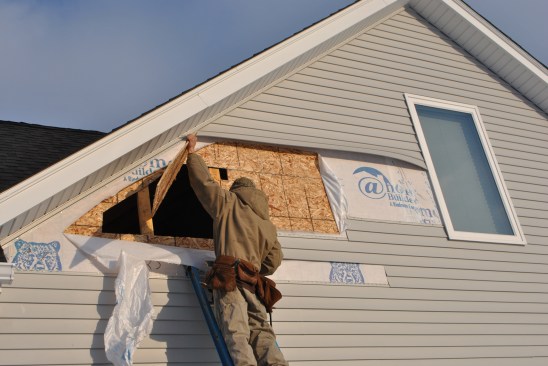

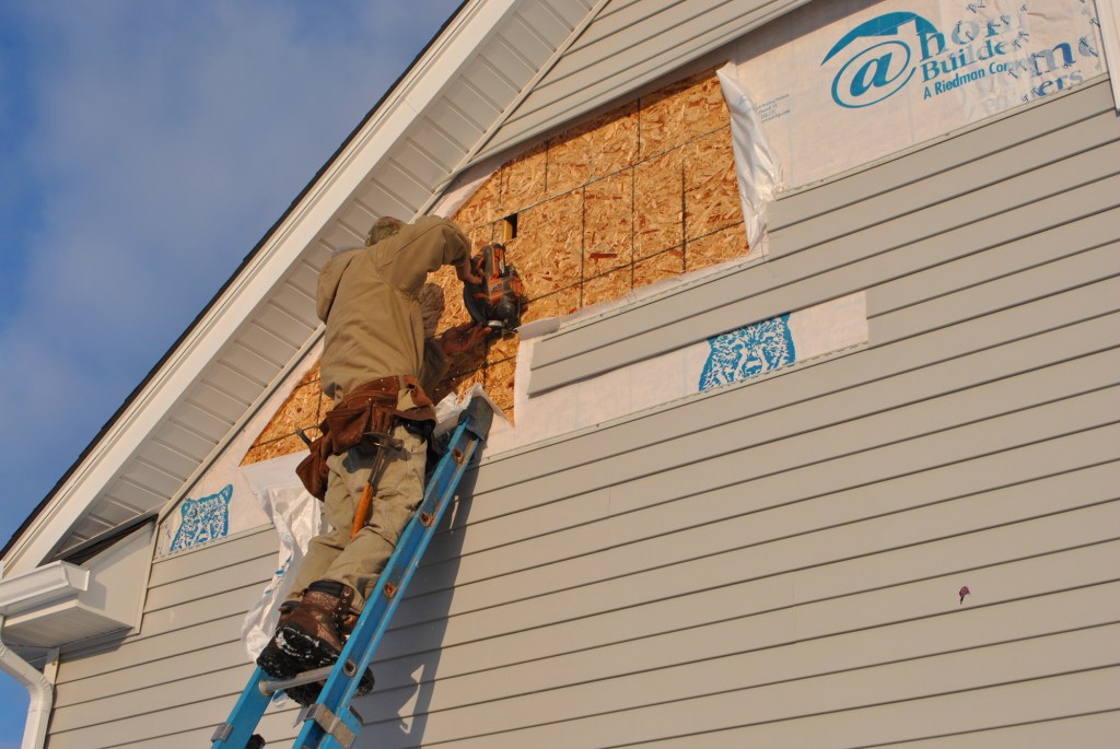

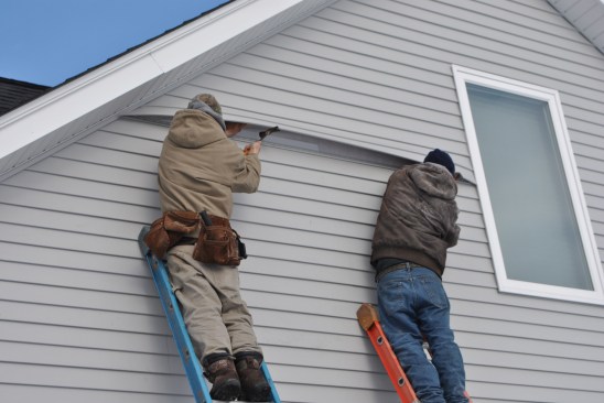

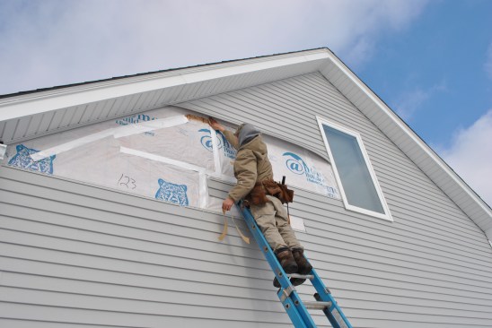

Before we start a job like this, I look in the bonus room to make sure that there aren’t valuable things hanging on the walls. We are going to be nailing up an air barrier from the other side and don’t want to knock anything off the wall. I also find out where the duct registers are, so that we’ll have an idea of what to expect when we open up the space behind the wall. And finally, I like to double-check the room dimensions to make sure that when we cut open the gable end of the house, we won’t cut into the occupied space. I take a measurement from the window to the knee wall inside the room, and then we measure off the same window when we choose a place to cut open the gable end.
Gaining entry through the gable end is the simplest approach. We could cut through the drywall from inside the room, or we could go in through the ceiling of the garage, but then it would be hard to patch up the holes we would make. Vinyl siding just unzips; then you take a couple of nails out and peel back the housewrap, cut out a piece of sheathing, and climb in. On the way out (see photos, page 64), you replace the sheathing, tape up the housewrap, rehang the vinyl, and move along.

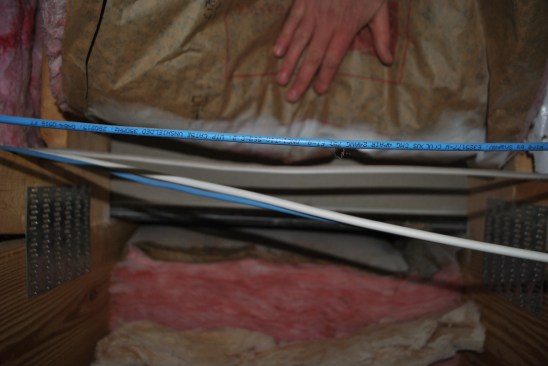

Under the low roof, he finds the back of the bonus-room wall, with a plastic air barrier stapled to the wall over the fiberglass insulation (but not sealed at the top or the bottom).

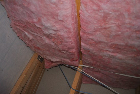

With the plastic removed, the R-19 batts bulge out beyond the 2x4 framing.
With the plastic removed, the R-19 batts bulge out beyond the 2×4 framing.

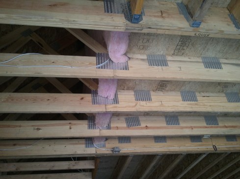

Where the wall meets the floor, nothing blocks air from flowing through fiberglass batts installed under the subfloor
What we found in the space behind the bonus-room knee wall in this house is typical. The white plastic air barrier is not sealed at the bottom or the top. (Air barriers on knee walls are required by code. This requirement is found in Table R402.4.1.1 of the 2015 IECC. The same table requires the knee walls to be sealed at top and bottom.) With the plastic sheeting removed, the R-19 fiberglass insulation bulges out from the 2×4 wall framing cavities. When I fold back that kraft-faced wall insulation at the bottom, we see the condition under the floor: two insulation batts stuffed up into the truss bays from below, with the lowermost batt’s kraft facing stapled to the truss sides to hold the insulation in place. And it’s a little hard to see in these photos, but the joint between the subfloor and the drywall is open half an inch—and there’s daylight between the baseboard and the carpet.

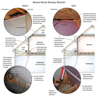

CREATING AN AIR BARRIER

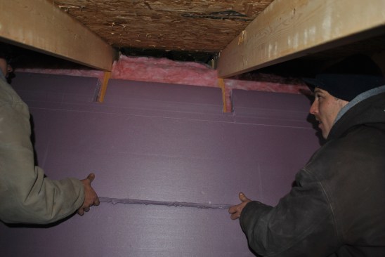

On the left side of the illustration above, you can see the deficiencies that made this room so uncomfortable; on the right are the repairs that our crew made. When the original plastic air barrier membrane was installed, somebody took time to notch it out around the bottom chords of the trusses—but it was never sealed. Our goal was to seal our air barrier all the way around the truss chords and seal it to the drywall underneath.

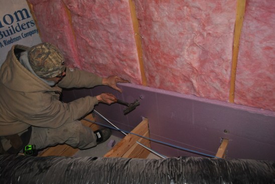

Carpenters notch and fit 2-inch XPS insulation board over the wall studs, fastening the board with nails and washers as they compress the R-19 batts into the wall framing cavities.

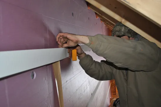

Fabric wraps are difficult to work with, so we like to use a beefy rigid air barrier material here. For this job, we used 2-inch XPS foam, which adds R-value and is stiff enough to compress the existing R-19 batts into the 2×4 wall cavities (note: some jurisdictions may require a fire-rated material such as Dow Thermax at this location).
They cover the whole wall with 2-inch (R-10) XPS, notching around the upper truss chords at the top of the wall.
We notched the XPS out carefully to fit around the trusses, making sure the board contacted the drywall at the bottom of the truss cavity, and attached the boards with 3-inch nails and washers, which we have found give a better positive attachment than ordinary cap nails.
Compressing the R-19 batts into the 2×4 cavity gives an effective R-value of R-14; in new construction, a high-density R-15 batt would cost less and perform better. But with the XPS, our retrofit still achieves a nominal R-24. And by abating the convection and thermal bridging that had reduced the effectiveness of the original R-19 batts, our upgrade substantially boosts the wall’s performance.

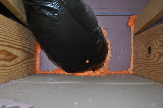

At the top of the wall, the existing air barrier membrane was never sealed to the vent channel installed under the roof sheathing—again, exposing the fiberglass to wind-washing. So when we notch the foam board around the top chords of the trusses, we seal the edges to the vent channel as well as to the trusses.
They seal the foam board to the framing with gun foam, sealing duct
penetrations at the same time.
They seal the foam board to the framing with gun foam, sealing duct penetrations at the same time.

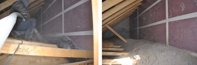

A BLANKET FOR THE DUCTWORK
As I mentioned earlier, the ductwork for a bonus room tends to be the longest duct run in the home, and it’s usually only insulated to R-4.2. The airflow in the ducts suffers from friction losses, and the air loses heat to the cold attic space as it makes its way to the room. So after we seal up the insulated air barrier for the bonus-room knee wall, we install a thick blanket of cellulose insulation around the duct. This helps keep the supply air coming into the room nice and warm. We put about 10 inches of insulation on all sides of the duct—including below it—for a good R-30 to R-40.
With the new foam-board air barrier in place and sealed with gun foam and tape, the crew augments the insulation wrap on the flexible heating duct with an additional 10-inch blanket of blown cellulose.
With that done, all we have to do is go back out through the hole in the wall, nail the OSB sheathing back in place, staple the housewrap back onto the wall, and tape the housewrap seams. Then we reattach the vinyl siding, and we’re done. It’s a one-day job; start to finish, the whole job typically takes about three hours for each side of the room.
Then the carpenters nail the cut-out section of wall sheathing back in place, and reattach the housewrap and seal the seams with tape.
Finally, they replace the vinyl siding, leaving no visible trace that any repair ever happened.
