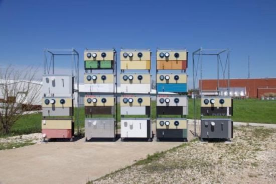

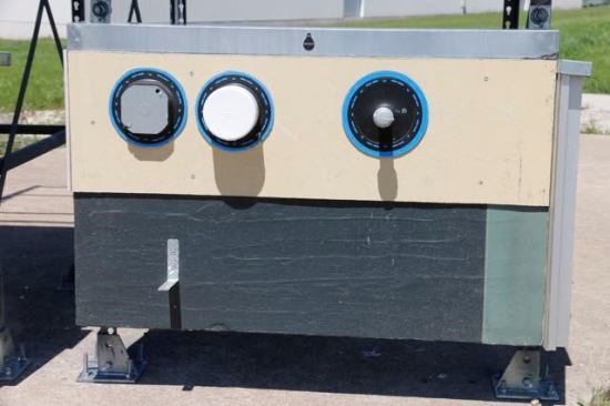

This is a companion blog post to the video I shot at the University of Texas Construction Durability Lab. Please watch the video before reading this post. Next, here is the link to the official results published in the trade journal Construction Specifier.

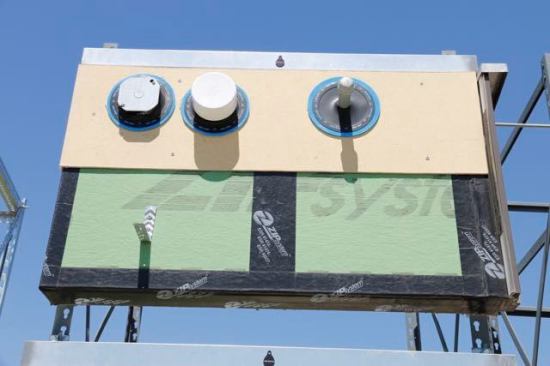

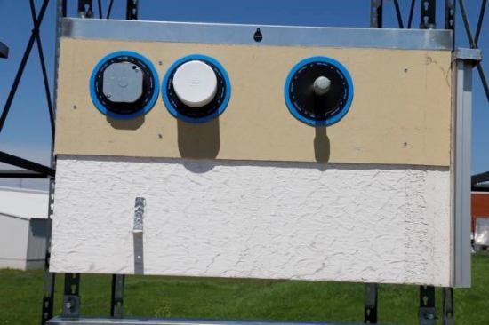

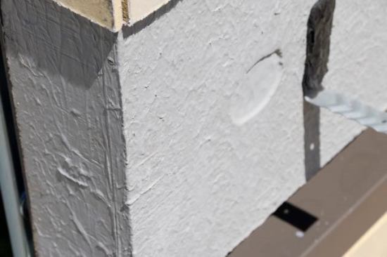

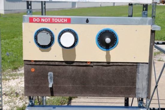

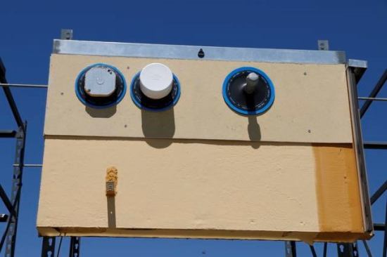

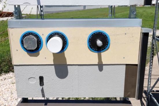

OK, you’ve seen the video and you are asking, who’s the winner? First, a disclaimer: I’m not an official member of this team, and this post is simply my observations and my inferences.

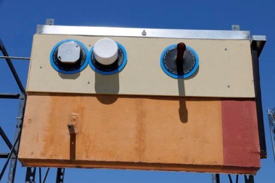

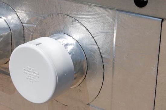

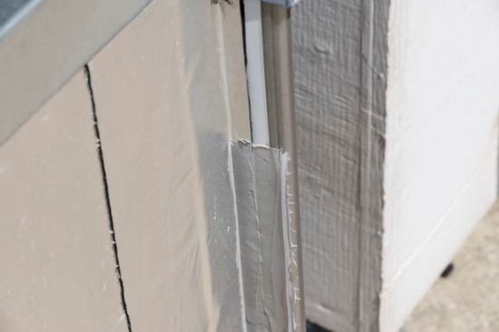

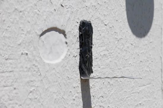

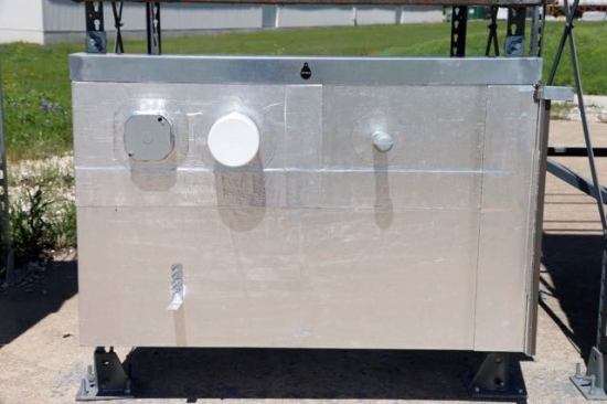

So, who is the winner? There is no clear winner here. I think the takeaway from this video and the experiments at the UT Durability Lab is that you choose your WRB based on your exposure.
Houses with lots of exposure need more-robust WRBs. If you are building a commercial building, that likely means a thick-mil Fluid Applied WRB. I’d pick one that is faring well in this test. I would personally stay away from the thin-mil WRBs; the fact that the team didn’t even test the thin versions tells you something.
If you are building a single-family residence with 2-foot overhangs and little exposure, then the more “basic” housewraps will work for you if you detail them and install them correctly.
