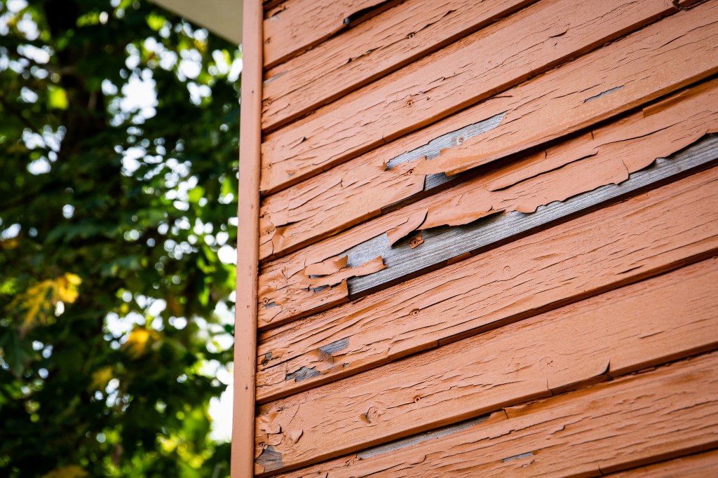

Paint problems with wood sidings are nothing new. But complaints have increased in recent years in homes retrofitted with blown insulation. The problems have occurred with numerous types of sidewall insulation: cellulose, fiberglass, tripolymer foam, and others.
Similar problems have turned up in new houses where wood siding is installed over rigid-foam sheathing. Not only is the paint peeling in some of these homes, but the siding itself is cupping, warping, splitting, and in some cases, falling off the walls.

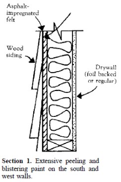

1. Houses with extensive peeling and blistering paint on the south and west exteriors. These houses also had some mold and mildew on the other exterior faces. The houses were typically 15 to 30 years old, and had no siding problems until they were insulated one or two years ago. It did not matter whether the insulation was blown cellulose or blown fiberglass. The typical wall construction was wood siding over asphalt-inpregnated building paper and asphalt-impregnated fiberboard. On the interior, some houses had foil-backed drywall, while others had regular drywall. (See Wall Section 1.)

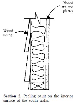

2. Houses with extensive peeling paint on the interior surface of the south walls. These houses were 50 to 60 years old and the problems occurred within one to two years of blowing the sidewall full of insulation. Typical wall construction was wood siding directly on studs, covered by an interior finish of wood lath and plaster. (Wall Section 2.)

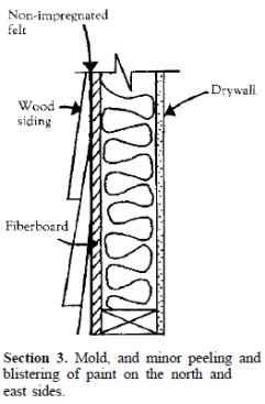

3. Houses with minor peeling, blistering, mold, and mildew on the north- and east-facing siding. These houses were 20 to 40 years old and had no siding problems until one to two years after insulating. The walls were wood siding over non-impregnated felt building paper over 1/2-inch fiberboard (some asphalt-impregnated, some nonimpregnated). The interior was standard unbacked drywall. (Wall Section 3.)

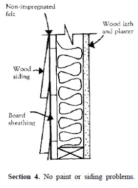

4. Houses that had no siding or paint problems on any side before or after insulating the sidewalls. These houses were 30 to 50 years old and had wood siding over non-impregnated building paper over rough-sawn board sheathing. Lath and plaster finished the inside. (Wall Section 4.)

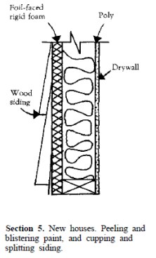

5. New houses, one or two years old, with peeling and blistering paint and cupping and splitting siding, primarily on the south and west. Construction was wood siding directly over foil-faced isocyanurate or extrudedpolystyrene sheathing. The insulating sheathing was nailed to 2×4 or 2×6 studs, which were covered on the interior with 4- or 6-mil poly under 1/2-inch drywall. The stud cavities were insulated with fiberglass. Between the siding and rigid insulation, some houses had impregnated building paper and some Tyvek, although most had no paper. (Wall Section 5.)
In every case we examined, we found moisture or signs of moisture between the laps of the horizontal siding and/or between the siding and the sheathing Also, in all cases the cavity insulation and cavities were dry, regardless of the insulation type.

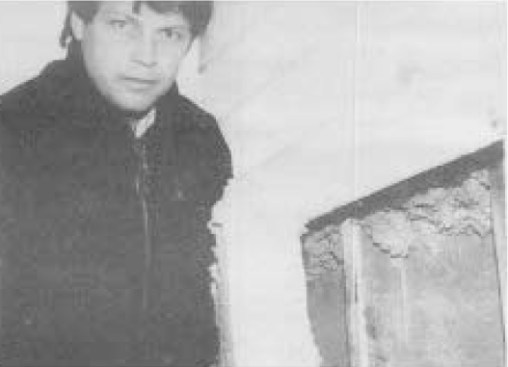

In Category 1, the moisture problems were the worst. The nails in the sheathing and siding were often seriously rusted, and the exterior surface of the fiberboard and the back of the siding were often saturated, mildewed, or rotting. The portion of the nails inside the studs, however, was fine, as were the interior surfaces of the fiberboard sheathing.

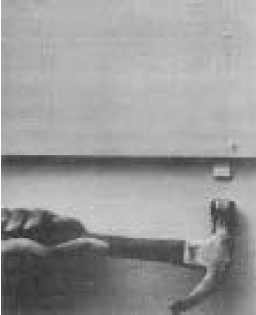

Although the paint was peeling and the siding was soggy on the west face of a Category 1 house, the author found the studs and cellulose insulation bone-dry.
In Category 2, there was no sheathing and only a little, intermittent moisture between the laps in the siding.
In Category 3, the symptoms were similar to those in Category 1, but to a much lesser degree.
In Category 4, the one with no problems, only traces of moisture were found in the laps. The rough-sawn sheathing had no visible moisture.
In Category 5, the moisture was concentrated between the siding and the insulating sheathing. The exterior face of the siding was generally dry, but the back was either wet or had signs it had been wet. The wall cavities and fiberglass insulation were dry.

Case One. In Category 1, prior to insulating, moisture had always found its way into the walls from both internal and external sources. Regardless of the source, the moisture accumulated toward the exterior of the wall—but dried to the outside before problems occurred.
After insulation was added, however, the drying potential was reduced enough to cause paint problems. These were worst on the south and west because of the effects of solar radiation. Although the sun dried the outside surface of the siding, it also drove moisture back into the asphalt-impregnated sheathing, where it was stored. At night, when the vapor drive reversed, moisture condensed in voids behind the paint—and broke the paint film the next day when the sun heated the surface. The sun helped make the voids in the first place by repeatedly stretching and shrinking the wood and paint.
Case Two. The story is essentially the same in Category 2, except that when the sun drove the moisture inward from the back of the siding, there was no impregnated paper or fiberboard to slow down and retain it. So the moisture went right through the wall unobstructed, and caused paint problems on the interior.
Case Three. In Category 3, the critical difference was the non-impregnated building paper and sheathing. Because these materials are fairly permeable, the moisture on the south and west was driven deep enough into the wall that the exterior remained free of paint problems. However, the lack of sun on the north—and to some extent on the east—allowed enough moisture to accumulate to cause minor mildew and paint problems.
Case Four. In Category 4, the roughsawn wood sheathing kept the houses out of trouble, because of its permeability and ability to store moisture. The water readily migrated into the wall under the influence of solar radiation and was safely stored in the sheathing, away from the back of the siding.
Not enough moisture accumulated to cause problems within the wall system. Furthermore, when the vapor gradient changed during the night, the moisture moved outward again. In each cycle back and forth, some of the water dissipated to the exterior, eventually drying out the wall. This same dynamic applies to Category 3.
Case Five. In the buildings with impermeable foam sheathing, the source of moisture had to be the exterior—rain and capillary effects. Since the water could not penetrate the wall, it wetted the back of the siding. When the sun heated up the outer surface and tried to drive the moisture inward, uneven drying led to cupping and other problems. Also, the insulating effect of the wall cooled the exterior, thereby reducing its drying potential.

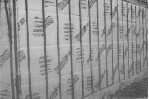

In new construction, you can do this by installing wood siding over furring strips. This is essential over impermeable sheathing, but can dramatically increase paint and siding life over standard sheathing as well.
Use furring strips when installing wood siding over foam sheathing. An air space behind the siding is essential over impermeable sheathing, but can dramatically increase paint and siding life over standard sheathing as well.
