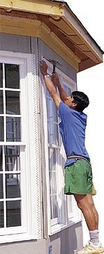

Figure 1. USG’s water-managed system uses Durock cement board over a moisture-resistant drainage plane. Any water leaking past the stucco skin is directed to weep holes at the bottom of the wall. Instead of rigid foam board, DuroScreen uses Durock cement board and other components to create a drainage plane between the sheathing and the stucco skin, allowing any water that penetrates to escape.

After fixing more than 40 of these EIFS-clad homes in the Greensboro, N.C., area, I’ve concluded that all EIFS replacement projects have one thing in common: The total damage can’t be determined until the house is stripped of the EIFS, so there is no way to price the job ahead of time. The most vulnerable places are always around windows and doors, and where first floor roofs meet second floor sidewalls. After a visual inspection, we can use a hand-held moisture meter with long probes to determine how much of a given wall is involved. We’ll do three “snake bites,” penetrating the foam first directly below the problem area, and then down the wall in 1-foot increments. Moisture content above 19% in the underlying structure spells trouble. I charge by the hour to do the initial investigation, then provide a fixed price per square foot to remove and replace the EIFS with a water-managed system. All repairs to the structure are handled separately on a case-by-case basis, and the scope of work and cost can vary wildly, depending on the extent of the damage.
