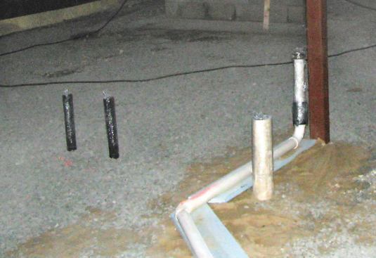

Preparing for SPF insulation under a slab involves most of the same preparations you would do before pouring any slab. The substrate should be well-compacted and fairly smooth. Subslab plumbing should already be in place (radiant tubing excepted), especially if it needs to run below the substrate, which is typical for disposal lines. Drainage systems, sumps, and radon ventilation systems should also be installed before spraying. And all columns, posts, and other point loads should already be transferred directly to appropriate foundations or footings. That may seem obvious, but more than once we’ve found this important detail overlooked when we show up to spray.
It’s important to mask anything you don’t want foam in or on. The fine overspray gets on just about everything in the immediate vicinity, hardens rapidly, and is extremely difficult to remove. Any surface, equipment, or hard-to-move tool that you don’t want permanently speckled requires a protective covering. Plumbing stubs and similar projections should be thoroughly covered. We use a variety of materials for masking, including tarps, tape, plastic sheeting, trash bags, and plastic food wrap. We always do our own masking, but it’s a good idea to confirm who’s doing this work so there’s no misunderstanding on spray day. It’s also wise to clearly mark the intended top-of-slab height on foundation walls. That way, any possible discrepancies can be caught before the insulation goes down.

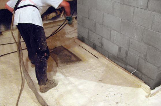

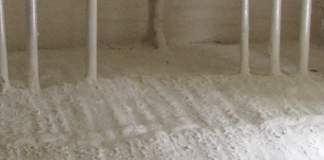

Spraying a large, flat expanse is a bit different than filling framing bays. Big open areas are fairly straightforward. Application usually begins in the middle of the slab area and works out to the edges. We spray the foam in 1-inch lifts. Thickness is determined by the size of the spray tip and by how quickly we apply the foam. The overall quality of the job depends mostly on the skill of the technician. An experienced applicator can lay down a smooth, uniform coat of foam that is relatively flat (we consider plus-or-minus 1/2 inch close enough). High spots are pretty easy to trim down with a hand saw.

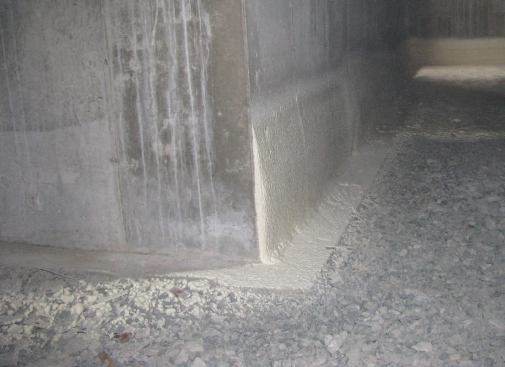

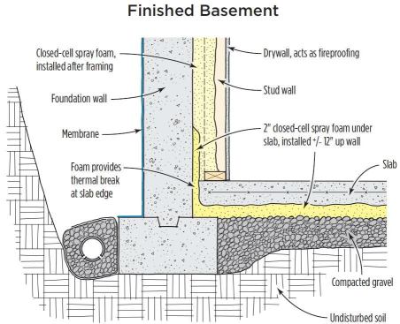

Edge treatment. The slab perimeter calls for especially careful work. The greatest heat loss occurs at the edge of a slab, making a thermal break at this juncture critical to good performance. On a standard basement slab, we use one of two details at the perimeter, depending on whether the basement will be finished. If framed and finished walls are planned inside the foundation, we’ll roll the foam about 12 inches up the walls. Since we often return after the framing is completed to insulate the foundation walls, we can simply tie the wall foam in with the slab insulation. The framing cavities can then be either left open or insulated with open-cell foam or other insulation. Building codes typically require exposed foam insulation to be covered by a thermal barrier. In a finished basement, drywall meets this requirement.

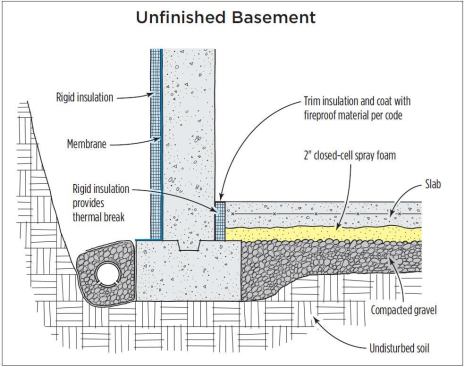

Unfinished basements call for a different approach. We insulate the perimeter with 2-inch foam board, ripped about 1 inch wider than the distance from the footing to the top of the finished slab. After placing this board around the entire perimeter, we spray up to it. The SPF locks the board in place as it expands, with no need for mechanical fasteners. Once the slab is poured and hardened, the foam board can be trimmed flush with the surface or left protruding. We use a similar approach in slab-on-grade construction where the slab is flush with the top of the stem walls. In the unlikely event that a building inspector requires a thermal barrier over this narrow strip of exposed foam, we can cover it with a spray-on intumescent coating, such as Flame Seal TB (713/668-4291, flameseal.com).

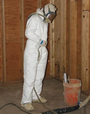

Protective measures. The liquid foam blasts out of the spray gun under high pressure and quickly fills the air with fumes and atomized particles. Working in this environment can irritate the lungs and mucous membranes, so we require anyone entering the installation area to wear respiratory and eye protection. Our technicians work in full protective gear with supplied-air respirators, which deliver fresh air through an external pump and hose.
The installation area should be effectively isolated from adjacent spaces. In basements, we use plywood scraps and plastic sheeting to close stair holes and any other openings in the floor, like duct cutouts and plumbing penetrations. We always use a ventilation fan to depressurize the work area, so that fumes are exhausted to the outside while fresh air is drawn in.
It’s safe to enter the area about an hour after spraying. We do insist that no other work be scheduled in the basement on the day of an SPF application, and we post all entrances, notifying workers that respiratory protection is required in the spray zone. And to avoid accidental ingestion of foam particles, we don’t allow any smoking, eating, or drinking anywhere near the area.
