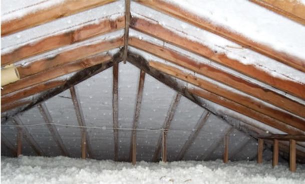

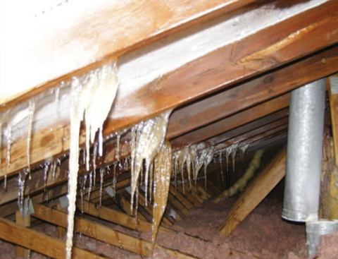

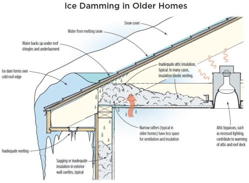

Ice dams form when heat from the house escapes into the attic and warms the roof enough to melt snow on top. (For simplicity’s sake, I’m using “attic” to refer to any area between the heated interior and the roof deck, including traditional storage attics, roof truss cavities, and spaces in rafter bays above cathedral ceilings.) Because hot air rises, higher areas on the roof tend to be warmer than lower areas. Snow in contact with roof surfaces with temperatures above 32°F will melt. When that snowmelt flows downslope to a colder part of the roof – typically the eaves, but not always – it refreezes. As this freeze-thaw cycle recurs, a ridge of ice develops and traps water on the roof. That water frequently leaks into the home, damaging walls, floors, ceilings, insulation – not to mention the homeowner’s sense of tranquility.
Although ice dams are the result of a complex interaction between the snow cover on the roof, the outdoor temperatures, and the heat-loss characteristics of the house, a typical recipe might look like this: Moderate to heavy snow is followed by daytime temperatures of 15°F to 25°F. Mix in a dash of rain or dramatic temperature fluctuations and you have the perfect storm.
Why 15°F to 25°F? Because when it gets much colder than that, the average home, at least in our area, has enough insulation to prevent the roof deck from warming to the point where snow melts. Conversely, when temperatures reach into the 30s, the snow on the roof melts away too quickly for it to refreeze.
In theory, preventing ice dams is simple: Keep the roof surface cold. That means good air-sealing to prevent warm indoor air from leaking into the attic; enough insulation to prevent conductive heat losses; and adequate ventilation, to allow any heat that does make its way into the attic to mix with outdoor air before it warms the roof sheathing.

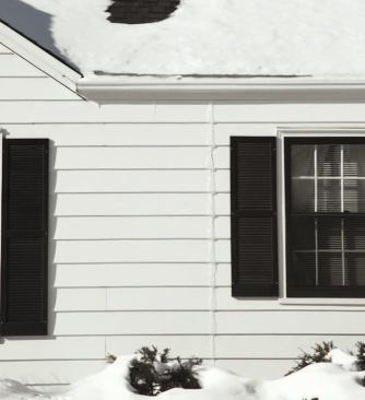

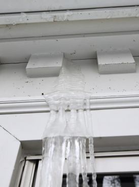

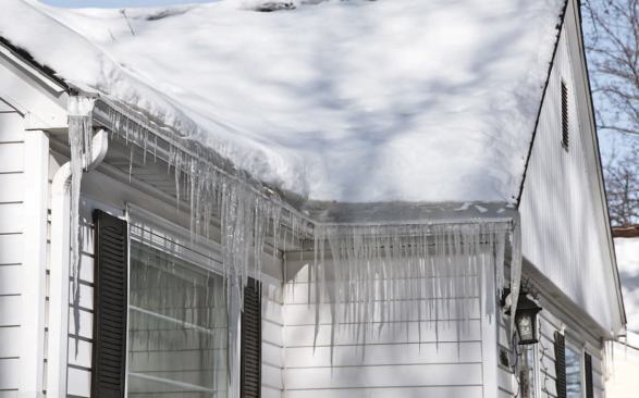

Myth #2: Ice dams happen only at the eaves. While most ice dams do form at the eaves, about 20 percent of the ice dams we deal with are in less obvious locations, including:
Valleys. I’ve seen ice dams grow 12 feet up valleys, where they force water under the shingles and valley flashing high up on the roof.
Shed dormers, roof pans, or other low-pitch areas. Ice dams can cover large areas on low-slope roofs and cause major leaks without ever forming those telltale icicles. We have removed ice dams that were invisible from the street yet covered an entire shed roof or pan area. In general, lower pitch roofs suffer more from ice dams than steep roofs do.
Roof penetrations. We see mini ice dams around all types of roof penetrations, including skylights, bath fans, chimneys, and plumbing vents. These are extra sneaky because they are virtually invisible from the ground.

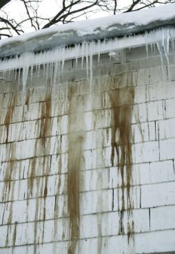

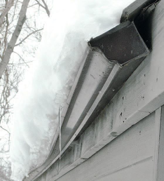

Myth #3: Ice dams are related to gutters. The fact is, gutters do not cause or even increase the severity of ice dams. We remove ice dams from many homes without gutters every year, and in the past 20 years I have seen no compelling correlation between gutters and ice dams. Because ice weighs almost 60 pounds per cubic foot, however, ice dams can certainly damage gutters.

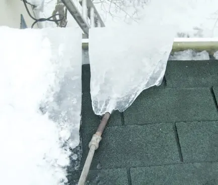

Myth #6: Heat cables are the answer. Electric ice-melting cables installed at the eaves are sometimes appropriate as a last resort, but only after you have taken the other measures described in this article. And be warned: Cables can also create problems. For instance, they can cause leaks if the ice around the cables melts but there is no way for water to drain to the ground. Heat cables can also dry out asphalt shingles, causing them to become brittle and crack, thus voiding the shingle manufacturer’s warranty. Most heat cables last only a few seasons, giving homeowners a false sense of security. And of course heat cables at the eaves do nothing about ice further up on the roof.

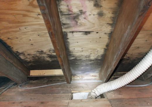

Although a surprising number of contractors neglect air-sealing, it’s perhaps the most crucial step in preventing ice dams. Warm air will always find a way to get through the ceiling plane and into the attic. These leaks are called thermal bypasses, and the goal of proper air-sealing is to minimize them as much as possible. The good news is that most bypasses can be sealed with a trained eye, a can of spray foam, and a little elbow grease (see “Air-Sealing Attics in Existing Homes,” 2/08). First you have to find them. The best way to detect bypasses – and indeed to figure out the overall thermal behavior of the house – is to conduct a heat loss study. This can involve blower-door tests, infrared cameras, and other specialized inspection equipment. For the client with an adequate budget, a blower-door test is a great first step. Fortunately, most bypasses should be obvious to an experienced remodeler even without these sophisticated methods.
In the attic, look for gaps around bath and kitchen exhaust fans, plumbing vents, recessed lights, plumbing and wiring penetrations, and attic hatches. Top plates at partition walls are another source of leaks. We usually pull back the insulation at these spots and seal them one at a time. On some older leaky homes, we completely remove the deteriorated insulation, then seal the leaks and reinsulate the attic. By placing a few 500-watt halogen lights in the rooms below the attic, we can quickly find the major bypasses by looking for light pouring through the gaps.

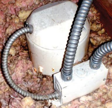

Recessed lights. The recessed ceiling lights in many older homes aren’t IC-rated, so they can’t be directly covered with insulation. These lights can throw off enough heat to cause snow-melting problems by themselves. At a minimum, we advise the homeowner to switch to compact fluorescent bulbs, which produce far less heat than incandescents.
The best remedy is to replace the old fixtures. If that’s cost-prohibitive, we cover them with site-built rigid-foam insulation boxes made from 3/4-inch foil-faced insulation board. (These boxes are also available at some insulation supply shops.) For fire safety, we make the boxes big enough to leave 3 inches of air space around the fixture, then place them over each fixture and seal them to the top of the ceiling vapor barrier with standard silicone. Even IC-rated fixtures are seldom airtight, and can add plenty of heat to the attic, so we often cover them with insulation boxes as well.

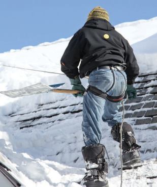

When to remove snow from the roof depends on the house: Some homes can handle 10 to 20 inches before we worry; others can start having problems at 2 inches. It also depends on what we can negotiate with the client. In some cases they might want us to come out only when there’s a snowfall of more than 4 inches. Or they might like to receive an e-mail whenever conditions are right for ice dams.
Snow can be removed with roof rakes, a stiff broom, and a plastic shovel. It’s important to use plastic rather than metal to lessen the chance of damaging the roof shingles. In most cases – though it’s more expensive up-front – I recommend removing all the snow from the roof rather than just the bottom few feet. After all, it’s the snowmelt from the upper half of the roof, where the warm air in the attic collects, that feeds the ice dam.

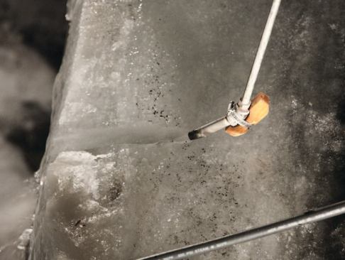

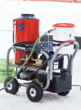

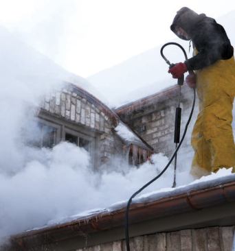

Our company has been using commercial steamers for over 20 years. When used properly, steamers are very effective and totally safe for roofs. Even so, I’ve seen terrible damage done to homes by inexperienced users. Steamers are powerful but finicky machines. The problem is that you’re running cold water outside in a hose, and unless you know what you’re doing, that water is going to freeze and ruin your $5,000 steamer. Over the years we’ve modified our machines to keep everything running in the cold, using a system that allows us to flush the steamer with anti-freeze between jobs. We collect and reuse the anti-freeze with each cycle.
Another simple modification we made was to clamp a piece of oak to the bottom of the steamer wand. Though the wand can heat up to 300°F, the oak keeps it off the roof surface so that it doesn’t mar the asphalt shingles. We use the steamer to undercut the ice dam and to slice it into blocks about 12 to 18 inches long, depending on the thickness. Then we gently pick up each block and throw it off the roof, making sure there is nothing or no one below (the blocks weigh 40 to 60 pounds apiece).
