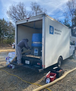

For our first dense-packing project, we began with a lower material-feed gate setting than we’d use with cellulose, on the advice of the manufacturer. This is because TimberFill’s post-manufacturer wood fiber is thicker and chunkier than cellulose’s more processed post-consumer fiber, and it tends to lock together more quickly. When you are getting a feel for your production, it’s important to start slow and gradually dial up to a higher material flow to avoid hose clogs. While this slowed us down at first, it didn’t take long to find the best setting.
TimberFill comes tightly packed and requires a bit of pre-conditioning when being loaded into a smaller electric machine, whose agitator may lack the torque and blade count of a larger PTO (power take-off) driven machine. This prep consists of peeling chunks out of the bag and breaking them down a bit with a stick, not unlike breaking up ground beef in a pan. For larger machines, most bags can be thrown in whole, but TimberHP advises paying attention to the material and breaking just the harder-packed bags into chunks first.

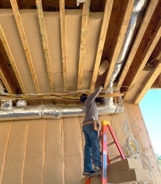

Our main TimberBatt project was a 1,100-square-foot ADU (accessory dwelling unit) above a detached garage, including a vaulted ceiling, exterior walls, and floor system, plus some interior walls for sound attenuation. The clients were interested in a product with higher performance values than fiberglass, but they also highly prioritized environmental impact and allergen friendliness. They were excited to select TimberBatt when we told them about its thermal resistance, negative carbon profile, flame and pest resistance (owing to its nontoxic borate additive), and relatively benign polyolefin-based binding agent. We were also secretly pining to try it out.
In our jurisdiction, located on the edge of climate zones 3 and 4, building departments require R-38 in ceilings, R-19 in floor systems, and a full cavity in exterior walls. For this project, TimberHP’s R-22 TimberBatt, at 5½ inches thick, was the only product we ordered for the thermal envelope. A single layer met the requirement for the floor system and exterior walls, and a double layer in the vaulted ceiling gave us compliance there (combining the R-22 batt with TimberHP’s other thermal batt, an R-14 at 3½ inches thick, would have left us just short).

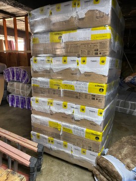

We used roughly 3,600 square feet of material to insulate all these surfaces. At only 20 square feet of coverage per bag in the R-22 format, this amounted to about 15 pallets drop-shipped to the site and unloaded using the general contractor’s rented telehandler. By contrast, the same amount of fiberglass would have fit into our single-axle 12-foot box truck with room to spare, while mineral fiber might have taken two loads in that truck. The three-bay garage space under the ADU proved to be a critically important staging area, allowing the material to stay in the dry without obstructing the working area above.

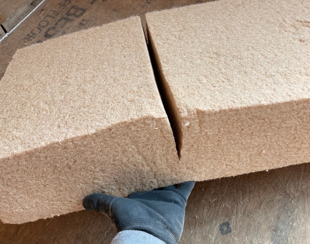

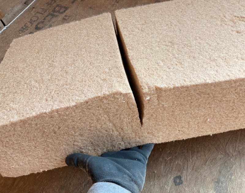

This brings up the biggest practical difference separating TimberBatt from other materials: It is the least compressible batt we’ve ever used (even after TimberHP reformulated it to make it squishier than the first iteration). This characteristic touches on staging space, material handling, cutting, and installation.

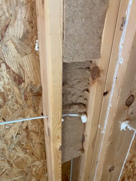

Pulling that first batt off the stack gives a seasoned insulator a fresh feeling. It’s firm and consistent, conveying stability. Once handled, cut, and installed, it felt friendlier to the body than other materials do. Being wood, the airborne fibers generated during work feel more like sawdust and don’t work their way into the skin like fiberglass or mineral fibers do. The way the dust drops out of the air and smells of pine makes the working environment feel healthier than with fiberglass (one should still wear a dust mask, though).

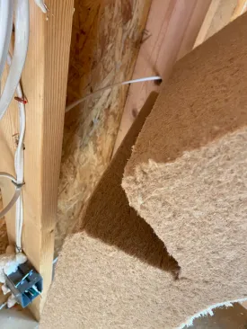

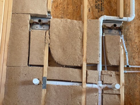

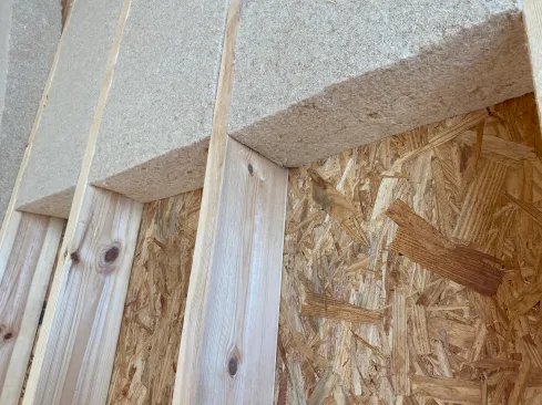

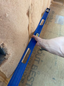

Inserting the batt into a clear cavity framed on a good layout is a smooth, satisfying experience yielding a confident friction fit. Slightly narrow or wide cavities present a challenge. A more compressible product yields more forgiveness for how oversized a batt can be when we’re balancing ease of installation against friction fit. TimberBatt demands to be cut precisely straight and square and no more than ⅛ to ¼ inch wider than its intended cavity—any wider and it fights you. Cutting and notching the material around electrical and plumbing obstructions is familiar to those accustomed to mineral-fiber insulation, but if your background is fiberglass, you may find it slow and tedious. Sawing with a serrated knife is required, as opposed to slicing with a straight blade as you would with fiberglass—and tolerances are tighter.

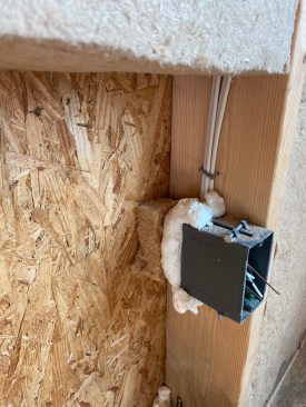

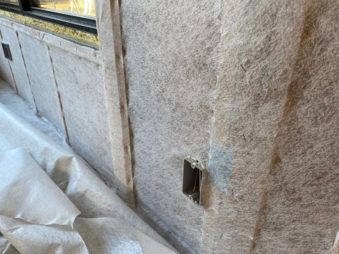

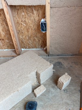

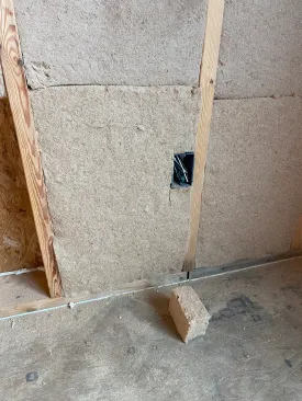

Wires are easy enough to let into the back of the batt with a mid-depth kerf cut. Electrical boxes are easily hogged out by notching the negative space out of the batt and slicing the cutout to depth to slip behind the box before inserting the rest of the batt around it. The material’s resilience and consistency allow you to sculpt it around the curves and angles of pipes with all the grace of Michaelangelo much more readily than a softer material would, but such artistry comes at the cost of time. Subtracting the right amount of material front-to-back is critical, as leaving too much in the cavity results in a bulge that can overcome the stiffness of the drywall and leave a wave in the wall. There’s almost no forgiveness here. If the insulation doesn’t lay flat over mid-cavity obstructions naturally, it will not be persuaded with pressure.

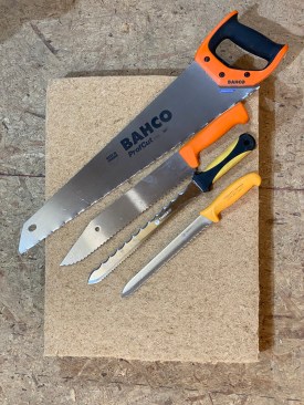

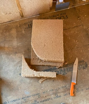

We were glad to have a variety of knives for different uses. A Bahco stone wool saw was best for long, straight rip cuts and crosscuts, with a Hultafors insulation knife running a close second. TimberHP’s private-label serrated knife was best for the detail cuts around electrical and plumbing. A Mora stone-wool knife, my personal favorite for mineral fiber, did not perform well with TimberBatt.

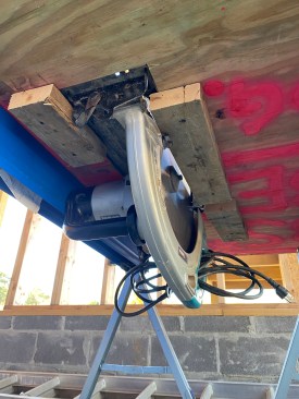

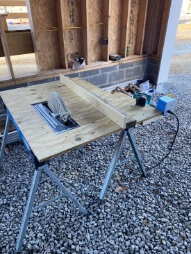

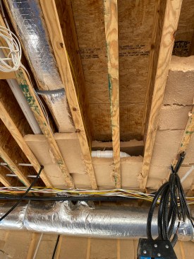

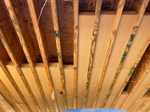

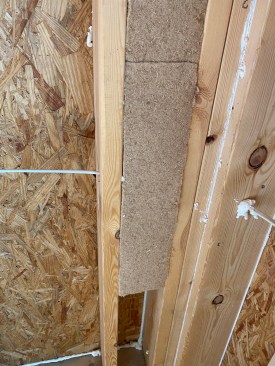

The vaulted ceiling and the floor system both required hundreds of production rips. The structural vault rafters were furred down to deepen the cavity using ¾-inch-thick subfloor scrap as gussets in the first and last 4 feet of each run, requiring us to subtract about 1 inch from the batts’ 15-inch width—a challenging hand cut with a knife. The floor system was framed with TJIs on 12-inch centers, creating an average cavity width of 11½ inches. To maximize efficiency with all these repetitive rips, I let the shoe of a 16-inch beam saw into a piece of ¾-inch plywood, mounted it upside down on sawhorses, and put a receptacle and switch between it and the power source, creating a makeshift jumbo table saw able to slice the batts’ entire 5½-inch thickness in a single pass. With scrap 2-by material and clamps acting as a fence, we could make perfect rip cuts quickly—a great relief to production time and forearms.

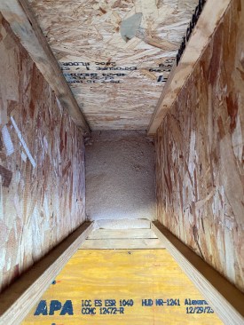

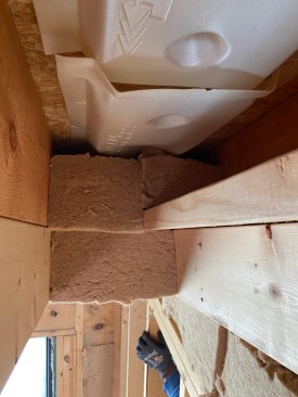

The I-joist profile gave us an opportunity to use up scrap cutoffs as vertical insulation along the floor system perimeter. We had dozens of slices whose width matched the height of the joist chords, and others that matched the height of the web. Production crosscuts of these slices made pieces we could quickly insert into the ends of each joist bay, reducing waste and bringing the thermal layer down to the bottom of the floor system, which is where we elected to run the floor insulation to avoid numerous electrical and plumbing obstructions in the upper half of the floor diaphragm.
A handful of cavities were inaccessible for this stiff batt product, such as rafter and floor cavities mostly above wall plates and only open from below by a few inches. We had to dense-pack those cavities, which is important to note for anyone considering using TimberBatt who may not have access to insulation blowing equipment—and no, the rental equipment available at the box stores is not sufficient for dense-packing.

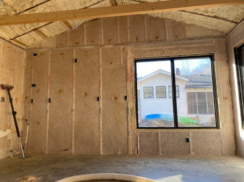

At the end of the project, the payoff is an extremely pleasing sight of matte khaki-toned insulation perfectly flush to framing edges, warmly hugging the objects sharing space in the cavity. Embracing the stiffness of TimberBatt is key to success—use it as your ally in achieving an incredible-looking Grade 1 job, and you’ll see how the TimberHP products deserve strong consideration for a premium, high-performance insulation package.
