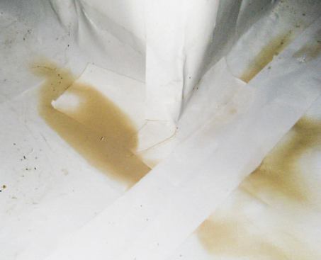

I don’t actually venture into the crawlspace too often. But a couple of years ago, while installing a new dryer vent pipe, I discovered a puddle on top of the liner. Closer inspection revealed that water was entering at the taped seams, then flowing and pooling at low points. The ground below the liner was saturated enough that the liner was actually floating in some areas. I took the thriving frog population as evidence that I had a chronic problem on my hands.

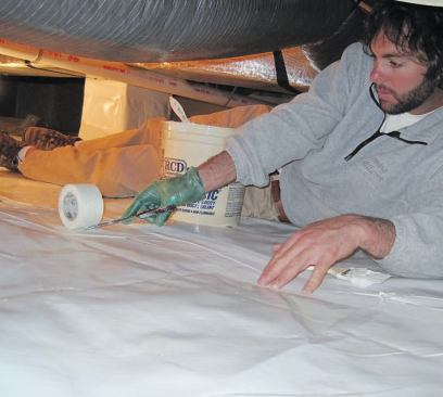

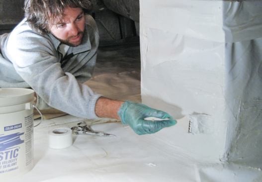

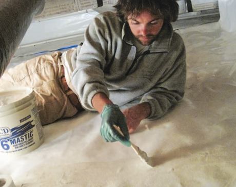

But by this point I had lost faith in tape as a suitable method for seaming polyethylene in the presence of both water and dirt. So I contacted the building scientists at Advanced Energy in Raleigh, N.C., who have extensive experience with conditioned crawlspaces (see “Building a Sealed Crawlspace,” 10/03). They suggested that I use duct mastic to seal the seams, specifically a fiber-reinforced product called RCD #6 (rcdmastics.com). Described by the manufacturer as a “fibrous adhesive sealant,” RCD #6 is a high-tech mud typically used to seal joints in ductwork, but it can also be used for joints in insulation boards and vapor retarders.

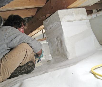

Being naturally dubious, I first bought a one-gallon container, along with some self-adhering fiberglass mesh tape made for drywall joints. Armed with a few inexpensive paint brushes, I squirmed into the crawlspace to do a test. I patched about 10 feet of seam, as well as the cuts around a couple of block piers, then retreated to observe the results. After watching for several of the rainiest months on record, I was convinced: The test area held tight, so I got serious about finishing the project and recruited a friend — local builder Scott Gaston — to help out.
