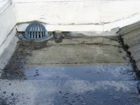

We were called into this large custom home in Rancho Santa Fe, Calif., by a water-remediation company that was already at work on another portion of the home when a rainstorm blew in and caused some new leaks. Before making any expensive repairs, the remediation crew wanted to make sure they knew what they were facing.
As you can see from the visual image (see slideshow), there was some moisture damage on the ceiling, but it seemed to be limited to that one location. But in the thermal image, it’s obvious from the darker areas that the water had in fact traveled all the way to the floor. When we went up on the roof, we found that ponding was occurring because an overflow drain at the parapet wall was improperly installed. This was a leak waiting to happen.
