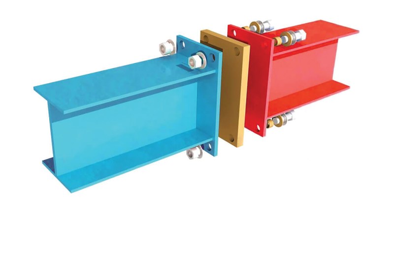

A thermal break material can reduce energy transfer through a steel balcony support.

Q: What is the best way to reduce thermal bridging from a cantilevered steel beam protruding from a building for a balcony or canopy? We aim for high-performance enclosures and have been applying closed-cell spray foam along the length of the beam inside the structure, but we are not sure this completely mitigates the energy loss from this massive member conducting heat through the enclosure.
A: Marc Forget, associate editor of JLC responds: Any piece of steel that’s projecting through a building’s shell is a thermal bridge that degrades the overall value of the enclosure’s insulation. “It becomes even worse,” Kohta Ueno of Building Science Corporation explains, “as you add thicker and thicker insulation levels. You have a tighter bucket, but you have slit the same big hole in it.”
According to Ueno, the ideal way to address the thermal bridge is with off-the-shelf structural thermal break products made by Schöck, Armatherm, and others. For a steel-to-steel connection, these are typically made with a high-density plastic pad that interrupts the steel beam at a bolt-through connection. This requires you to create your cantilever with two segments of steel—an interior section and an exterior section. Is this weaker than the typical unbroken, through-steel cantilever? “Absolutely,” Ueno responded. “The beam must be designed by your structural engineer to account for that.”
If the structure is already built, and a steel cantilever protrudes from the building, a 2-inch-thick coating of closed-cell spray will reduce the transfer, Ueno said. He compared it to wearing a mitten in winter; it’s not ideal, but your hand will be warmer for wearing the mitten. “However, this solution, or coating the steel with an aerogel-incorporated paint, is only going to be as good as it is maintained or protected,” Ueno cautions. “If decking is applied without care, or if [the insulation is] left to the elements, its performance will degrade over time.”
