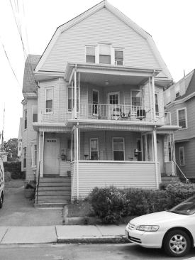

The house is a two-family Dutch colonial built in 1908. It has two apartments totaling about 3,200 square feet. Though previous owners had replaced the siding, its thermal performance was dismal. The wall cavities were uninsulated, as were most of the third-floor ceiling cavities. The gambrel rafters had some loose batts, and there was spotty cellulose in the attic ceiling. Space heating was provided by an overworked pair of natural-gas boilers and distributed by steam radiators, with domestic hot water from 50-percent-efficient standing-pilot tank-type heaters. Blower-door tests showed that both units leaked at around 3,500 cfm.

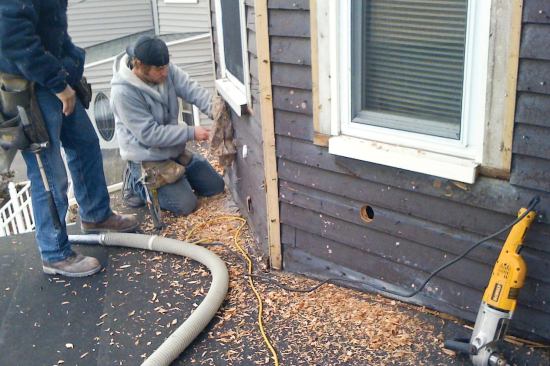

The first step was to have a cellulose contractor dense-pack the uninsulated 2×4 wall cavities from the exterior (see slideshow). Then, after stripping off several layers of existing siding, we covered the 7/8-inch board sheathing with a carefully lapped and taped layer of HardieWrap weather barrier. To head off air infiltration between the framing members in the window openings, we also lined the rough openings with strips of HardieWrap, which we sealed to the housewrap outside and to the interior plaster on the inside.

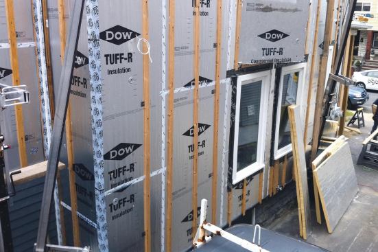

Next came two layers of 2-inch foil-faced polyiso board and a single layer of 1-inch, with the seams between layers staggered and sealed with Dow Weathermate tape. We used as few screws as possible for the first two layers, but screwed the top layer to the sheathing with a roofing cap at each corner. Finally, to provide a ventilated nailing base for the fiber-cement siding and to better secure the foam, we fastened vertical 1×3 strapping through all three layers and into the studs with 8-inch-long roofing screws.
The outer layer of foil facing serves as the drainage plane and a primary air barrier; the housewrap, now buried under 5 inches of rigid foam, acts as a secondary air barrier.
