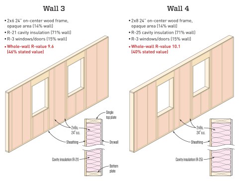

Framing depth. Let’s start with the framing. Specifically, what happens when we increase the framing depth from 2×6 to 2×8 at 24 inches on-center?
As Wall 4 shows the increase in frame depth provides more insulation value in the cavity, but it doesn’t change the whole-wall R-value much. The important point to understand here is that even though the cavity insulation R-value increases in a fatter wall, the R-value of the stud is only minimally enhanced, and more importantly, the stud remains a thermal bridge.

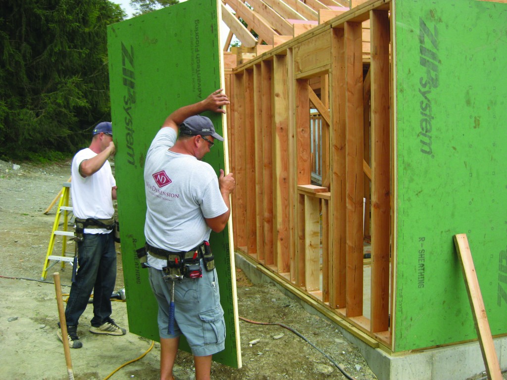

Continuous insulation. What’s the next level of improvement? The wood-framed opaque wall areas with cavity insulation areas account for roughly 85% of the wall. If we step outside of the frame to the exterior and add rigid insulation, we not only add R-value, enhancing the cavity insulation, but we also shut down the thermal bridges created by the framing, which greatly enhances the R-values at the opaque areas. Walls 5, 6, and 7, shown in the illustrations above, show what happens to the whole-wall R-value of the first three walls when we add continuous insulation.
By using continuous insulation, we increase the whole-wall R-value. The thicker the continuous, the greater the increase. I am a big advocate for continuous insulation in any climate where we purchase energy to improve our interior environment. Its benefits also extend into realms of durability, health, and comfort. (In this article, we are focusing on energy performance, but it’s important that we acknowledge the other critical performance factors that are affected by the energy performance of the wall, and which we can discuss in detail at a later time.) The interesting takeaway here is found when you compare images: Wall 5—a 2×4 wall with R-3 continuous insulation is arguably the same wall as Wall 2—a 2×6 16-inch-on-center wood-framed wall—at least from strictly an R-value perspective. But the science of our walls is not quite complete. Like insulation, windows offer a spectrum of performance. Let’s see what happens when we alter the window performance in some of these walls.

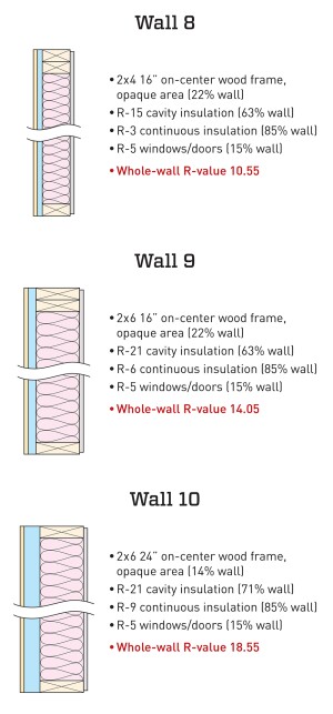

Window options. Note that in all instances in Walls 5, 6, and 7, the window and door openings—at 15% of the wall—were the worst performing part of the wall.
Compare those whole-wall R-values to the last three wall examples: Walls 8, 9, and 10 (see illustrations, above). Notice that what we are doing is improving the wall proportionally. By addressing the largest areas of the wall first, we make incremental improvements, and as we do so, the smaller areas (in this case, our window/door area) become more and more important. Addressing the windows and doors once we have addressed the opaque and cavity areas leads to the best wall performance. So we start with insulation—a good thing—and then advanced framing is a preferred option that makes insulation look even better. Continuous insulation will always be a good choice. And better windows make sense, but only after we attack the higher-proportion areas of the wall.
