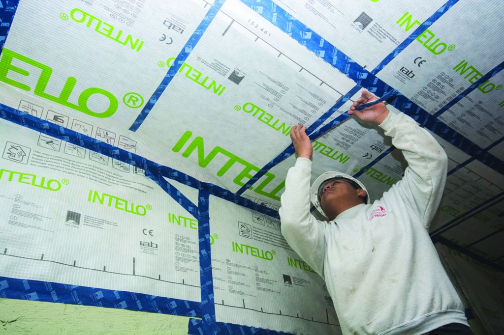

A technician for J’s Custom Contracting installs Intello smart vapor barrier on the ceiling under the low-slope roof of a Brooklyn, N.Y., row house. Flat roofs, which are tricky to vent, are one case where smart membranes can be problem solvers.

And for tricky situations, builders now have a new class of materials to work with: the so-called “smart” or “intelligent” vapor retarders. Several products in the market today have “variable permeability”—they are relatively vapor-closed when exposed to air that is relatively dry, but become increasingly vapor-open when exposed to more humid air. CertainTeed supplies a smart vapor barrier called MemBrain. ProClima manufactures two smart vapor barriers, trademarked Intello and DB. And Cosella-Dorkin has plans to introduce another product—trademarked Delta-Sd-Flexx—in this class to the U.S. market next year (along with a reinforced version of the material called Delta-Novaflexx).

For other situations, builders may prefer to spec Intello because of its wider range of response. Based on industry data, Intello closes down tighter than other products in dry conditions and opens up wider in humid conditions—which may be required in some cases to sufficiently prevent wall wetting and allow wall drying. If you’re in a situation where the difference between Intello and MemBrain is significant, however, you’d be well advised to have an expert analyze your assembly using an advanced simulation software such as WUFI, to give yourself some confidence that the results are going to be what you intend.
