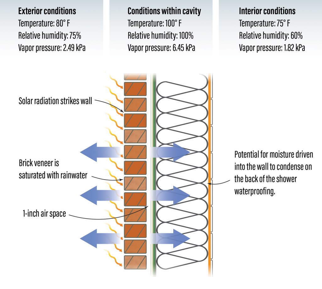

Illustration of the movement of vapor in a typical wall assembly
Building Science Corp., adapted by Ola Kwiatkowska

The other possible failure in any climate zone is when you have a brick veneer wall with inward vapor drive. Brick soaks up water like a sponge. When the sun hits the brick, vapor moves both inward and outward (see illustration, above), but the vapor drive is blocked by the waterproofing system used on the shower walls. Theoretically, this could be a problem if the vapor condenses on the back of the shower enclosure. But in practice, it is extremely rare that problems develop—perhaps if the shower wall was completely impermeable, as you might have for a steam shower enclosure. But again, reported failures are rare.
