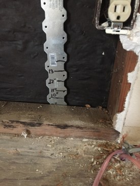

Working from the inside, the author probed with a strap tie to reveal the worst leaks in the house at the bottom plates.

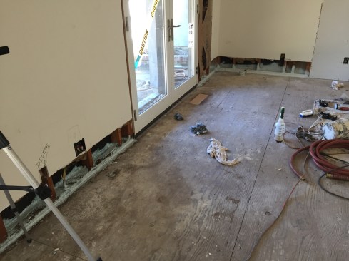

At one place, where an exterior door was being replaced, the complete path of the air leaking into the wall cavity is revealed.

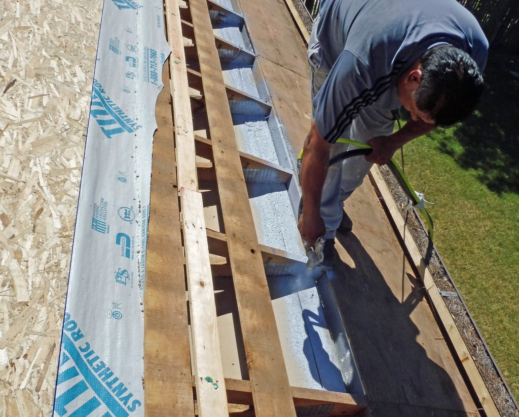

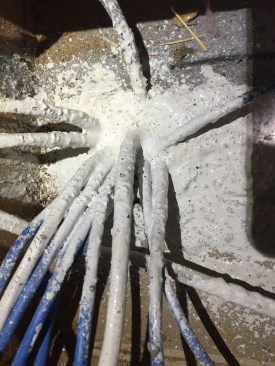

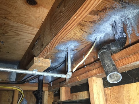

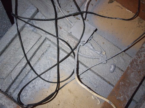

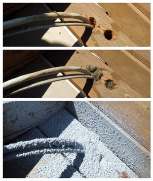

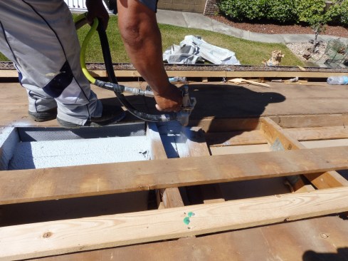

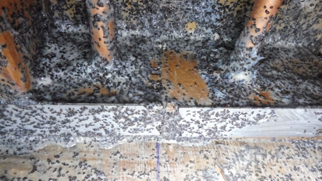

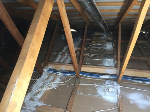

After years of messing around with different formulas and applicators, I came up with one system that will air-seal most leaks that come up in new or retrofit work. It is fast and nontoxic, works for all leak types, and emits no VOCs. It is a vapor-open (7.5 perms) rubberized latex (elastomeric) mixed with fibered granules that can be sprayed onto surfaces with a texture gun.
In this article, I’ll demonstrate how this new sealant works. On the particular job shown here, using entirely my formula, I’m air-sealing a classic 2,000-square-foot stucco ranch built in 1979 in climate zone 3.

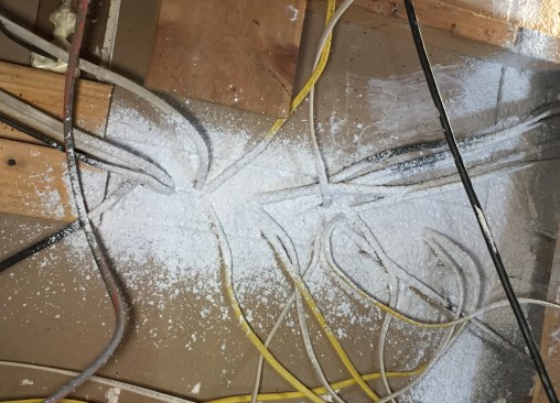

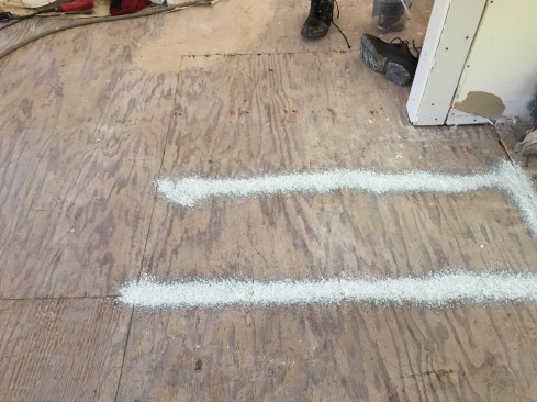

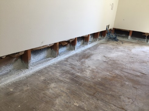

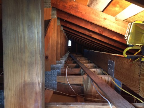

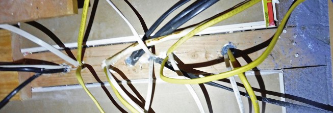

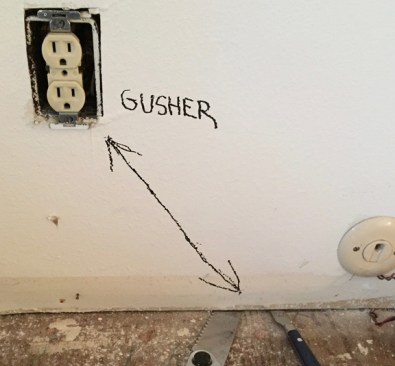

There are many ways air can leak in and out of a building. In this house, almost every switch and outlet box leaked air during a blower-door test, as did much of the baseboard and penetrations through the floor into the crawlspace. But the source of the greatest leakage was at the top and bottom plates.

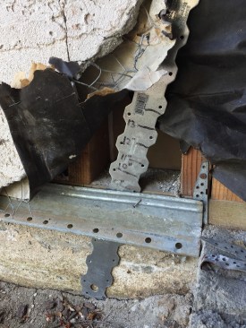

The stucco was to remain, so we had limited access to seal the bottom-plate leaks at their source. Partial demo gave me insights into how the house leaked and ideas on how I might shut off the leaks. For example, along part of the exterior wall, we were able to slip a 16-gauge Simpson strap 7 inches behind the bottom plate shown in the photo above; it exited outdoors between the stucco and framing. This gap provided an easy path for air leakage. Elsewhere, a section of stucco was removed for a new door, revealing the exact pathway of this bottom plate leakage: air flowed behind the weep screed, between the building paper and the plate, and into the wall cavity.
In another area, I was able to slip a pruning saw under the bottom plate to reach the back of the stucco, which directly connected to the exterior. During a blower-door test, I held my hand 6 inches away from the outlet and the bottom plate and could feel air coming out.
The photos and captions in the two slideshows describe how I implemented what I put in the proposal, and what the owner agreed to pay for, to correct these and other leaks.

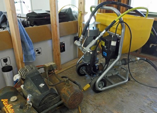

You can spray the elastomeric using a small hand-held hopper gun with an air hose attached. It delivers the material well, but the fluid will spill out of the hopper if it is tilted much more than 45 degrees. The hopper also has a limited volume capacity of less than two gallons.

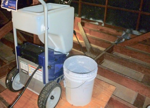

I have used several full-size spray machines to deliver the elastomeric sealant. The Benron shown below (left) is a quiet workhorse. It is lightweight and portable (but requires a separate compressor), can handle a 100-foot garden hose, and can pump strongly until the cows come home. Benron is discontinuing this exact model but will soon come out with the Rotortex19- 245 Pro, available with or without a compressor. Davlin (davlincoatings.com) will be selling the Rotortex 245 setup the way it works best with my product. (Please note: I do not make money or commissions on what Davlin sells.)
The Graco RXT 1400 (below right; also available from Davlin) is light, noisy, and portable, and does a fine job. It is limited by its 25-foot hose but will fit through a 24-inch opening. Graco also makes the RTX 2000 (not shown), a heavier-duty rig that accepts a 50-foot hose.
The Benron is lightweight and portable but requires a separate compressor.

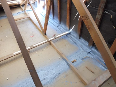

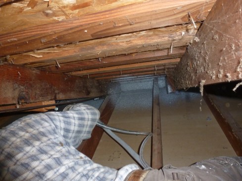

You get only one shot at air-sealing during retrofit or new work. After the stucco was originally installed on this house, access to the leaks was sealed up, and the leaks remained unaddressed for 38 years. We were able to significantly correct that, however. Before any work was done, we tested-in using a blower door with a whole-house air leakage of 11.2 ACH. The job tested-out near completion at 3.6 ACH.
The entire job took two people three days, and we used 24 gallons of elastomeric spray. Most of the work was in the attic, which took two guys one full day and 21 gallons of elastomeric. Because of the volume and throw of the material, we were able to cover potentially leaky areas in hard-to-reach places that typically never get fixed with other sealants. Actual spray seal time (covering the target) is very fast. What usually takes the most time in an attic is maneuvering around with the hose and gun. Another time factor is setup and cleanup.
