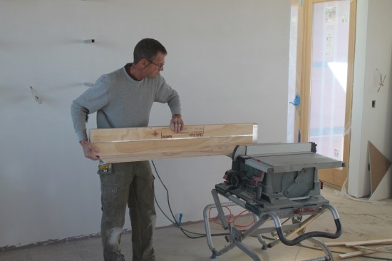

The panels come either as singles or bundled together accordion style. If a single panel is needed, it can easily be separated from the bundle with a table saw.

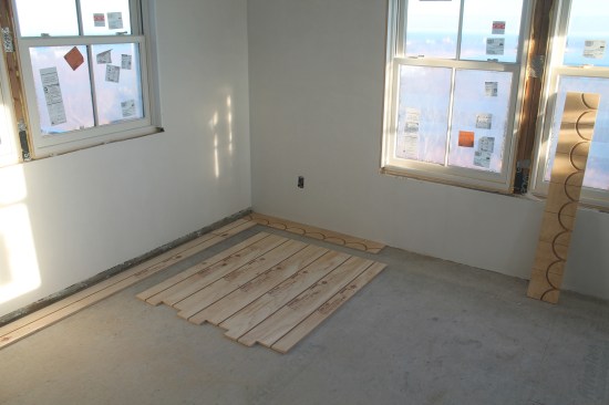

After the reference lines are snapped, single panels are installed along one wall as a guide. Special return panels line up with grooves in the straight panels.

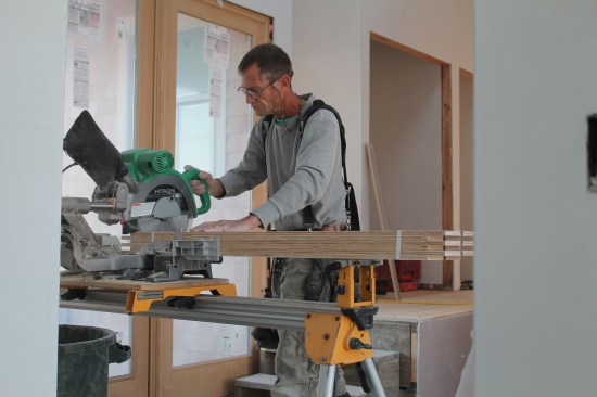

Cutting the panels to length is easy. Just set a whole bundle on the chop saw and cut six pieces at once to the proper length.

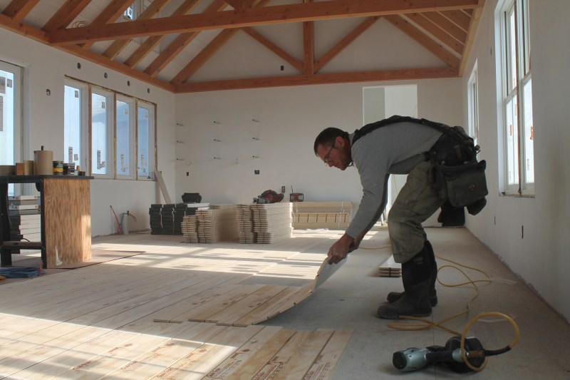

For most of my projects, radiant floor panels are installed on OSB or plywood subflooring, which I clean and scrape carefully to ensure a flat surface. I grind down any high spots and fill low spots with self-leveling filler. The panels themselves come either as assemblies of six panels attached together accordion-style, or as single panels. I usually buy only six-panel assemblies and cut singles from an assembly as I need them. There are also return panels with semi-circular loops that connect the ends of the straight runs. If I need to direct the tubing in a perpendicular direction, I cut off a quarter-turn section from a return panel or cut a smaller portion of an arc to direct the tubing at an angle.
I snap reference lines to keep the panels square and parallel within the space, and then run a row of single panels along one wall as a guide, with a return panel positioned at the end. The panel assemblies come with the ends of the panels staggered to align and interlock them as they are installed. To fit them against the return panel, I cut the ends of a whole assembly flush in one shot on a chop saw. Then it’s just a matter of working across the floor, adding panels or assemblies as needed. If I need a narrower width, I simply rip it on a table saw.

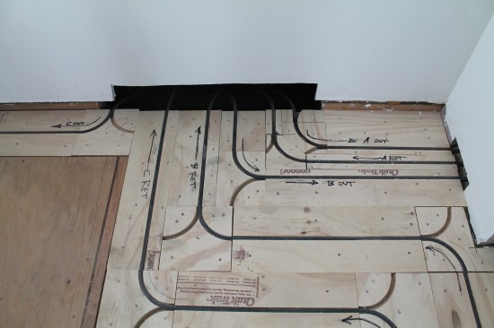

Smaller areas such as this bathroom can get complicated. To avoid confusion, the author labels the direction of all the tubing on the floor.
The panels are nicely milled, so once I’ve started straight and square, the entire installation usually goes quite smoothly. Large, open spaces go easily and quickly, but smaller, more complex rooms such as bathrooms can be challenging—often involving many runs of single widths, with lots of quarter turns and offsets. In these spaces, I often dry-fit all the panels before nailing them in, and as I install them, I keep track of the flow direction with arrows on the panels.

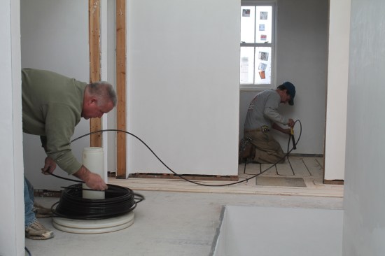

To install the tubing, one person uncoils it while another presses it into the grooves with a soft hammer handle. Occasionally, a block has to be used to seat the tubing properly.

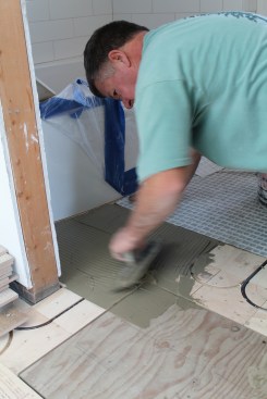

Radiant flooring panels are an excellent choice under a tiled floor. Here, the tile installer applies mortar for the separation membrane that is installed before the tile.
Once the panels are installed and all of the loop paths checked and confirmed, it’s time to install the tubing. First, the floor is swept and the grooves carefully vacuumed clean; one small pebble or stray nail under the tubing can puncture it, with a resulting leak that can be difficult to repair later. My plumbing contractor generally sends a couple of guys with a roll dispenser to install the tubing, but I find it cost effective to be on hand to help them. The tubing often needs some persuasion with a hammer and block to snap it into the grooves, and as a carpenter, I’m much better at that operation than the average plumber.
Once the tubing is installed and connected to a manifold, it can be air-tested, and then hooked up and supplied with heat. We install wood flooring directly over the radiant panels. In tiled areas, the installer puts in a cleavage membrane and installs the tile on top of the membrane. Clients are always happy with a radiant floor system. And as the contractor, we love having that warm, comfortable radiant heat underfoot as we finish the rest of the interior.
