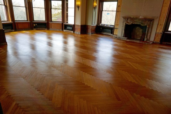

The author restored the floors in Henry and Clara Ford’s billiard room at the start of an extensive renovation to the Ford’s home, Fair Lane.

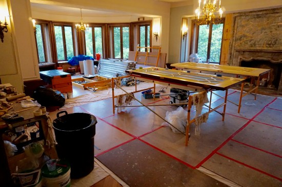

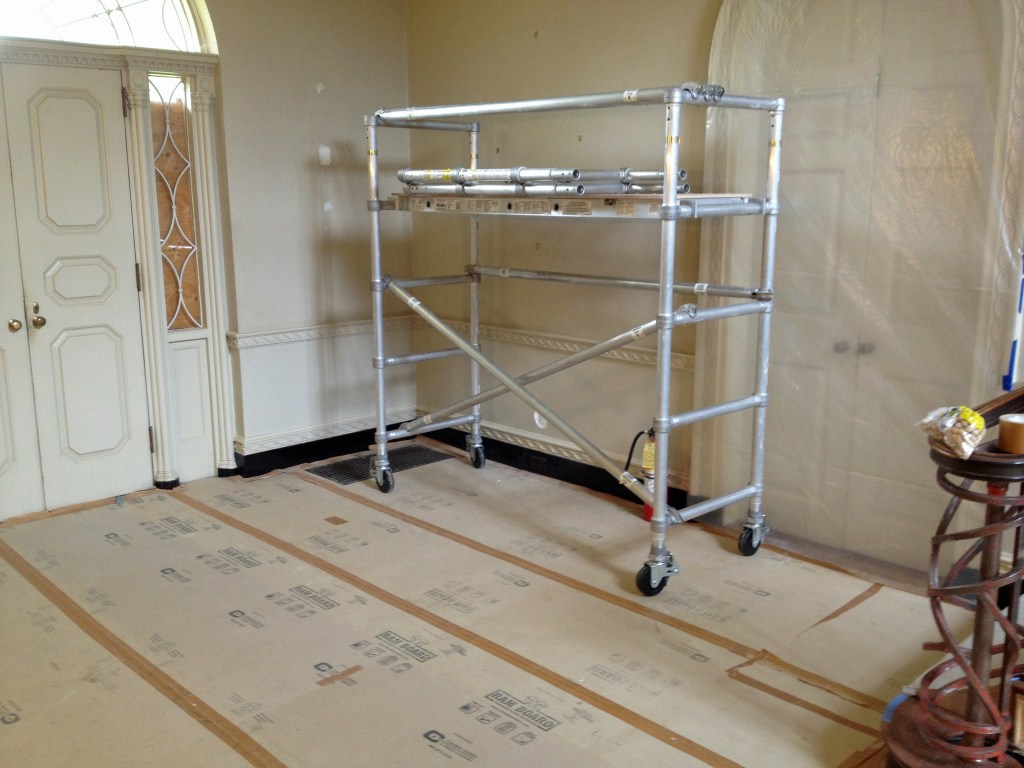

 After the floor was wrapped with paper and fully taped hardboard, the room became the staging site for the other trades.

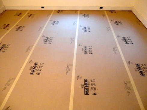

Heavy-duty, dense paper products. These were some of the earliest protective materials to come on the market. The two most well-known products that I’m aware of are Ram Board and FlexBoard by Protective Products.
The author often wraps finished floors with a dense paper product such as Ram Board,
Ram Board is sold through retail outlets, and FlexBoard is available online through the Protective Products website. Both are in the same thickness category, 45 mils, and come in rolls. For contractors, they offer different widths—38 inches for Ram Board and 32 inches for FlexBoard—that both come 100 feet in length.

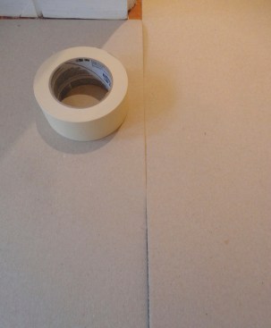

One trick is to flip the paper over so the curl faces down. Courses then butt easily and can be taped.
Ram Board offers a “home version” that’s 36 inches wide by 50 feet long and around 38 mils thick, but I’ve always used the beefier option. These are my go-to products, as they lay down easily and are quick to install.
I typically roll the paper out and then flip it over so the curled ends face down, enabling it to flatten more quickly. The side edges of the paper are precision cut, making it easy to abut the next piece. To avoid movement, I tape the long parallel edge seams for stability, running the tape continuously to keep fine particles from getting under the paper. A wide seam tape offers excellent protection from premature damage from foot traffic you find on work sites. Both Ram Board and FlexBoard provide protection from spills and contact with various types of liquids.

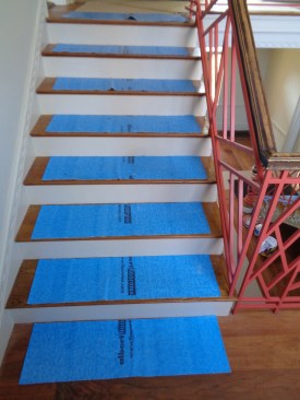

For stairs, the author prefers cushioned foam products, such as Albert Floorotex (above), which sticks without leaving residue or damaging fine finishes.

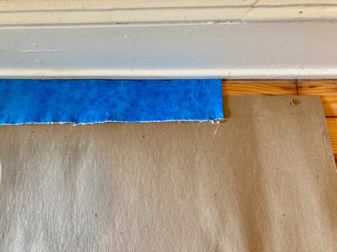

Lightweight, flexible, and cushioned polyester film. Products in this category offer some options that the dense paper products don’t. I’m familiar with two: Albert’s Floorotex and Protective Products’ Econo Runner, both available online. They come in rolls that vary in widths (40 inches for the Floorotex and 32 inches for the Econo Runner) and generous lengths. Both are flexible and have a thin polyester film on top attached to a thin cushioned material. Most important for me is the light tacky material on the bottom that allows the products to grip a surface without removing the finish or leaving a sticky residue. They both have excellent resistance to moisture, while allowing what’s beneath them to continue curing. I’ve made good use of them on freshly refinished stair treads and landings where slipping would be a hazard with a paper product.
A fabric runner, such Dura Runner, works well for walk-on and walk-off mats at entrances to minimize the tracking in of debris and moisture.
I often cut this material into 3- to 5-inch strips. When I put down the dense paper products in the field of a room, I leave a gap at the perimeter to cover with the flexible film. The film can then be pulled back to allow other trades to work on baseboards, molding, and curved surfaces.

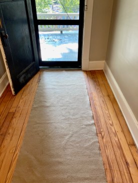

Soft fabric runners with non-slip backing. This material has multiple uses for me and all are good. The brand I am most familiar with is Dura Runner by Protective Products and I order it online. It has a felt-like surface on top of a waterproof backing that helps prevent slippage but doesn’t have adhesion.
I love to use this for walk-off mats at the main exterior entrance. I cut it into 6-foot lengths and place one outside and often another inside to minimize the amount of debris and moisture that is tracked in.
In a fully furnished home, I like to use the same length outside areas where I’m working, so I don’t track anything from that area onto antique rugs, carpeting, or other hard surface materials. Since the strips are lightweight and easily portable, I place two to three next to each other to create a protected surface of about 12 square feet for placing equipment and materials. I have had several of these walk-off mats for a long time, as you can easily clean them with a broom and take them to the next project.
Hardboard. This one is an oldie but goodie. I’ve been around so long I call it Masonite; the younger generations call it hardboard. It typically comes in 4x8 sheets, usually in 1/4- and 3/8-inch thicknesses. As with the dense paper, I abut sheets and continuously tape over the seams to help prevent anything getting underneath them. It’s the ultimate in protection and well worth the price when a lot of rough work will be done on the job, or when something heavy shows up on the project site. More than once, I have put some under a grand piano and been able to push that sucker wherever I needed to without leaving any indentations on the floor. I don’t use it often, but when I do, I’m grateful I did.

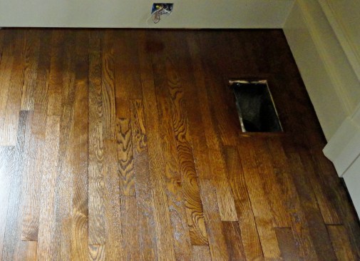

The author finished the oak floor in a master bedroom at the start of an extensive remodel to this wing of the house.

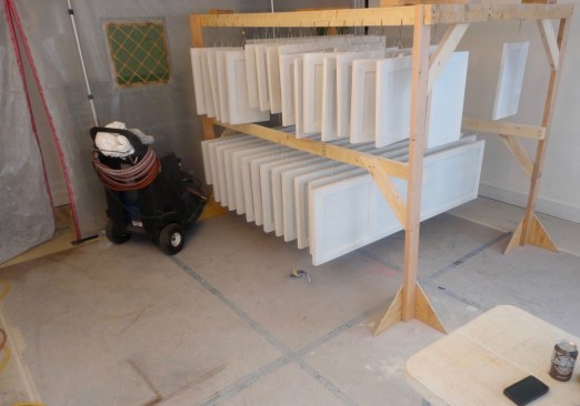

During the remodel, the master bedroom was used as a spray booth for cabinet door. The finished floor is beneath heavy paper covered with hardboard.
