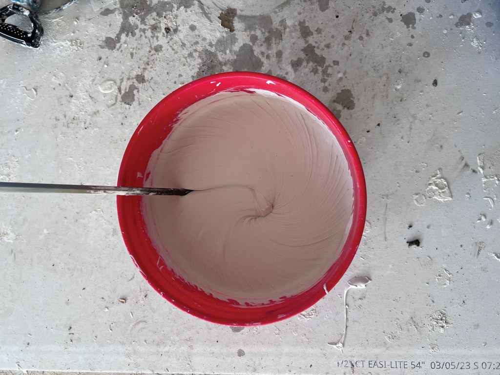

The author typically empties a box of joint compound into a 5-gallon bucket. Out of the box, the material is dry and stiff.

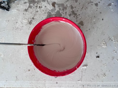

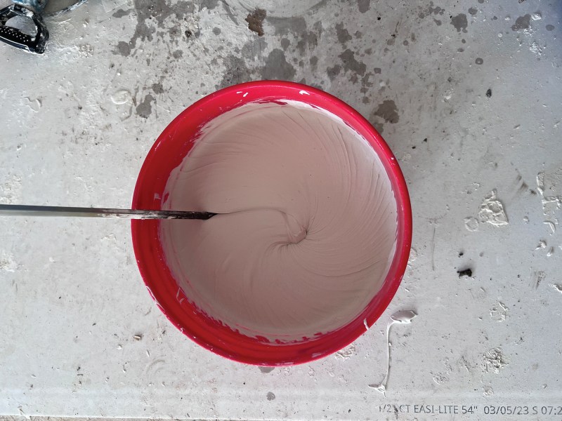

After mixing in about 1/2 cup of water, she gets a nice, smooth consistency that is vastly easier to work with.

When we mix our joint compound, we typically empty a box into a 5-gallon bucket, and then add 1/2 to 1 cup of water. We then use a mixing paddle with a mud mixing drill to stir the water in until it is fully incorporated into the compound and the consistency is smooth. Before using it, we test the mix with a knife to see if it is the right consistency and add more water as needed. If you haven’t done this before, you will likely be nicely surprised with the results: smoother joints, better workability, and a nicer finish.
