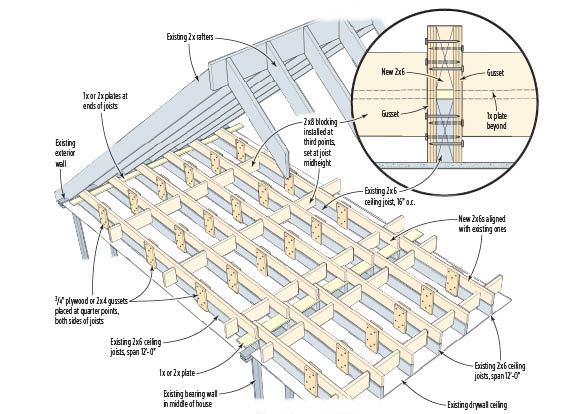

Q. I need to convert an attic to livable space with minimal disruption to first-floor habitation. The existing ceiling joists are 2x6s, clear-spanning about 11 feet 3 inches. Rather than sistering in deeper members, which would involve moving wiring, can I stack new 2x6s on top of the existing ones? This creates a 2×12 joist depth, but will I achieve an actual structural benefit from stacking members? What if I gusseted them together at regular intervals?

To achieve this doubling effect in strength and stiffness, you will indeed need to gusset the upper and lower joists together. If we use strong enough gussets and fasteners, we know that the top and bottom joists will deflect by exactly the same amount when loaded. That’s key to analyzing the behavior of the stacked framing.
I’d suggest you first run a continuous 1-by or 2-by plate across the ends of the existing joists to provide a stable base for the new joists. (That also gives you a fighting chance at a level floor. If you simply set the new joists on the old they probably won’t mate well, and any slope in the old floor will translate through to the new.) Next, gusset the upper and lower 2x6s together with 2x4s or 3„4-inch plywood. Gussets on one side only can work, but I prefer gussets on both sides so the load is transferred concentrically, preventing twisting in the joists. I recommend three gusset pairs per joist at the quarter points – one about every 3 feet. Where they connect to both the top and bottom joists, each gusset pair will transfer approximately 100 pounds – that’s 50 psf of floor load times the 3-foot gusset spacing times the 16-inch joist spacing divided by the two joists. Use six 10d nails with plywood gussets, or six 16d nails with 2x4s, half into each 2×6 joist. That’s conservative nailing in terms of the capacity of the fasteners, but it also keeps the gussets from twisting.
You may wonder how I decided on three sets of gussets per span. The more gussets you have, the more uniformly the load is shared from top to bottom; ideally, we’d like the joists to share the load equally. In this case, three gets us pretty close to a 50/50 split. The stress in the lower joist will be about 7.5 percent higher than that in the upper joist – not enough difference to justify more gussets. Let’s say for comparison that you went nuts and used nine gussets per span: The lower joist would still have 1.3 percent more stress than the upper – too much work for not much improvement, in my book. By contrast, if you used only one gusset at midspan, the stress in the lower joist would be a whopping two-thirds higher. The problem in this scenario is that all the load in the lower joist is introduced right in the middle of the span, the worst place to put it. So that’s why I chose three per span: It gets pretty close to splitting the load.
The last question I raised has to do with the stability of the floor system. Stacking joists is not nearly as stable as sistering, which braces the joists against twisting. Not so with stacked joists. Think of it like this: You can probably walk across the edge of a 2×6 joist, but if you stack the joists two high and try to walk across, your last name better be Wallenda. Blocking solves the problem. Put 2×8 blocks at the third points, set at the midheight of the assembly and bridging the horizontal joint between top and bottom joists. Toenail the blocks or end-nail through the joists to tie everything together. For slightly better bracing across the entire depth of the assembly, you could instead use 2×12 blocking or double 2×6 blocks, one layer for the top joists and one for the bottom. But 2x8s should work fine and will save labor and materials.
