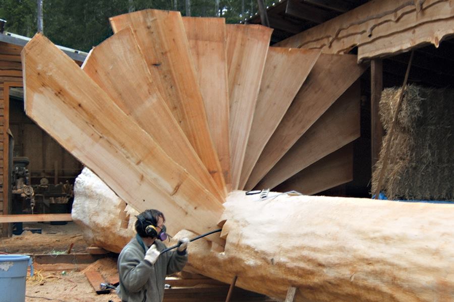

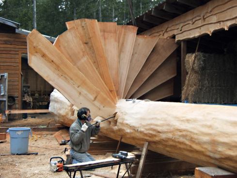

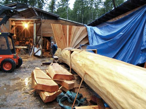

The heart of the three-level spiral stair pictured here is a 45-foot Douglas fir log measuring 2 1/2 feet in diameter at the top and more than 5 feet at the butt. Edgeley and his crew cut mortises for the treads with a chain saw - a tool that gets too little respect from woodworkers, in his view. "You can do very fine work with a chain saw," he says. The stair treads themselves were shaped from the flared stumps of red cedar trees. Each 300-pound tread was eased into position with a Bobcat and lag-bolted to the center column and the underside of the tread above.

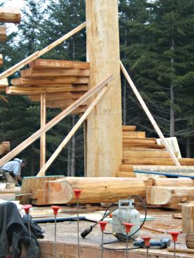

Once transported to its new home in Washington state, the center column was lowered with a crane and braced in its final upright position; then the builders reinstalled the treads. This job was made easier by the absence of a surrounding structure. (The house itself was built later, around the completed stairs.)

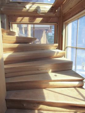

Remarkably - given the sheer tonnage of material involved and the number of projects he's done - Edgeley claims never to have run into problems with skeptical building inspectors. Most U.S. jurisdictions restrict variations between any two risers within a given flight to 3/8 inch, which would seem a tough standard for such heroically proportioned stairs to meet. But Edgeley says the issue hasn't come up, because a consistent orientation of the grain in the massive treads allows them to shrink uniformly, providing a consistent rise. Moreover, he's found building inspectors to be "reasonable people. They understand that logs are different than conventional construction. Even if you were to be a small fraction of an inch off somewhere, it probably wouldn't be hard to work out a solution that would satisfy everyone."
