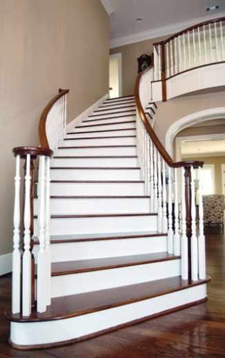

I’m not a math whiz or a full-time custom stair builder, but I still like to tackle the occasional curved staircase. I enjoy the challenge of figuring out how to build it, and I like the distinctive look that custom stairs give my custom homes.
As with straight staircases, all you really need to know to build curved stairs is the rise and run. But a curved stair has two runs: The inside stringer has a tighter radius and thus a shorter run, while the outside stringer has a larger radius and a longer run.
To keep things simple, I lay out curved stairs using only the inside radius. I also do a full-scale layout — right where the stair will be built — with a story pole and a trammel arm. I frame a pair of curved stud walls to support the treads. These walls also serve as forms for both the curved stringers and the curved handrails, which I glue up on site with bending rail.
