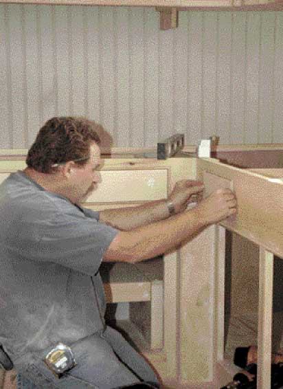

Shimless Construction
Uneven floors are a challenge. I find the highest point in the layout and establish my finished countertop height (36 inches) there. I cut and install the cabinet sides first, so I can size the panel accordingly when I encounter a low spot in the floor — a simpler and neater solution than shimming a standard-length panel. I also scribe the panel to the wall, having allowed extra width for that purpose. The scribe removes the eccentric difference between the panel’s projection when held plumb against the wall and the predetermined face line. Rather than using a compass, which can be tricky to hold absolutely parallel, I use a small wood block, ripped to the maximum width of the scribe, and trace it along the panel edge for perfect results.
