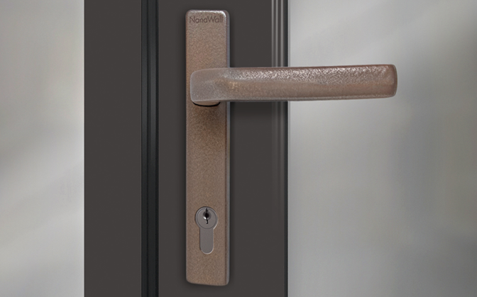

  • Nana Wall has begun offering anti-microbial copper handles as an option for their opening glass wall systems.
