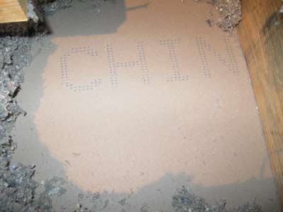

Florida appears to have been the biggest market for Chinese-made drywall in recent years. However, significant amounts were evidently shipped to Louisiana, Mississippi, and Alabama as well. In Louisiana, home inspectors Ron and Julie Hufft, of Abita Springs-based Colonial Inspection Services (985/875-7701), have sent samples for testing from a handful of houses. The homes showed the typical “red flags,” says Julie Hufft — corroded copper, drywall labeled as Chinese-made, and occasionally a sulfur odor. (“Many times, people are having to have their evaporator coils replaced several times in fairly new homes,” she says.) Testing by a Florida laboratory confirmed the homeowners’ suspicions, Hufft reports: the samples emitted the same gases found by Unified Engineering in official Florida state testing.
“Made in China” labeling from drywall in a Louisiana home. Source: Colonial Inspection Services, Abita Springs, LA (985/875-7701)
