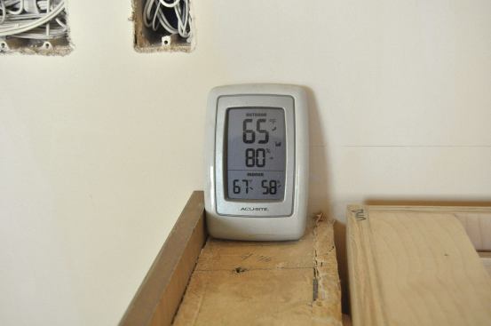

To monitor climate conditions, we place a number of temperature and humidity meters around the house. These have an outdoor sensor, which we can tape to the soffit or put outside a door or window, to keep track of temperature and relative humidity levels outside as well as inside the house. The AcuRite meter shown in the photo is reading 80% RH outdoors (top display) while we’re keeping the indoors at 58% RH (lower display). Under these conditions, the woodwork is able to maintain near 10% moisture content (MC) (see Moisture & Interior Building Materials, page 53). These meters also have a trend indicator (small arrows on display), so you can tell if outdoor conditions are trending up or down, which helps you plan your dehumidification strategy—to know if you should be paying attention to keeping equipment running or whether you can relax a little and not focus so much on that part of the job.
During the day, the house is constantly opened when the trades are coming and going. It’s not realistic for us to keep the house on lockdown all day. But as long as we can condition and dehumidify overnight, we can keep the indoor air stable. We’ll also run cooling and dehumidification equipment over the weekend. That’s enough to dry things out and allow the wood to reach equilibrium.

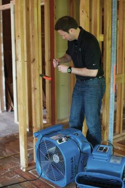

Here in the hot, humid South, the work of conditioning a job, starts with dehumidification, and that starts at the drying phase when finish materials are curing. For this we use a combination of big fans and industrial dehumidifiers.
Jobsite fans. Good commercial-grade fans start at about $300 each, or they can be rented for about $10 per day or $150 per month. I own several two-speed Quest C1000s, which draw 2.4/2.8 amps (low/high) to move up to 1,000 cfm (2,700 fpm). The Quest A3000 box fan operates in the same range, but its airflow is more diffuse.

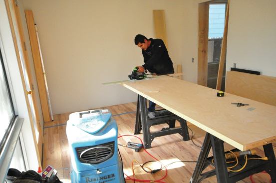

Dehumidifiers. My first industrial dehumidifier was the Dri-Eaz DrizAir 1200. This manufacturer specializes in equipment to dry out structures after flooding. I’ve been using the DrizAir for about eight years and it’s still running strong. My one complaint is that the filter clogs easily and needs to cleaned every day by blowing it off with compressed air.

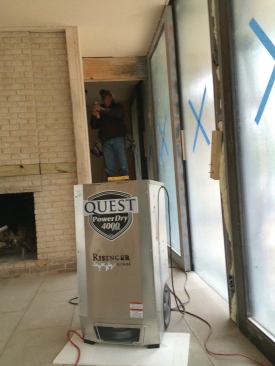

We’ve since acquired a couple of Quest PowerDry 4000s. These units can pull up to 22 gallons of water from the air per day, and treat up to 4,500 square feet of space. At the air intake, they have a pleated paper filter, which can handle a huge dust load without compromising the units’ effectiveness at drawing water out of the air.

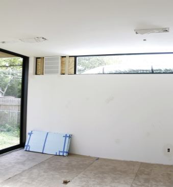

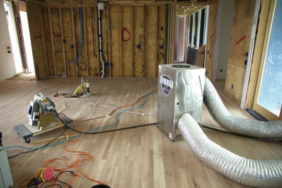

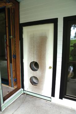

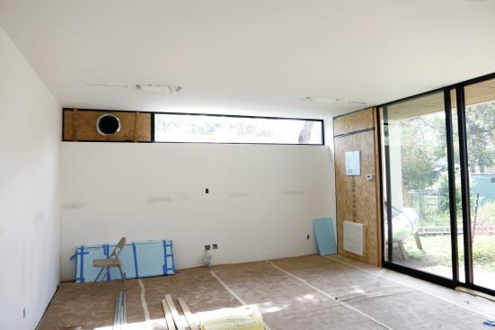

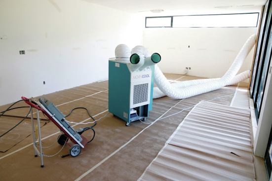

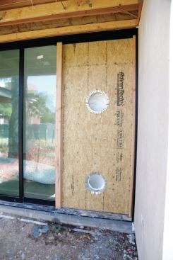

Portable cooling. The first unit we used was a Quest Cool ACS 12 (now sold as the PowerCool 12 Pro) 1-ton portable air conditioner, after which we acquired a portable 2-ton Movin Cool Classic Plus 26 unit. These are small package units, meaning the evaporative coil and the condensing coil are in the same package, so we have to duct-in air to cool the condensing coil from outside and also duct-out the hot air coming off the condensing coil. To do this, we fill the opening of a sliding door with a sheet of OSB with holes cut in it for the two duct openings to the exterior—one that pulls cool air in and one that exhausts hot air out. Or we may use a temporary swing door with cutouts for the ducts.
The cool-air supply on the evaporative side blows either out the top of the 1-ton unit or through a couple of short ducts that can be angled in different directions on the 2-ton unit. We sometimes attach a long piece of flex duct to one of these short supply ducts to move the cool air to a different room. These units only cool.

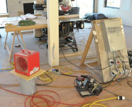

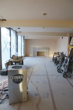

Portable heating. In colder months, we use electric resistance units. We started out with a few 19,000 Btu, 220-volt units from Northern Tool & Equipment. While we paid more at the time, they now cost about $100. They’re glorified hair dryers with a fan to push the air. The one shown here is in a house that tested to about 1.7 ACH50—reasonably tight. It doesn’t take much to make the interior comfortably warm. During the finish stage of construction, you don’t need to bring the interior up to 72°F. You only need to heat it to 50°F or 60°F to make it relatively comfortable for working in. Of course, it doesn’t get that cold in Austin (we never use more than one heater per jobsite).

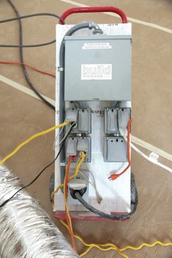

We also have a Quest Power Electric Heat EHS 31 Pro, a 30-amp, 31,000 Btu unit that warms a larger space than the little box units do. We plug it into one of several temporary power centers that I had my electricians wire up for me to roll around the jobsite as needed.
When heating the jobsite in winter, it’s particularly important to avoid the use of propane heaters. Water is a product of combustion. A salamander or a tank-top heater will add moisture to the house and can also produce carbon monoxide, creating a noxious work environment. Propane heaters are also a concern for fire. With electric-resistance heaters, we worry less about fire and will run them all day while the crew is on site, but we never leave them on overnight. But with the packaged heat-pump unit, we can leave it running overnight and over the weekend.

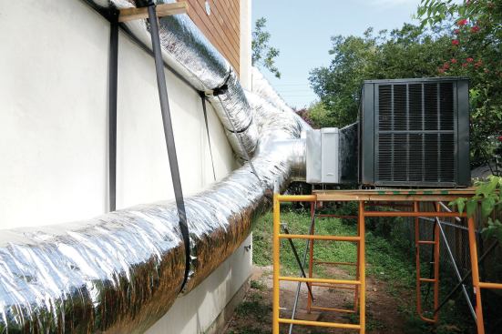

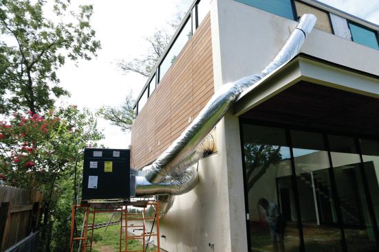

Packaged heating and cooling. We recently acquired a 5-ton heat-pump package for cooling and heating, which we set up on staging outside the house. The really nice thing about this unit is that you set it up once. There’s nothing to move around on the jobsite. With the smaller units, you end up moving them around quite a bit during the course of a job, and you have to be more concerned about locking up the smaller units while they are on site to prevent them from being stolen. And, since the package unit sits outside, we don’t need to dump the heat. It’s set up as it would be if it were a permanent piece of equipment, with a supply side and a return side, which we duct to temporary window or door openings.
