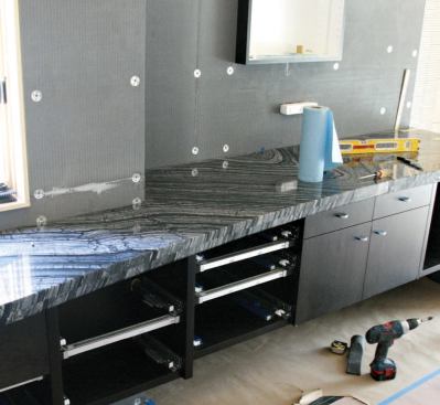

Wall-Hung Cabinets

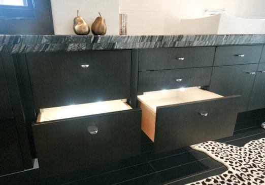

We have a fully equipped shop where we make all our own cabinets. When we know that they will be hung from the wall and will have to support a lot of weight, we build the carcases like box beams. Even though the vanity in this bathroom was over 10 feet long, we assembled it in our shop as a single unit, using 3/4-inch plywood throughout. For additional strength, the interior partitions are double layers that fit into dadoes in the cabinet back. All of the joints are screwed and glued together.
We left the framing exposed where the cabinet would be mounted so that we could fasten it directly to the LSLs with 3 5/8-inch-long LedgerLok screws. These fasteners have oversized washer heads and a lateral design value of 255 pounds in structural composite lumber. We used three fasteners per stud – plenty to support the 400-pound Kenyan marble countertop and heavy cabinet. We’ve used these construction details and screws in a number of similar installations in the past and have never had a problem with any of our cabinets coming loose or sagging.

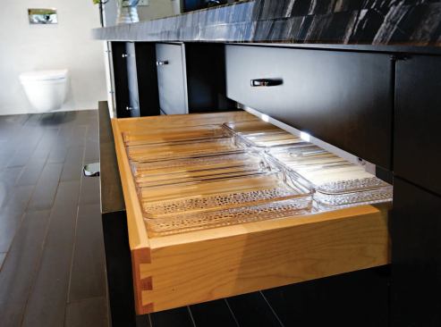

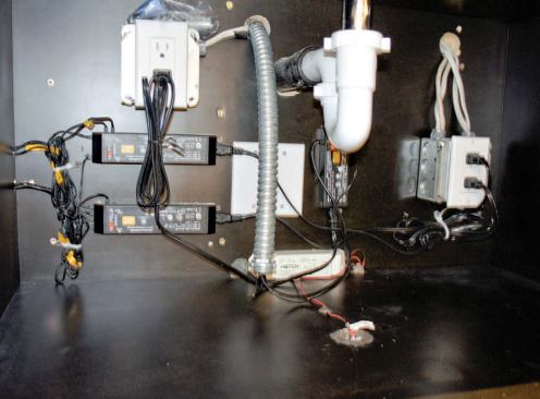

The stained maple cabinet has a conversion varnish finish and is fitted with inset doors and drawers. We mounted the drawers on Accuride Eclipse 3132EC soft-closing undermount slides ( accuride.com), which are easily adjustable – a nice feature when working with inset drawers. When the drawers are open, the slides remain concealed, while the interiors are illuminated by automatically switched low-voltage LED lighting.

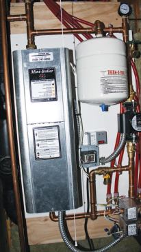

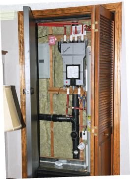

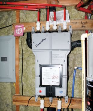

The bathroom shower has multiple showerheads controlled by a remote Moen multi-outlet shower valve. To meet the added demand for hot water, we installed an additional 50-gallon water heater connected in series to the home’s original hot-water tank. Since the bathroom is heated hydronically, while the rest of the house is heated with a furnace, we also installed a small Electro EMB-2 2.5 kw electric boiler (electromn.com). We found room for the new mechanical equipment in a spare bedroom closet located in the basement.

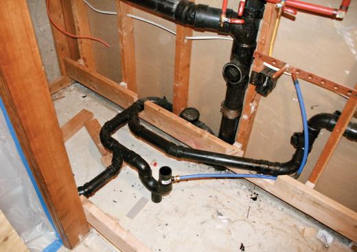

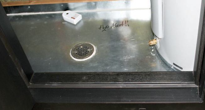

To block noise, we insulated the walls of the new mechanical room with rock wool and hung a separate solid-core door behind the closet’s original louvered bifold door. Inside the closet, we framed a new floor over the existing slab to create clearance for a drain system. We fabricated a galvanized pan for the new floor, equipped the pan with a drain and a trap primer, and tied the floor drain into the existing plumbing. In the event of a leak, water can drain harmlessly out of the closet, but there’s also a floor-mounted water sensor that will sound an alarm to alert the homeowners to a problem
