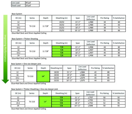

To help designers and builders avoid complaints and callbacks, Weyerhaeuser (which manufactures Trus Joist TJI wood I-joists) has developed a floor analysis system called the TJ-Pro Ratings System. The software includes algorithms that correlate floor vibration with customer satisfaction by modifying elements a designer and builder can control, including joist depth, joist span, joist series, on-center joist spacing, floor sheathing thickness, and ceiling drywall thickness. The software also correlates floor vibration with customer survey data, allowing the app to assign a customer-perceived quality rating to any floor design. The higher the TJ-Pro Rating, the greater the percentage of customers who will find the floor satisfactory.
Above is one example (for TJI 210 series joists) drawn from the output of the TJ-Pro Ratings System. Increasing joist depth or increasing sheathing thickness improves the floor response. Increasing both at once leads to a very high rate of customer satisfaction. But as the live-load deflection numbers indicate, reducing vibration requires that joists be much stiffer than required by code. Click here for a full-size version.
Rather than learn by trial and error—by building homes and then responding to callbacks—the user of this software gets a whole set of “knobs to turn” during the design phase. By knowing the home buyer’s expectation of floor performance in terms of a simple probability number, builders and designers can reliably design floor systems that are likely to satisfy the customer.

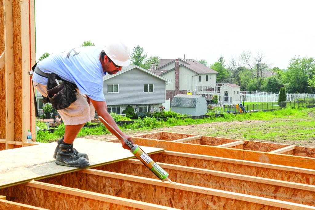

The table shown above provides an example. The base case is a floor system designed to meet the building code, with 11 7/8-inch joists at four different on-center spacings and code-compliant floor sheathing for those joist spacings. The next three cases show the results from turning two of the available knobs: joist depth, and floor sheathing thickness. As you can see, increasing the joist depth greatly improves the customer satisfaction rating. But you can achieve a comparable degree of improvement by increasing the sheathing thickness, without increasing the joist depth. And if you increase both the joist depth and the sheathing thickness, you can achieve a level of customer satisfaction approaching 100%.
The deeper I-joists and thicker subflooring panels in this improved floor system may add to the materials cost. But labor savings could counteract some of that up-charge. APA – The Engineered Wood Association is currently promoting floor designs using deeper wood I-joists at wide spacings with thicker sheathing, calling the system a “premium floor assembly.” As APA points out, such a floor requires framers to handle fewer pieces of lumber, and uses fewer tubes of subfloor adhesive and fewer fasteners than a floor with lesser joist depth and closer on-center spacing.
