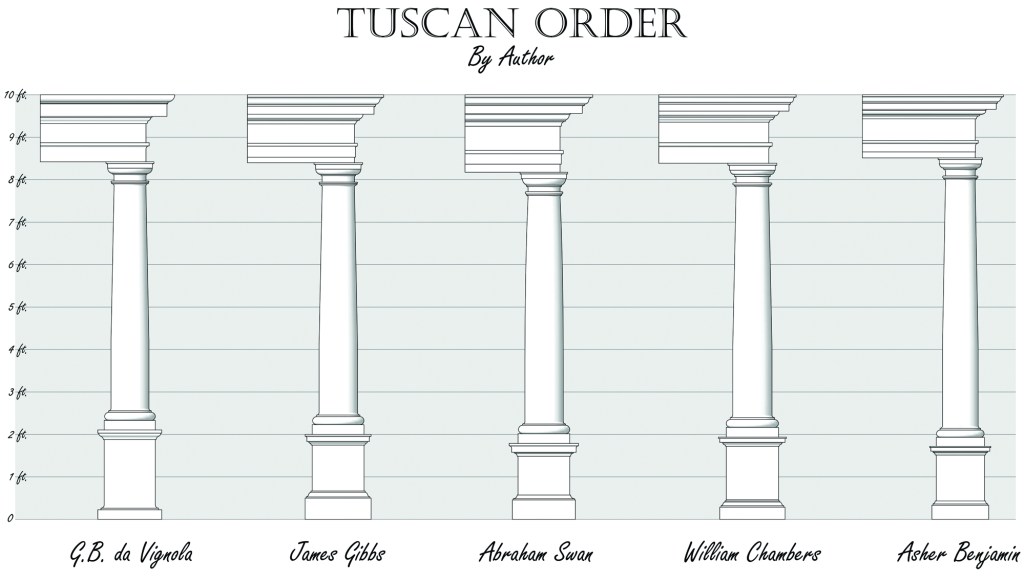

Four architectural authors—G.B. da Vignola, Abraham Swan, William Chambers, and Asher Benjamin— each produced a slightly different interpretation of the proportions in the Tuscan Order.
Todd Murdoch Four architectural authors—G.B. da Vignola, Abraham Swan, William Chambers, and Asher Benjamin— each produced a slightly different interpretation of the proportions in the Tuscan Order.
These rules have been interpreted in different ways by different authors over time, and the results are still remarkably similar. In most cases, the top of the wainscot and the height of the chair rail is much lower than the back of a typical chair. To find out why, let’s first take a quick look at how the classical orders came about. These orders are loosely based on the human form. I underscore the term “loosely” because there is no perfect human form—there are tall people and short people, people with long legs and people with stubby legs, heavy-set folks and folks that are skinny. So you can’t simply measure someone’s foot at random and say that it would represent the perfect diameter of a column. Yet starting with Vitruvius (who published the earliest known book on architecture, more than two millennia ago), many writers have offered their own take on the rules of proportion based on the classical orders.
CLASSICAL INTERPRETATIONS
All of the classical orders are important in architecture, but let’s use the Tuscan order as an example because it is the simplest and least adorned of the group. In the illustration on the previous page, we see how four major architectural authors—Giacomo Barozzi da Vignola, Abraham Swan, William Chambers, and Asher Benjamin—interpreted the rules of proportion and design for the Tuscan order. Some authors stipulate that the pedestal, or dado, should be one-fifth the height of the order (or room), while others say that the pedestal should be one-third the height of the column. In this group, da Vignola’s pedestal is the tallest and Swan’s pedestal is the shortest. But because Swan’s entablature is also the lowest, his column is proportionately similar to da Vignola’s. Asher Benjamin borrows Swan’s pedestal design and then creates his own unique entablature.

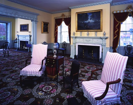

In a classic historic home, the wainscot, or dado, is at the same level as the window sill, for a continuous line around the room.
Gary Katz In a classic historic home, the wainscot, or dado, is at the same level as the window sill, for a continuous line around the room.
One truly wonderful thing about the pragmatic Mr. Swan was his recognition that dado height also determines the height of the window sills (or vice versa). In the 18th century, chair rail was actually window stool. As builders of Georgian homes attempted to follow the rules of classical design, they placed window sills or stools at the same height as the dado, resulting in one continuous line of molding around the room defining the top of the pedestal and the bottom of the window.
In most colonial homes, including neoclassical designs from the Georgian and Federal periods, the wainscot cap and window sills share the same profile and height, again creating one continuous line at pedestal height around an entire floor. In the photo, taken at the Gardner-Pingree home, in Salem, Mass., the two parlors share the same stool and wainscot cap, creating a single line that visually connects the two spaces.

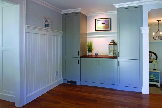

Of course, Swan’s clear-cut answer typically does not solve the problem of wainscot height in contemporary homes, which are notorious for confused interruptions in every elevation. We have all visited homes where the tops of doors and windows aren’t even in one straight level line, often with an inch or more difference in the window and door heights. I rarely see a contemporary home where the windows share the same sill height throughout an entire floor or even in a single room, and in most homes built these days, the wainscot is higher than the window sills.
Tall paneling is not considered to be wainscot, but rather wall paneling with a plate rail on top.
Roe Osborn Tall paneling is not considered to be wainscot, but rather wall paneling with a plate rail on top.
This situation presents a variety of design and molding installation complications for finish carpenters, such as how to resolve the chair rail directly into the window casing. Finish carpenters’ lives could be a lot less difficult if they just adopted the classical rule of keeping the sills and the wainscot at the same height.
And what about all that so-called “wainscot” we see in contemporary houses that is 4, 5, and even 6 feet from the floor, and the “chair rail” that caps that detail? Actually, that wall treatment is not a dado or wainscot at all. That detail is known as wall paneling and is often capped by a plate rail—which is traditionally a flat, narrow piece of trim with a groove cut into it for displaying plates. In some Arts & Crafts homes, corbels or modillion blocks support that rail. But Swan’s visual rules still apply here: If you run the wall paneling high, the ceiling will seem lower than it is, an effect that can be purposeful.
