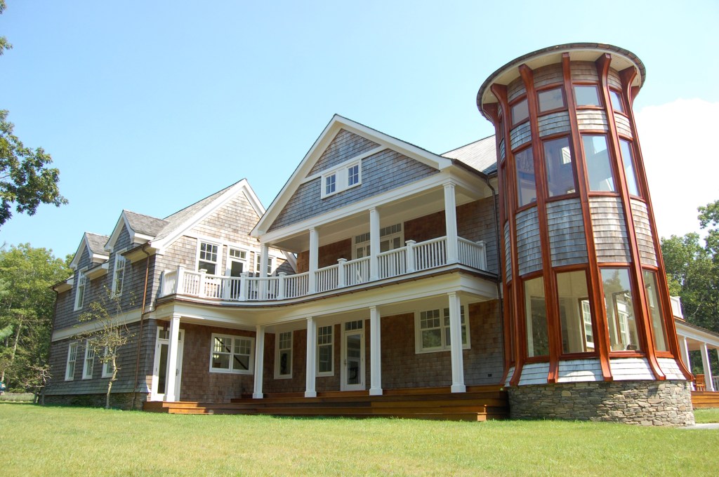

This two-story tower is attached to a Shingle-style Long Island, N.Y., beach house. It was framed with 12 columns tilted inward at roughly a 3-degree angle.
One of the more interesting trim jobs I’ve done was on a two-story tower attached to a Shingle-style beach house on the eastern end of Long Island, N.Y. I came on the job after the tower had been framed. It wasn’t a perfect cylinder, like a grain silo, but had a conical shape. The frame had 12 glulam columns laid out in a spoke pattern and tilted inward at roughly 3 degrees. Between the columns were curved wall panels interspersed with trapezoid windows that were wider at the base than at the head.

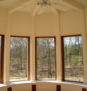

The first-floor breakfast room was trimmed with curved paint-grade paneling. The plywood fit into a
rabbet formed between the laminations in the stiles and rails.
The first-floor breakfast room was trimmed with curved paint-grade paneling. The plywood fit into a rabbet formed between the laminations in the stiles and rails.

Because the tower walls tilted inward, I had to measure the room diameter at each “level”—that is, at the floor; at the sill height and head height for the main windows; at the sill height and head height for the transom windows; and at the very top of the paneling where it joined the base of the domed ceiling. At each of these levels, the diameter grows increasing smaller, but because the change is gradual, we did not have to change the radius of all top and bottom rails for each panel section. The larger, upper finish panels are actually trapezoid in elevation, like the windows. But the smaller panels below the windows were left square. Over 18 inches, the difference in the panel width is less than 1/16 inch.

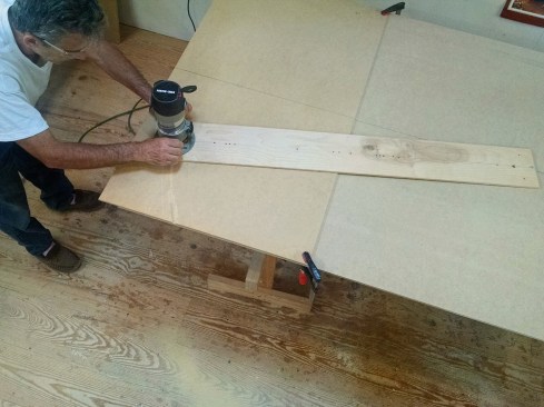

With flat trim work, you can often jump right in, but with curved millwork, you need to take time to make accurate patterns first. I use 3/8-inch MDF for my pattern stock. I cut the MDF with a shop-made trammel jig attached to a router fitted with a 1/4-inch straight cutter. A CNC machine, if you have access to one, is even faster and more precise. There are companies that will make up a series of templates in a matter of minutes. Once you have all the correct patterns, then you can lay up the blanks, flush-trim them, and make any molding detail with a ball-bearing guide on the shaper.

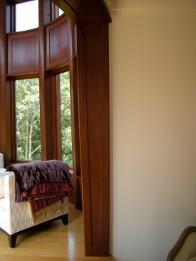

Column covers. The 12 column covers were made from three pieces of solid mahogany and a back plate (see again photo). The front piece was milled before assembly with a custom-made knife for a Williams & Hussey molder. The sides and back plate were ripped at 15 degrees. This allowed each window sill to be cut at 90 degrees on site and fitted to each bay.

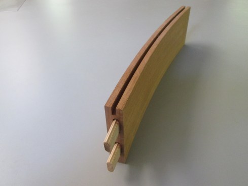

Each curved rail is formed from five laminations. The center lamination is ripped slightly narrower than the
others to create a rabbet to receive 1/4-inch plywood.
Each curved rail is formed from five laminations. The center lamination is ripped slightly narrower than the others to create a rabbet to receive 1/4-inch plywood.

To create a curved form, the author uses a trammel jig for his router to cut MDF at the radius of each rail.

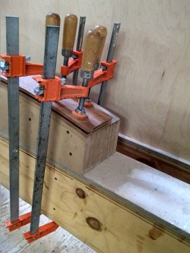

To form the rails, I use 3/4-inch MDF to make clamping forms to match the finish radius, screwing multiple laminations together into a stack. The best way is to use both an inside and an outside radius, squeezing the rail between the two forms. This allows you to use fewer clamps and get even pressure. But a single outside radius form with multiple clamps works, too.
The laminations can be bent around an MDF form and clamped into place ...
The laminations can be bent around an MDF form and clamped into place …

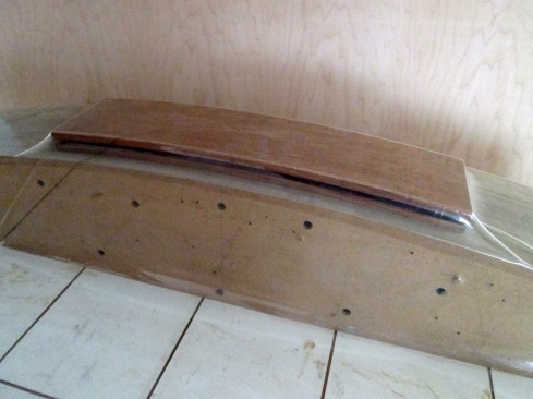

... The best way to create a smooth curve is to glue up the lamination in a vacuum press.
… The best way to create a smooth curve is to glue up the lamination in a vacuum press.
Another method is to use a vacuum bag to press the blanks. Vacuum pressure is absolutely even and produces a truly fair curve. (Clamps can leave slight undulations in the rail that can sometimes be visible in flat light.)
A bent lamination’s radius is retained by the glue line; overnight cure is critical. There are rigid-set glues (like resorcinol) available that are traditionally favored by boat builders for curved laminations, but Titebond 3 will work fine for a large radius. Because the glue is slightly flexible, there will be some “spring back”—about 3/8 inch on each end for the radii on this project. When it’s critical to hit an exact radius, do a test run and adjust your mold as necessary.
The center strip in the lamination is exactly the thickness of the 1/4-inch birch plywood—a bit thinner than the back and front strips. After overnight clamping, this center lamination in the curved rail creates a perfect panel rabbet. I think everyone reading this can appreciate how difficult and painstakingly slow it would be to manually cut a rabbet into a curved rail instead of forming it.
