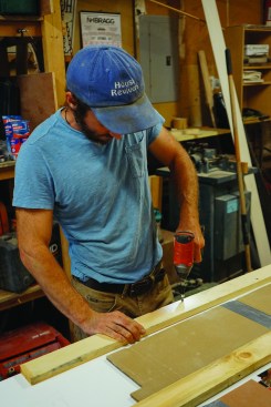

Unlike wood, a cast concrete sill can’t easily be sanded or planed, so it has to be built with precision. A good template taken from each rough opening is critical. I use thick cardboard, such as an appliance box, and I use a very sharp box cutter to fit the cardboard to the rough sill. I keep working the piece until it fits just right.
The author uses a cardboard template made at the jobsite to guide his placement of 1x4 forms.
The author uses a cardboard template made at the jobsite to guide his placement of 1×4 forms.

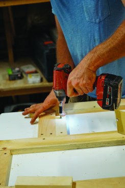

He screws down the wood to the melamine surface of his worktable.

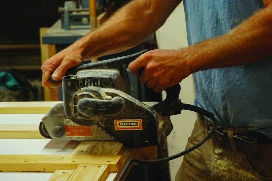

Where necessary, he sands the wood with a belt sander to even up any inconsistencies in the thickness of the lumber.

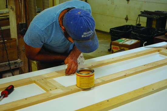

The author coats the edges of his wood form strips with paste wax.

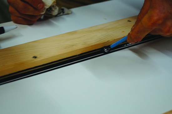

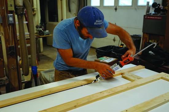

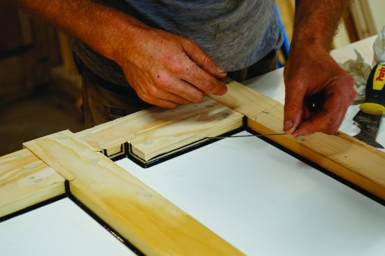

Then he applies a generous bead of black silicone caulk where the edge forms meet the worktable.
Tooling the caulk with a stainless steel ball used by cake decorators creates a consistent, smooth eased edge on what will be the upper face of the windowsill.
Fasten the melamine down to your assembly table and lay out your templates. Carefully transfer the templates with a pencil, or just build around them. (By the way, don’t forget that since we’re casting face-down, the top side of the template has to face down and touch the melamine.) For anything thicker than 3/4 inch (such as a typical countertop), I rip strips of melamine and use a Kreg jig and pocket screws to set the strips on edge alongside my templates. I add mini strongbacks along the perimeter to prevent bowing. For these 3/4-inch-thick windowsills, however, I just screwed down 1×4 pine, remembering to fill my screw holes with plumber’s putty for easy removal.
Excess caulk peels away nicely.
At this point, I caulk the corners of the form to give a nice relief to the visible, touchable edge of the finished product. I like to use black 100% silicone because I can see its shape better than white or clear caulking. For a crisp bevel, I tool the caulk bead with a tooling ball (I bought mine from Buddy Rhodes, but it’s actually a baker’s tool). I wipe paste wax around the perimeter, so the excess caulk will release. After the caulk cures, the waste peels up, leaving a perfect radius that will form your sill’s eased edge.

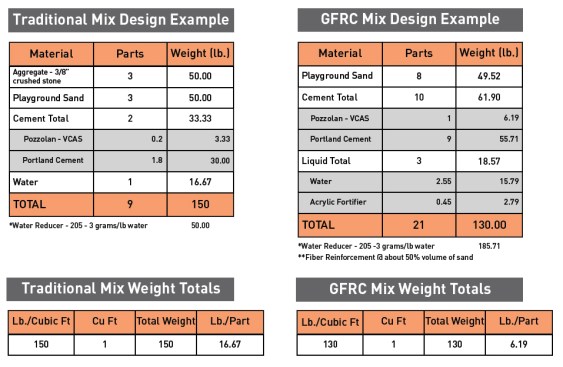

Shown above are the ingredient proportions for the author’s traditional mix for heavy components such as countertops (left),  which requires steel reinforcing ladder wire, and for his glass-fiber reinforced mix (right), which uses fiberglass filaments  instead of steel and is suitable for very thin castings. Working from the ratios in his formulas, the author breaks the total  quantities into small batch sizes for easy mixing. The table shows a sample calculation of the ingredient ratios for 1 cubic foot  of each type of mix. If your project requires more than one cubic foot of concrete, the same ratios can be applied to much larger  batches by simply changing the overall volume, which carries through in the calculations to result in a revised total weight and  weight per part. The author has put all of this into an Excel spreadsheet for quick recalculation from one job to the next.

There are two basic mix designs: “traditional” and glass-fiber reinforced concrete (see tables, above). My traditional formula is pretty much like any ordinary concrete mix: It’s mostly coarse playground sand, small coarse aggregate, Portland cement, and water. But it also has some important admixtures. I add a pozzolan called VCAS (vitrominerals.com), as well as a superplasticizing water reducer that increases the fluidity of the wet mix while limiting the amount of water, thus improving cure strength while maintaining workability. For colored concrete, I add a small amount of dye.

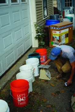

The author weighs out his ingredients using 5-gallon buckets.

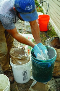

He pre-mixes the cement and dry admixtures.
Without reinforcement, this traditional mix would be prone to cracking, so I add a layer of ladder wire for reinforcement (or, if the piece is thick enough, two layers of wire). I use this traditional mix for anything thicker than 1 1/4 inches. Anything much thinner than that just isn’t thick enough for me to be sure it won’t crack.

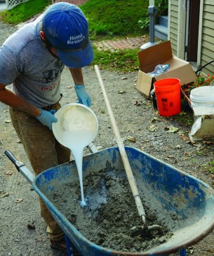

Then he places them in the wheelbarrow in small batch amounts, and adds pre-mixed water and acrylic fortifier until the material is well wetted.

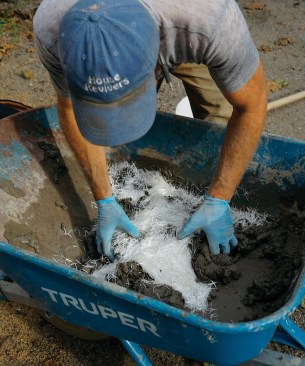

He adds a water-reducing admixture to make the mix more workable, then mixes in fiberglass reinforcing filaments.
Glass fiber reinforced concrete (GFRC), the variety I used for these windowsills, is a whole different animal. The aggregate is omitted, in favor of higher cement and sand proportions. Acrylic fortifier is added to the water to improve bond strength. But most notably, the ladder wire is replaced by thousands of alkali-resistant fiberglass filaments. These are mixed right in. So rather then crumble, the concrete behaves more like wood, with lots of overlapping fibers. This leads to impressive flexural strength. I’ve gone as thin as 1/2 inch with GFRC, and I wouldn’t be surprised if it could be pushed further. The sills shown here were fabricated at 3/4 inch thick.

Particularly if I’m pouring alone, I make sure to measure out all the proportions I need beforehand. I use 5-gallon buckets and a good scale to weigh out each of the ingredients into smaller, manageable “batch” proportions that I can mix up by hand in a wheelbarrow. For bulky materials like sand and cement, I measure my weight once, and then mark the level on the inside of a bucket with a crayon marker. That way I don’t need to weigh every time.
Like a baker, I measure my dry ingredients first. For GFRC, that’s VCAS, cement, and sand. Then I start adding water and fortifier. This mix is thirsty; it will suck up a lot of water. Be patient, and don’t add too much. Once the batch is well “wetted,” the trick is to add some water reducer a little at a time and watch for the alchemy—all of a sudden, your mix will get significantly more fluid. Then add the rest of your water, until the batch has a thick, stiff pudding consistency. Finally, sprinkle in and incorporate the fiberglass a bit at a time, making sure you don’t have any mats or clumps.

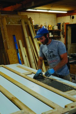

Now you’re ready to add the concrete to your forms. I scoop the material into the forms with my hands, working in layers rather than sections. Make sure to work it into the corners; otherwise, you’ll end up with more air holes on your corners, because air has the hardest time escaping from those areas.

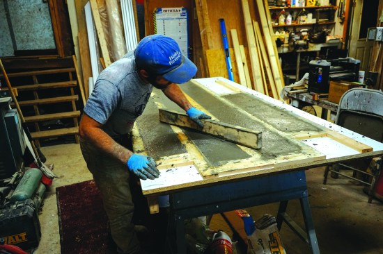

He strikes the material off with a 2x4 screed.
He strikes the material off with a 2×4 screed.

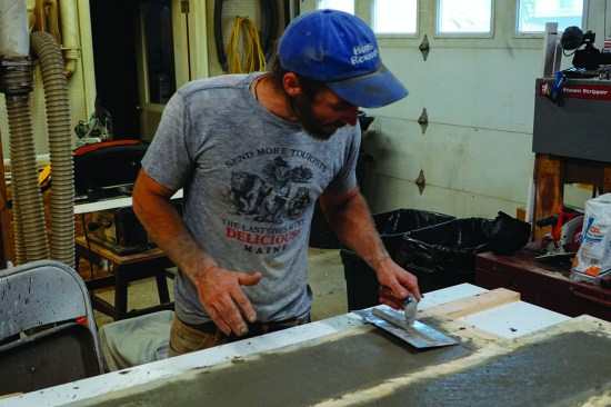

After allowing the concrete to set under a tarp for a few hours, he trowels the surface, then covers the sills again to let them cure.

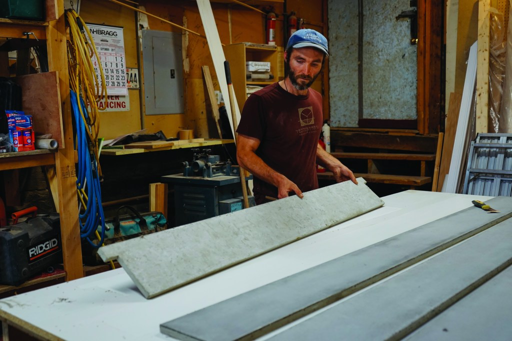

After a few days, he strips the forms and finishes the surface, starting by rubbing off rough spots with a grinding disk.
Once the forms are filled, take a screed (I use a straight chunk of 2×4) and ride it along the top of your forms, using sort of a walking and sawing motion. Hold the screed at an angle—I’ve found that if I hold the screed square to the forms, it tends to pull glass fibers out for some reason. I make sure to reserve some excess concrete to add to low points; you want to see the screed push out concrete the whole way.
Cover your form tables with a tarp and a blanket for a couple of hours, to hold in heat and moisture and help the concrete cure. Timing is key here—the concrete needs to be wet enough so that you can still manipulate it, but set hard enough so the back doesn’t slice up or “pull.” When you can barely make a mark on the surface with a finger, it’s time to trowel the backs, removing any junk along the edges and making sure it’s fairly smooth—this will help your windowsills slide easily into place and sit nice and flat. Then cover everything up again and wait for the cure to finish. I usually give sills at least two days in the forms, and more time doesn’t hurt.

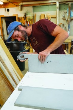

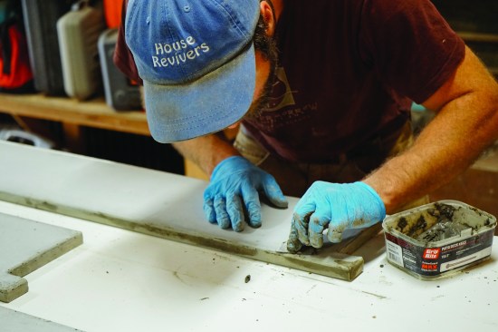

In a few days, you can strip forms and do some finishing. I ease the bottom edge of the sill with an old grinding wheel (by hand, not in a grinder), so it’s smooth to the touch. Fill any pinholes with a paste mix of cement, VCAS, and acrylic fortifier (I work the paste in with my fingers, sometimes with the help of a razor blade used trowel-fashion). Give it a few days to cure, if you can, before you apply the paste; otherwise, I have found that the surrounding concrete will steal moisture from the paste, so that the patches don’t adhere as well. (Another option that works is to seal the concrete before you fill the pinholes and voids.)
The author fills pinholes using a paste of cement, pozzolan, and acrylic fortifier.

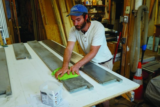

When you’re happy with the surface, it’s time to seal the sills to prevent staining and degradation. I allow at least a week of curing time before doing this; otherwise, coating adhesion is poor because the concrete is still releasing moisture.
I’ve tried the whole spectrum of sealer choices and hadn’t found the right one until recently. There are drawbacks to most options: Epoxy sealers can look wet and artificial; acrylic sealers are prone to hazing and streaking; and waxes (such as Feed-N-Wax, for example) give a great finish but need maintenance and don’t actually seal anything. Recently, however, I started using ICT PS1 Reactive Sealer from Buddy Rhodes Concrete, a hybrid between penetrating and micro-coating systems. This coating provides excellent protection without sacrificing the look or feel of concrete. The Buddy Rhodes website provides good instructions, and the sealer is easy to apply without drips or runs. If time allows, let the sealer really harden up before you manhandle the sills into place.

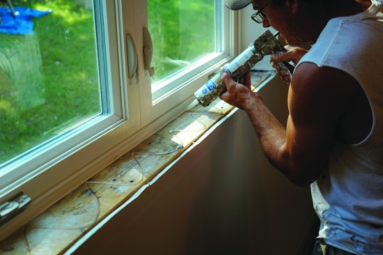

On site, the installers apply a setting bed of silicone caulk to the rough framing.

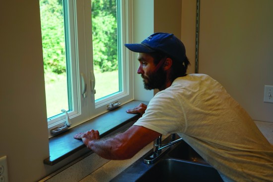

When it’s time to install, begin by dry-fitting all your sills. When the fit looks good, we run a few beads of silicone on the rough opening, set the concrete sill down, and then slide it into place. When all your sills are in, you may need to apply some drywall compound and caulking to the wall for a clean joint.
