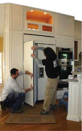

We prefer to build entire runs of cabinets as a unit, which allows us to get rid of double partitions and to maintain an equal reveal between every door and drawer, top to bottom and side to side. Also, building cabinets to fit a specific space gets rid of scribe strips, bolt-on end panels, and various gap moldings — all of which make the cabinets look blocky and take up space that could have been used for storage.

Finished ends. I build finished end panels to match the door style or as a beadboard frame-and-panel. Either way, I attach the panel to the face frame so that the cabinet looks like one seamless, integrated unit. This is particularly important for freestanding island cabinets, which need to look good from every angle.
My base cabinets don’t have integrated toekicks. Instead, I rip 33/4-inch plywood strips in the shop and build separate “ladders” on site. I set these on the floor first, shim or scribe them level, secure them with screws, then attach the cabinets on top. This simple approach works just as well for island cabinets — and the reduced cabinet height makes it more likely that we’ll be able to get the units through the kitchen door.
