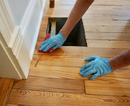

Getting It on the Floor
Before I get to the application process, two quick points:

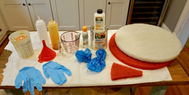

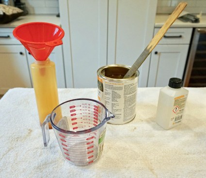

1. With few exceptions, all the oils come with a chemical hardener that you mix into the oil before starting the application. This expedites drying and curing and enhances the chemical resistance to liquids the oils will likely come into contact with over time.

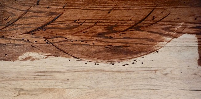

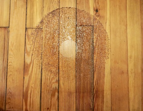

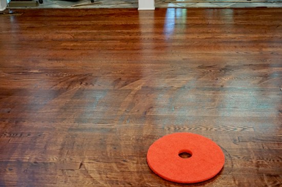

2. To maximize the amount of oil absorbed, it helps to wet the wood to pop open the grain before applying the oil. When the floor has dried, the surface will absorb the oil more evenly. Every contractor I talked to did this, especially if they were using a stain with color. Water is the great equalizer and helps create a uniform look.

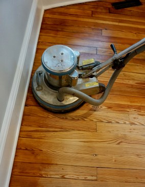

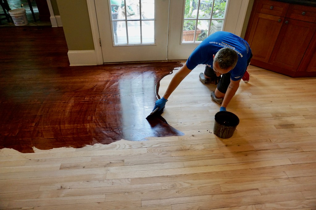

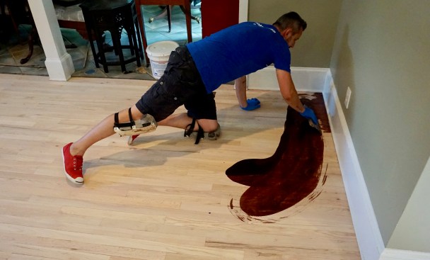

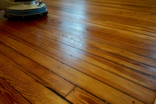

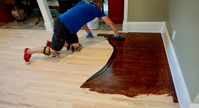

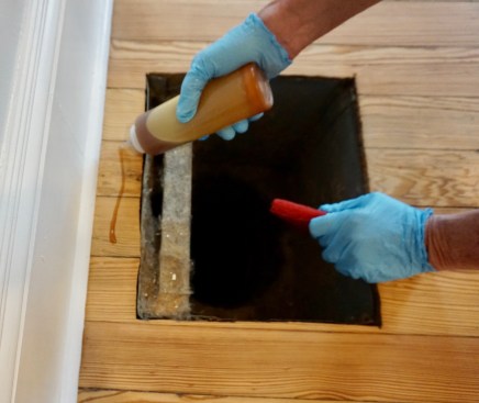

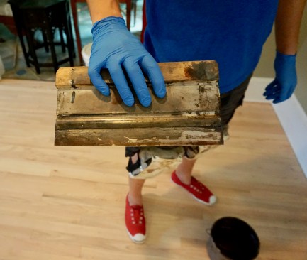

The three primary methods of getting the oil on the floor are troweling, rolling, and buffing. All of these methods physically force the oil down into the wood tissue. If you’re good with a trowel, you can cut in and do detail work with its blade. If you’re rolling the oil on or buffing it in, you will likely cut in using a small brush or a slice of a red buffing pad to rub the oil in. Most contractors agree it’s wiser to work in manageable sections as opposed to taking on a whole room at once. The size that’s manageable will depend on your level of experience, so be deliberate when you start. After applying the oil with the trowel or roller, let the oil sit on the floor and dwell for about 10 to 15 minutes, and let gravity do its thing.

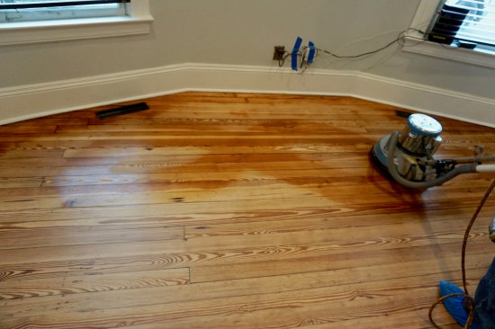

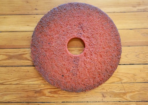

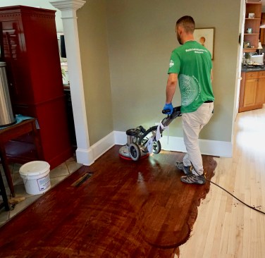

After the dwell time, use the buffer and the red pad to methodically buff the surface. I recommend buffing in patterns going against the grain and with the grain. This does two things: It forces more oil into the wood, and the red pad starts to pick up the excess. As the floor reaches its saturation point, the excess is thrown off the pad in small droplets, called spitting. As the spitting is minimized, what little oil is left is removed with a white polishing pad or a terry cloth–type rag. At this point, you will notice a dramatic reduction in the amount of oil your shoes track, as the majority of the residue has been removed. I strongly encourage wearing mesh booties to reduce tracking even more and keep your shoes cleaner.

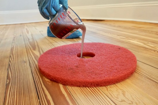

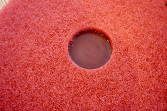

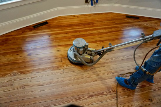

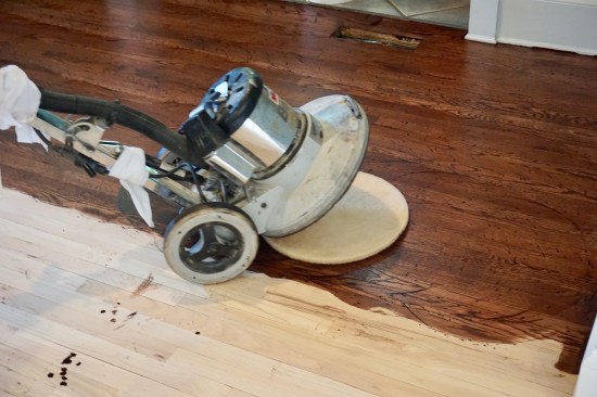

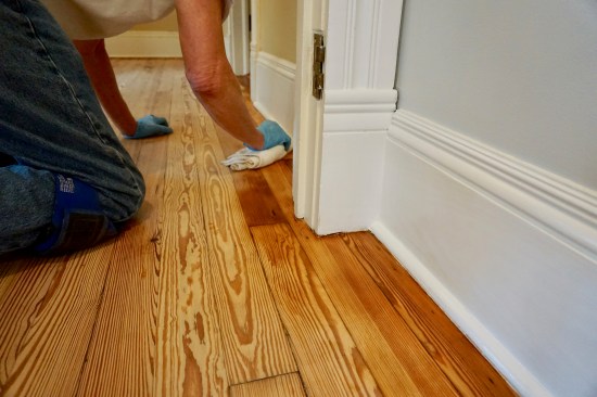

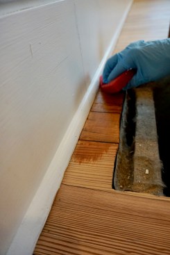

I prefer the third method of getting oil on the floor: buffing the oil into the wood. Prior to buffing, we cut in around the perimeter by using a brush or making small deposits of oil with a squeeze container and then rubbing it in with portions of a red pad. This keeps oil off the trim and makes for a cleaner application.

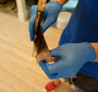

When we’re ready to buff the oil, we start by removing the center section of the red pad, creating a 3-inch hole to pour the desired amount of oil into. I put a drive pad on top of the red pad on the buffer and hit the switch. To get maximum coverage, I typically move the buffer quickly and in patterns that look like the number 8. Once the oil is deposited in the pattern, I work the oil into the wood by buffing against the direction the floor is laid. As I spread the oil, I gradually work my way to the perimeter of the room where we had cut the oil in, and blend the two areas. Once I’m confident I have sufficient oil on the floor, I buff in any direction I want.
Since the biggest risk to this method is not getting sufficient oil on the floor, I monitor the amount of spitting coming off the red pad to determine if the oil is being absorbed or the wood is reaching saturation. I also look for any color variations in the wood, as those indicate areas that haven’t absorbed enough oil. If I feel I need more oil in an area, I make light applications.

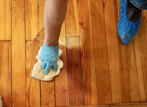

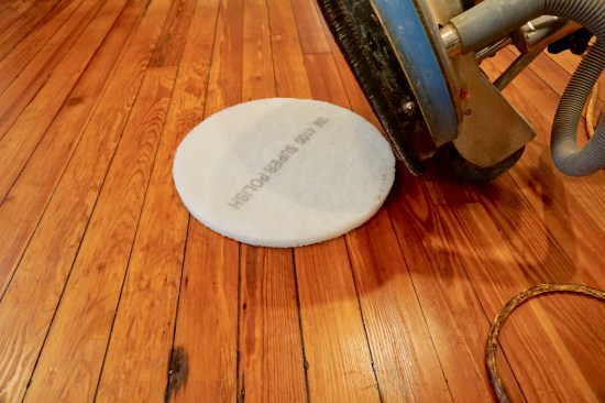

Once the majority of the excess has been removed with the red pad, the final buffing is done with a white polishing pad, a terry-cloth towel, or both. What you are doing now is making sure the oil has been applied and removed uniformly as the oil enters the drying/curing phase. Always back your way off a freshly oiled floor to ensure any shoe tracks are removed with the buffing pad.
The application processes are logical and easy for a seasoned operator. You do have to pay attention to the amount of pull on the red buffing pad, as it accumulates oil while the work progresses. The buffing creates friction and that means heat. Combine that with the hardener and it won’t take long for you to notice more drag as the heated oil is well into the drying phase. This makes the buffer more difficult to control, as it will grab at the surface, and eventually you will have to flip the pad over to the clean side or replace it. Pay particular attention to the circular residue left from a saturated pad when you lift it off the floor. I encourage you to quickly wipe it up with a terry-cloth rag. He who hesitates will think he’s wiping up Super Glue.

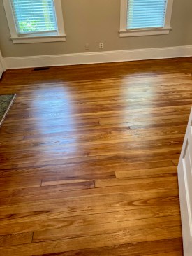

When you finish with the white pad, rely on the manufacturer’s suggestions and product specifications for what comes next. For some products, that’s it, you’re done. For others, you have the option to make another, much lighter application. Others will tell you that if you want to make another application, wait a day and make it a light application. If the initial application was done correctly, the wood should already be pretty much saturated. The most you would be doing with a second application would be to get oil in what I call the grain relief pattern. It won’t be much, but if you want to do it, you can. I typically use a plastic condiment squeeze bottle for getting the additional oil on the floor, as I don’t need much.
Drying and curing times vary, especially if the oil has color. Pay close attention to what the manufacturer requires and make sure the client does too.
It sounds easy, and it is for someone with experience. Take a second and breathe in the air that is remarkably clean and devoid of noxious solvent vapors. These are some of the most environmentally responsible finishes you’ll ever work with, and for me, they have been a joy to use.

The first crew (two workers) will be using the more expensive, one-coat application of colored oil at $200 per liter. After mixing the hardener in the oil finish with color, the crew starts the application at 9 a.m. They will go through roughly three liters of finish in about four hours for a total cost of $600 for the finish and the cost of the crew for a bit more than half the day. They should be through with the application and gone by 2 p.m. at the latest.

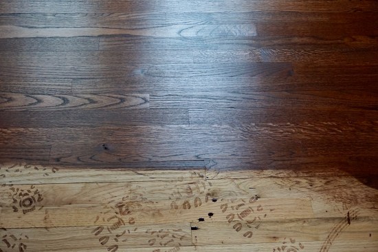

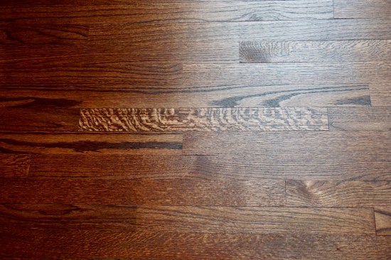

Appearance. Coatings are more decorative than hardening oils. Coatings can range from a flat matte to a high gloss. Lower-luster finishes, satin in particular, are more popular as they tend to not show wear as much. Hardening oils are low luster, period. Some manufacturers of hardening oils do offer products that will increase the luster, but I am hesitant to describe them as anything but low luster. The good news is that as consumers have gotten more accustomed to the look of hardening oil, they have become more accepting. We’re even seeing it used on some high-end prefinished and engineered flooring.
Protection. Both products do an excellent job of protecting wood. The high-tech, high-end waterborne finishes are more chemically resistant to common household liquids than ever before. Hardening oils are also protective of wood. Many of my historic preservation projects include rooms that see a lot of activity with food and beverage consumption and people celebrating in every manner. In this context, the hardening oils have done just fine.
Cleaning. Manufacturers of coatings did themselves a big favor when they started promoting a simple, straightforward cleaning kit for their finishes. They did a great job of marketing and distributing them. Hardening oil manufacturers have done the same but with slight variations. Along with cleaning products, some manufacturers offer refurbishing products to help maintain a healthy-looking floor. Do your homework and use the company’s website to drill down on this topic. I pay close attention because unless it’s simple, the homeowner will skip it.
Wear. This is where we notice big differences. Even the toughest coatings are susceptible to scratches, gouges, indents, and wear patterns. They sit on top of the wood where use and abuse can be plainly seen. It’s difficult to mitigate areas of damage or wear without doing a full-blown clean and recoat of the entire area. With hardening oils, all the protection is in the wood so there’s no film on the surface to show abrasion and wear, even though it’s still occurring. If you do get some visible damage, touch-up is relatively easy in a single location without refurbishing or refinishing a whole room. Most manufacturers have touch-up products for doing just that.
